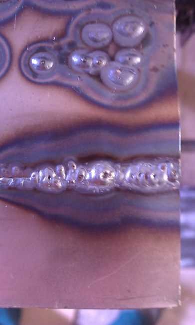

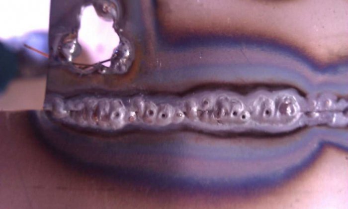

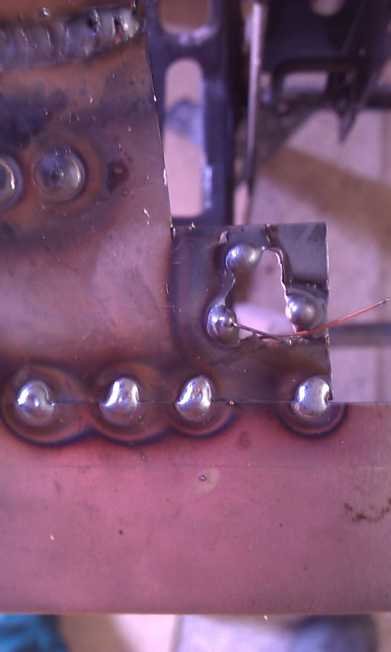

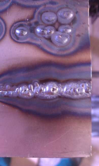

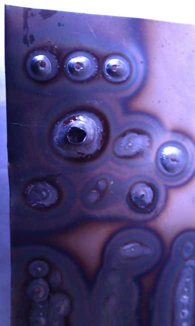

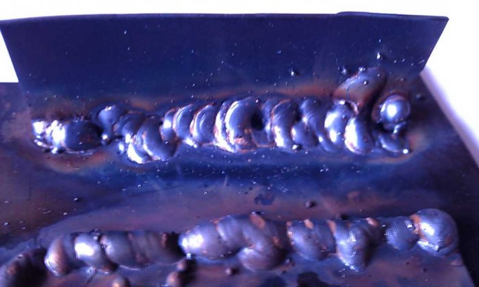

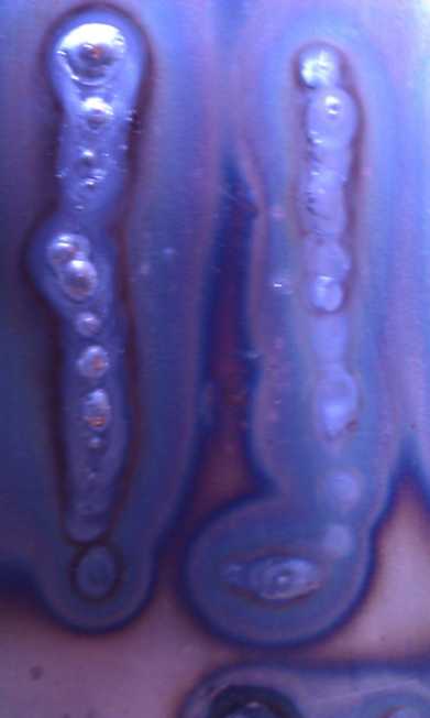

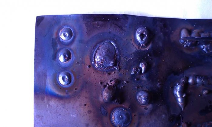

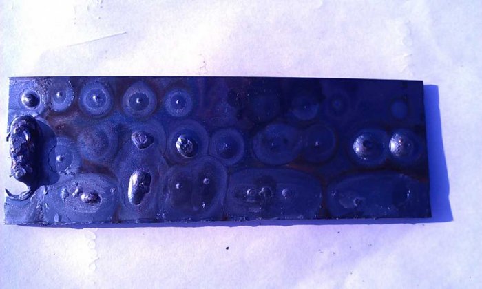

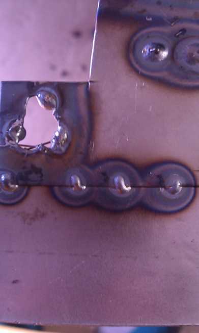

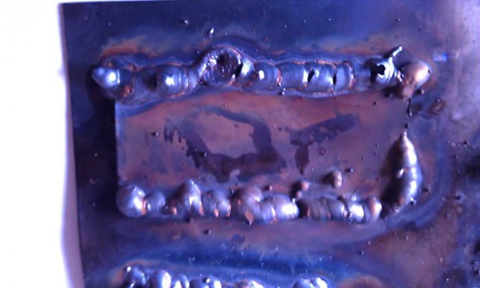

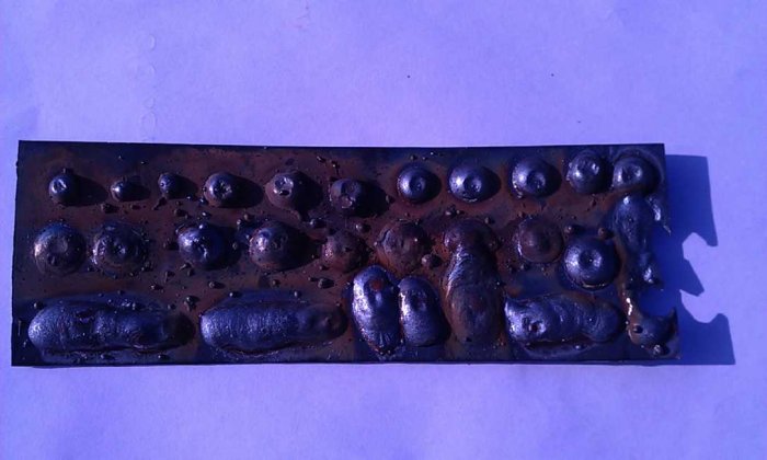

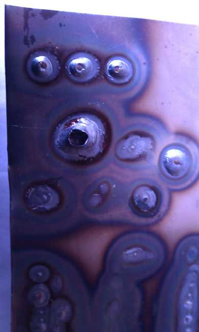

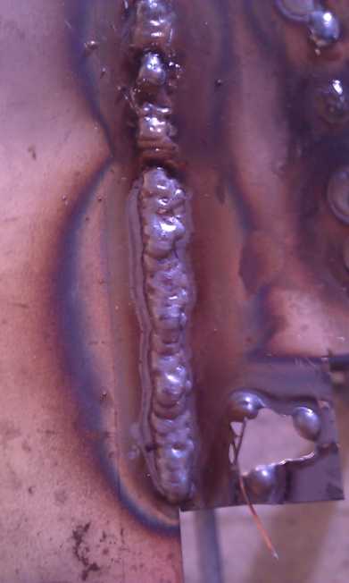

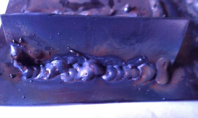

I would read it that when you change the voltage the machine will put you roughly ok for wirespeed for every voltage selected....best to experiment
...hopefully one of the members here who owns a 160 might add something .....and setup the same joint you will weld ,ie not a piece of cold steel which will act as a heatsink
....were your tests yesterday mid sheet or a joint ,you may have to drop a voltage or 2 if set mid sheet,to weld a joint without blowing holes
