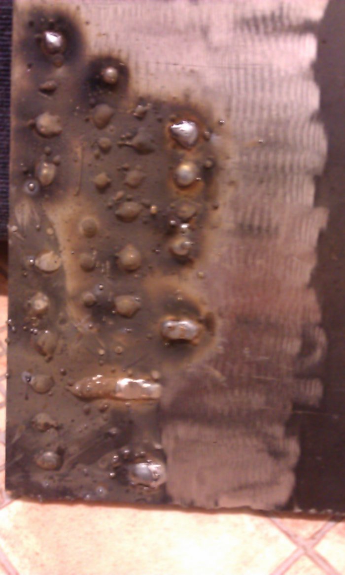

So I finally rigged up my Clarke 160EN Turbo and picked up a piece of scrap 5mm steel to do some test welds.
The plan was to get a feel for the torch and settings etc.
I am using 0.6mm wire and a 600g bottle of Clarke CO2 I also have a another bottle of I think Argon.
Attached is a picture of my first welds (not a pretty sight), the first spot welds and a couple of seem welds I did were reasonable, but I can't remember what settings?!?!? I then tried a few other higher settings but started to get a lot of soot and now all I get is real bad blobs.
The first problem I encountered was an intermittent wire feed which I solved when I found the the drum was set to the 0.8mm groove until I switched it to 0.6mm.

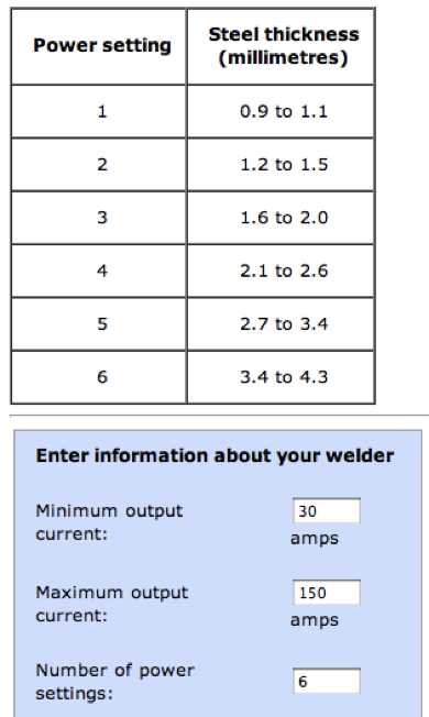

The disposable regulator can be set from 0 - 6, what should ot be set to to conserve gas but maintain a good shroud?

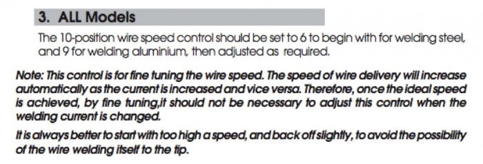

To lay down some decent welds do I need to set the welder to weld 5mm steel? Which according to what I have read is rocker switch set to MAX, rotary switch set to 3 and wire speed set to 12?? Tried that didn't like it?
Any advice would be great.
