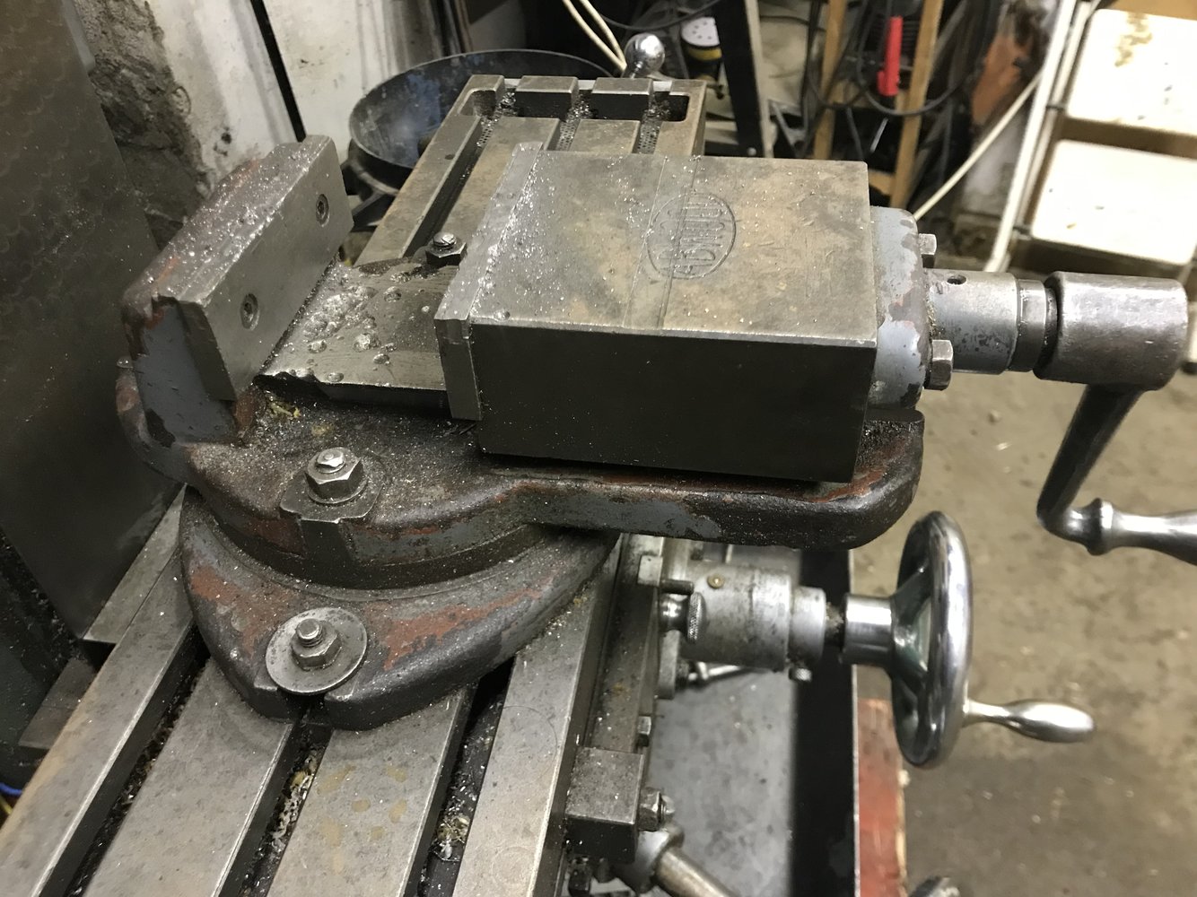

This is what I have, an Abwood:
It has quite a few issues, and is not currently a pleasure to use:
- Jaws not parallel
- Bed badly cratered
- Bed not wide enough to reliably seat the ER32 collet blocks I have.
- Jaw lift is significant, and the ways are unevenly worn so if I tighten them up, they jam in certain places. Very hard to tap down workpieces as they bounce.
- Under 3.5” opening, so I keep finding things that won’t fit in.
Suggestions welcomed.
