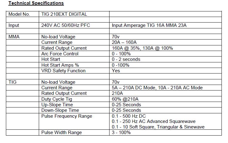

here are the specs
Hopefully not to derail the thread, but are those really any good? They seem too cheap for what they are...
