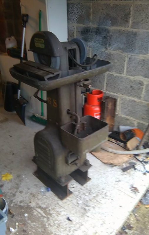

I won this on eBay last night for £25.50 and the seller offered to deliver
The listing didn't say who made it, or anything about it but for the price I thought it was worth a punt.
The motor is 3/4 HP 415 volt 3 phase but I should be able to inverterize or replace it. The shaft is driven by a belt and it has another belt (The one poking out of the hole in the top) which powers a water pump to pump water from the sump on the side over the wheels
The tables can be tilted and they have a slot for an angle rest, should be really nice for grinding lathe tools
