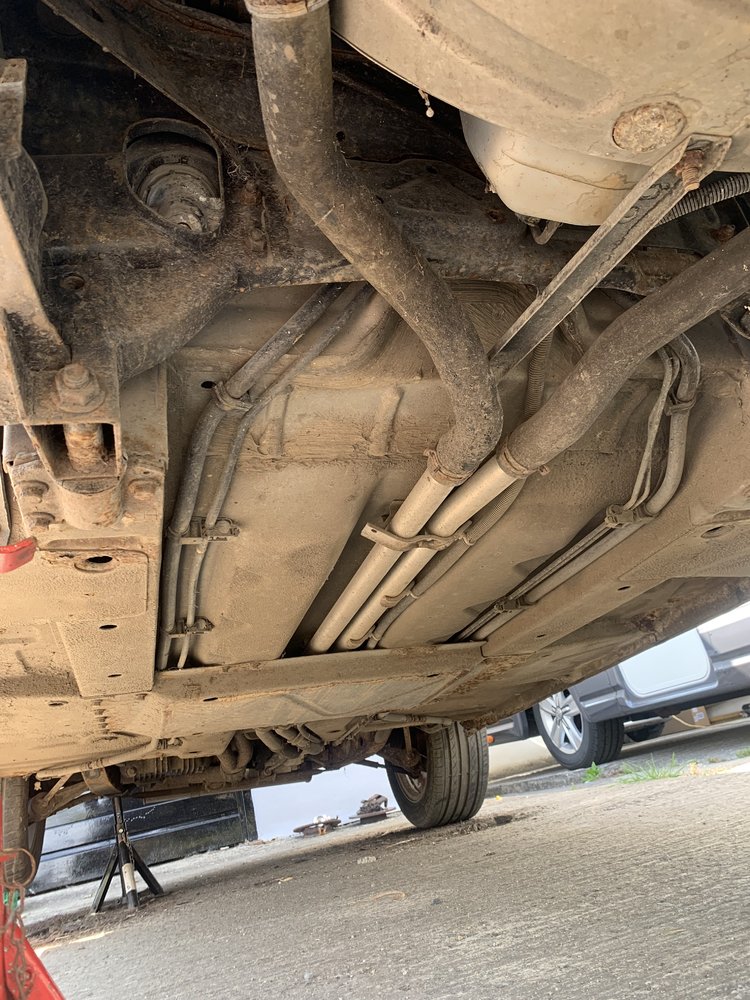

Stainless underfloor pipes are an absolute certainty, if they haven’t already been done.If you haven't got a mini impact driver get one - removing the engine bay cover is murder without one. Then get a torch and inspect the steel water pipe from the water pump - if it hasn't been changed it will be rusty, and if it was changed a long time ago it will be rusty. Then do the same on the long ones under the car. If you skip this you will skip the car....

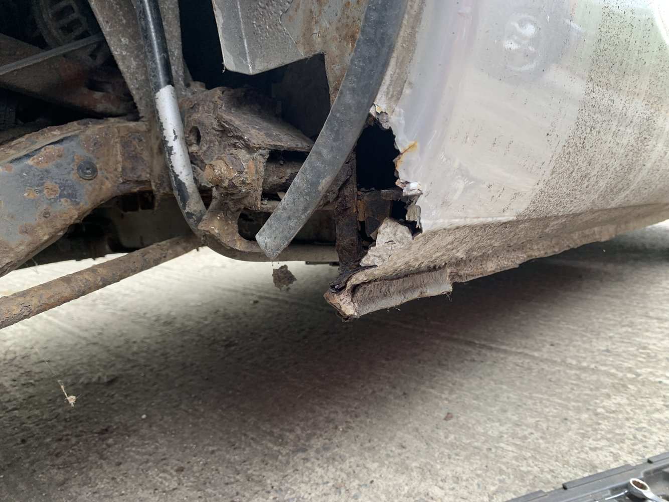

I’m still waiting for the repair panels to turn up but I’ve got plenty I can do in the meantime.Need to start another thread called "wozzaaah's wheels"
Looks like a fair match for the panel repairs Woz.
Depends how my welding turns out I may or may not post some pics, it's been a long time since I did any thin stuff.you need a welder![]()
