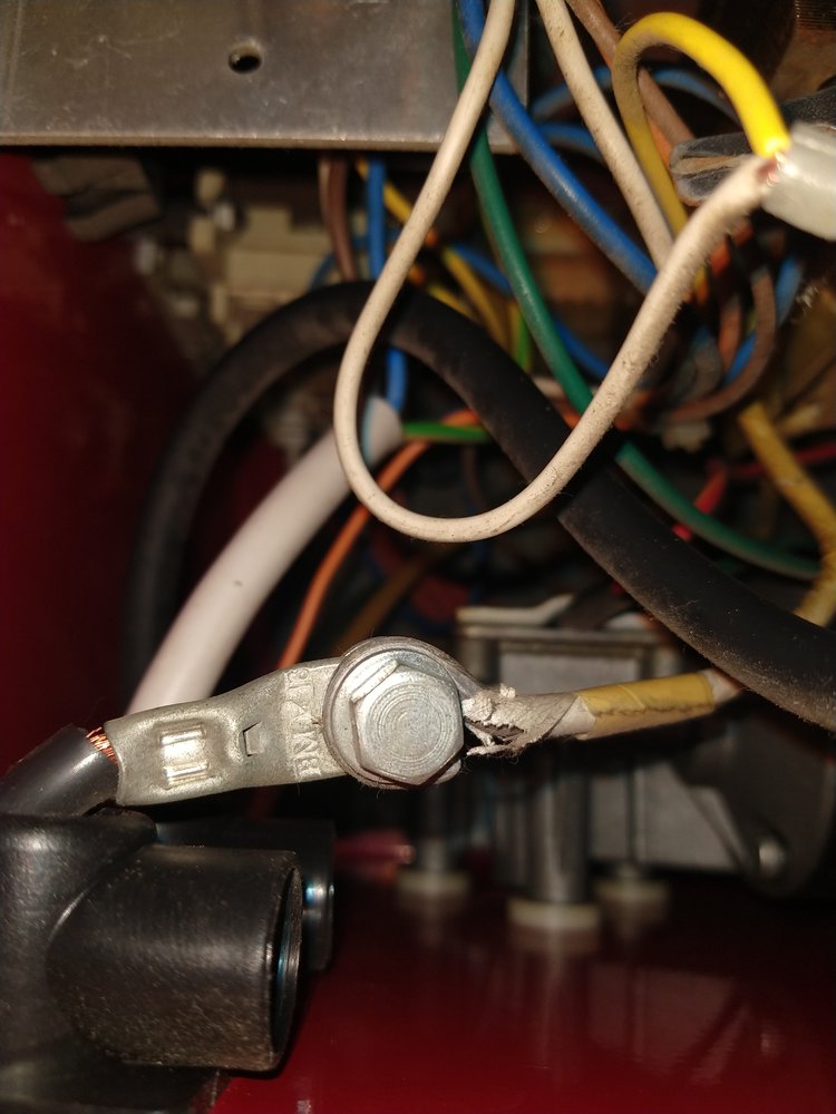

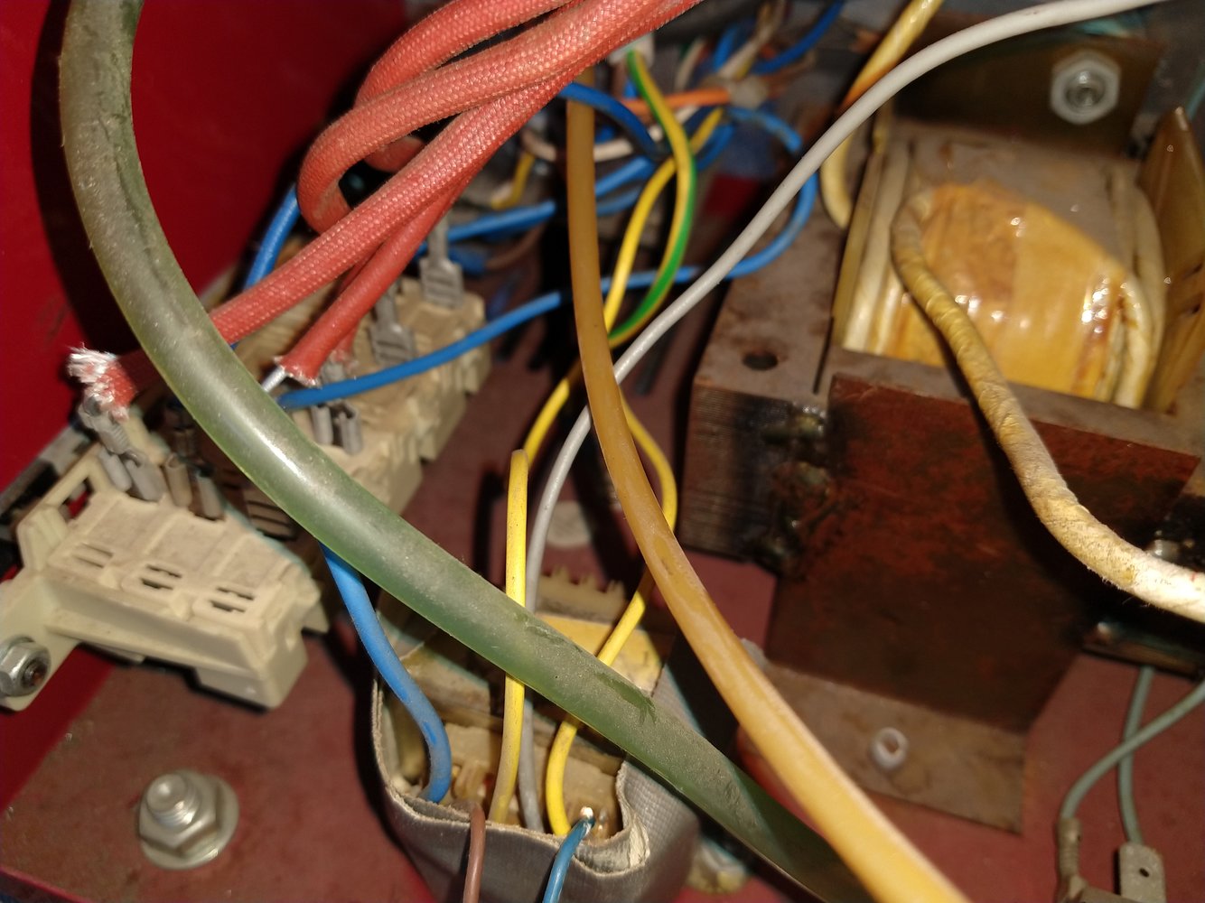

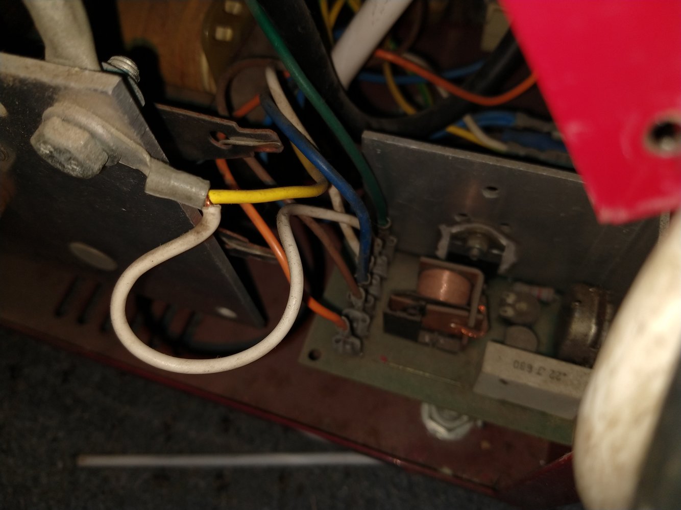

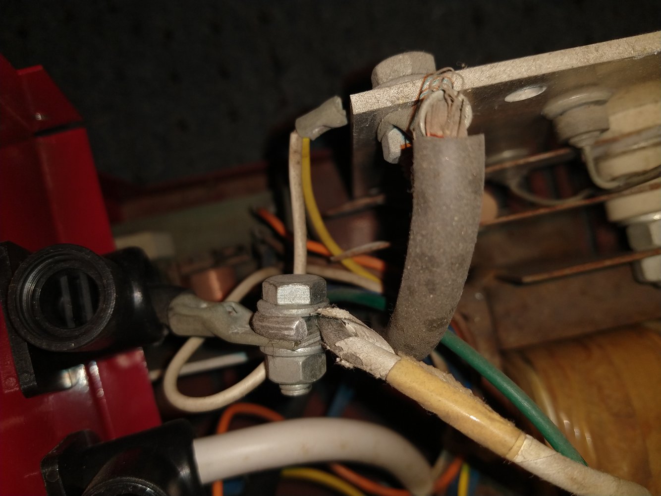

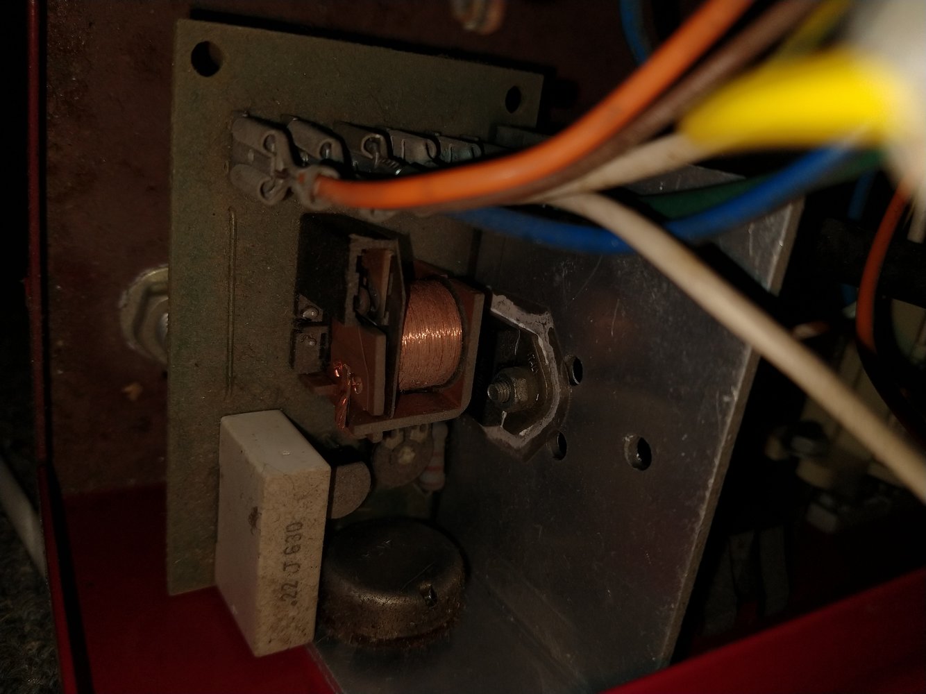

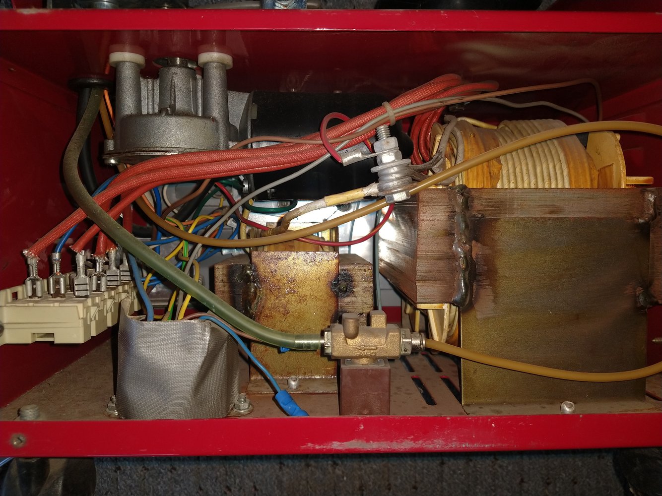

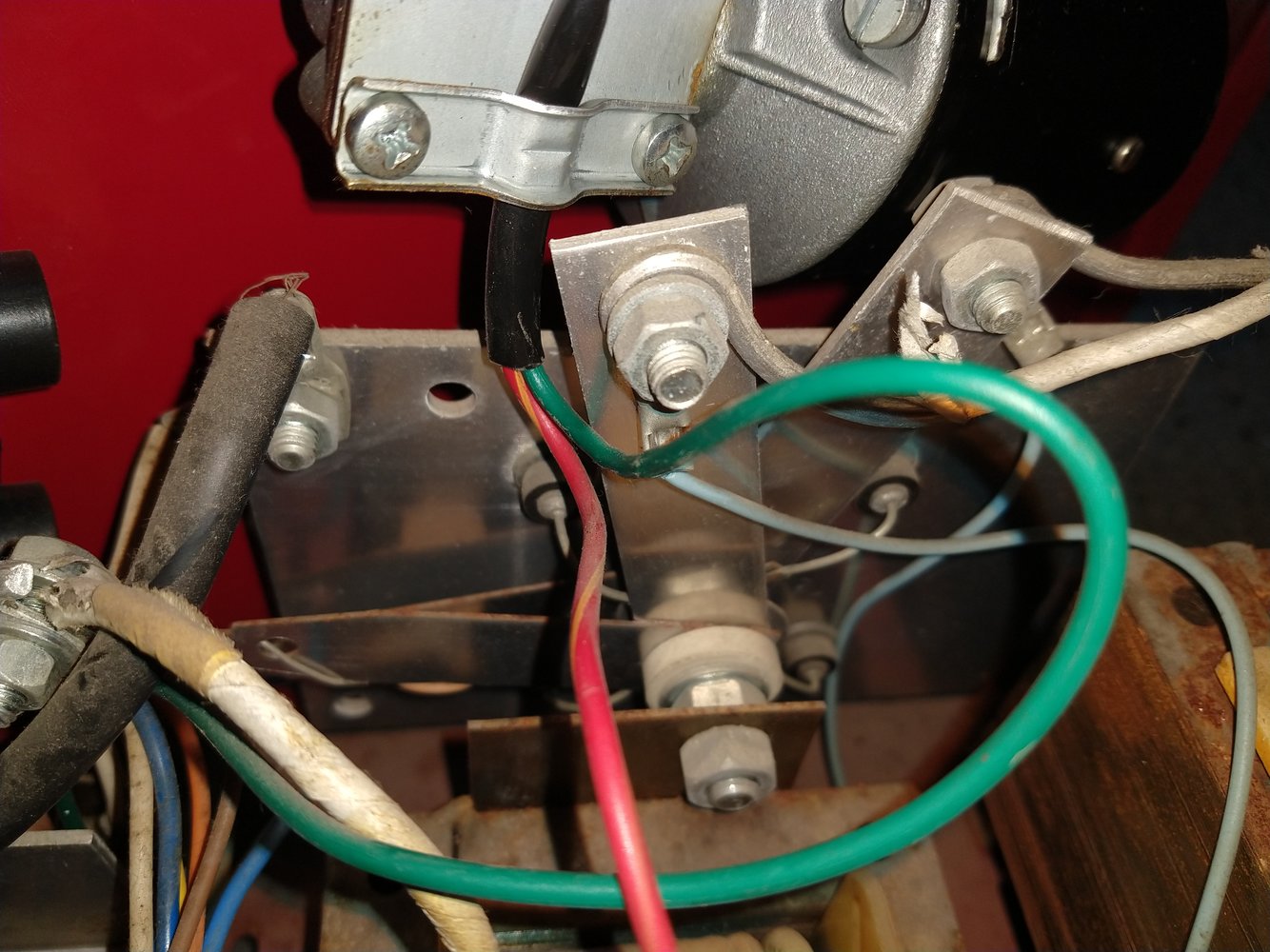

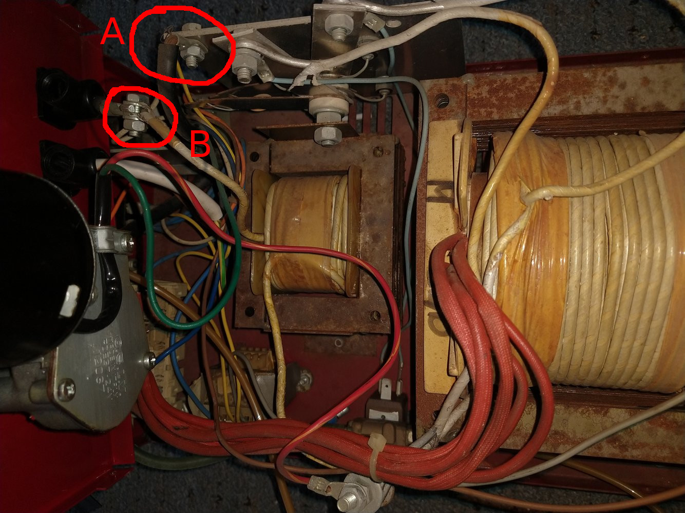

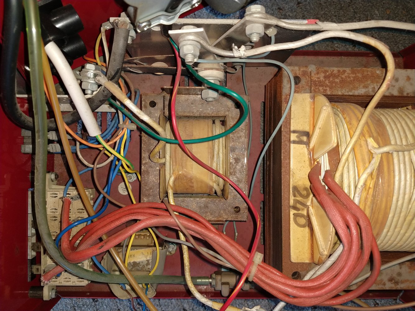

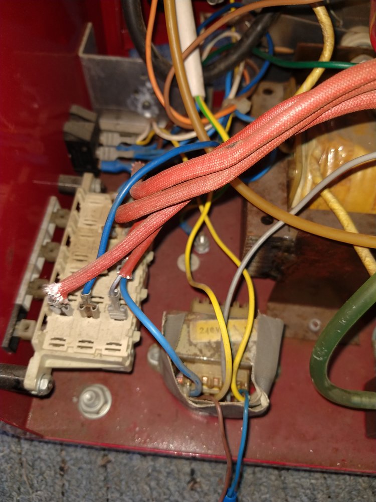

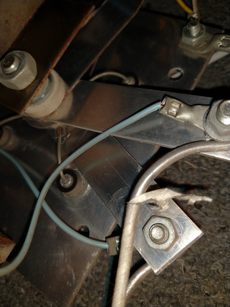

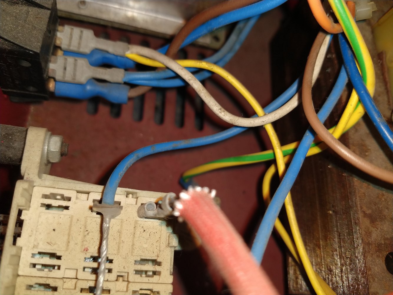

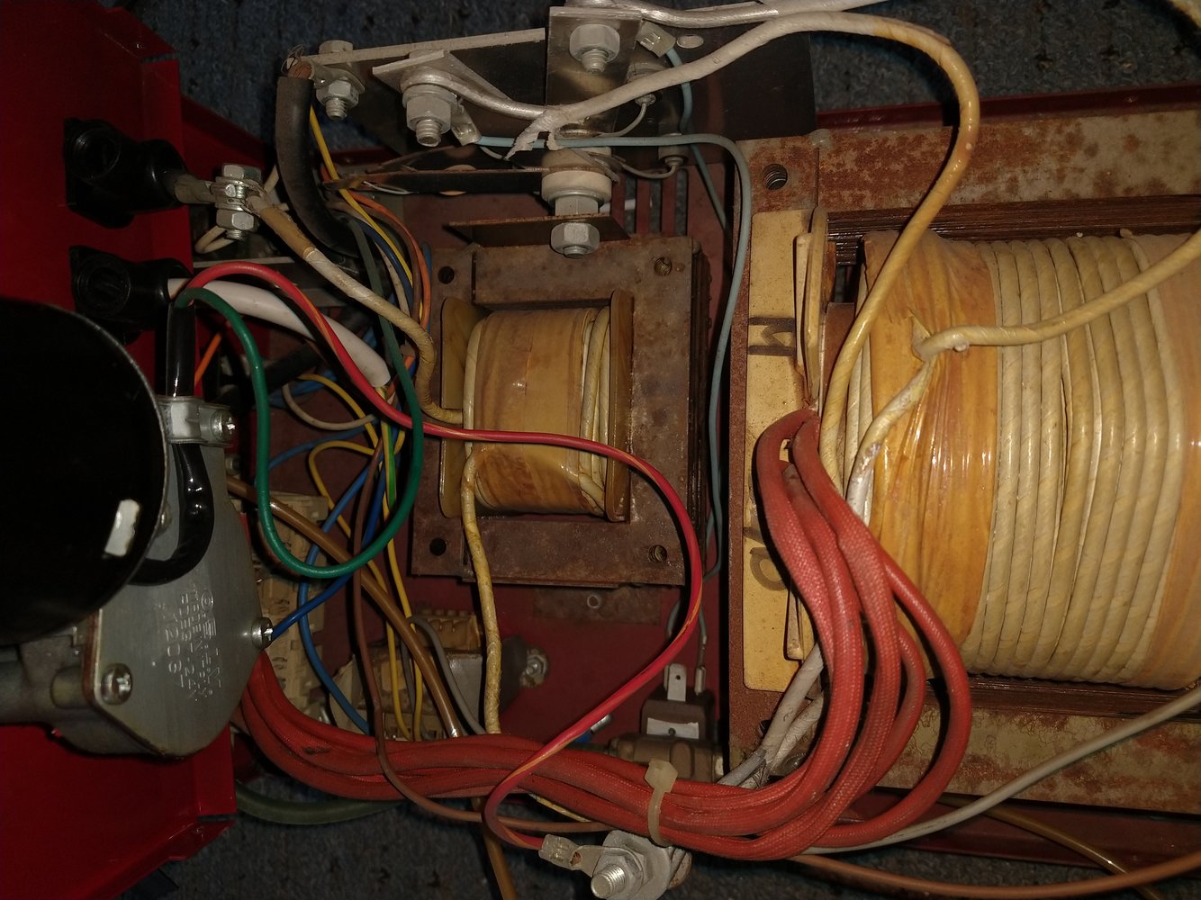

Thank you. Here are 4 (random?) photos:
The orange wire shown in the centre of the final photo (connecting to the PCB?) is the wire that is connected via a small choc block to the red wire that emerges from the bottom of the torch trunk.
If I connect the resurrected white wire, that @a111r mentions, to the red wire in the trigger, to where do I connect the other end?
Sorry this is so painful for you all.
It's worked this way on every model I've done, 4 different ones, at least.
