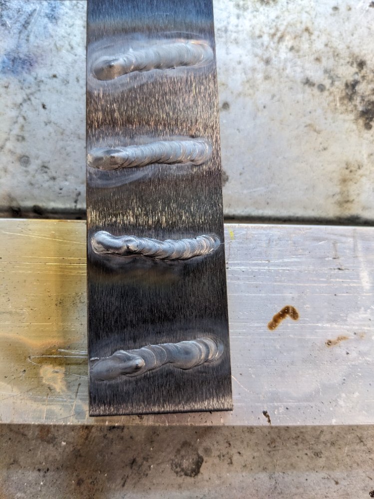

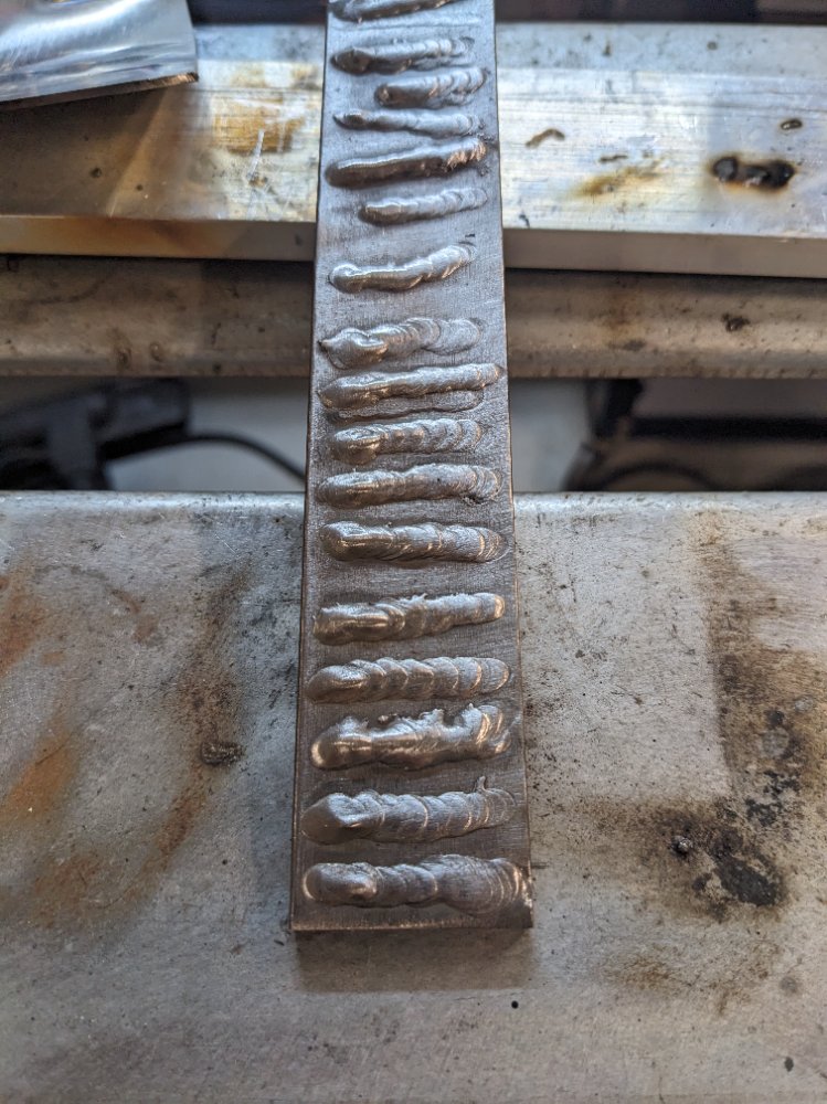

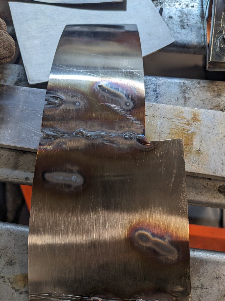

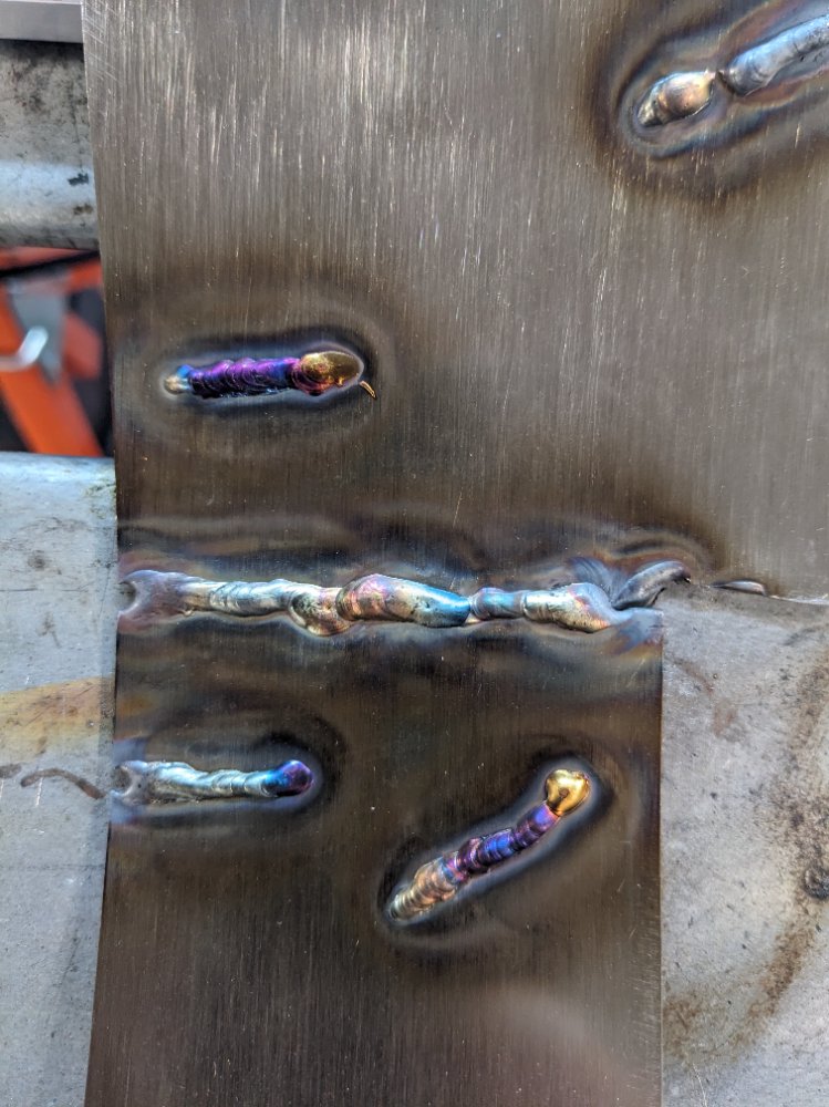

Thanks, I will take that on board and switch to thicker mild steel. I had been practicing on the thinner stainless as I have a bunch of off cuts, but makes sense to reduce the number of variables.Get some thicker practice material, preferably mild steel...
A number 8 cup wants 8-10lpm gas so 15 is potentially going to give you issues with turbulence and it wll waste gas.
I say mild steel for a few reasons...1 its cheaper than stainless or ally, 2 you can drop a few cup sizes and then drop your flow rate and post flow time and 3 there are less variables...you aren't worried about cooking it, the puddle is more consistent and stays roughly the same width even when the metal is hot and the filler is cheaper...
As for the cooked welds, you can have a few separate issues or a mix of a few with that, but if you are running at the bare minimum amps for that thickness your travel speed will suffer and that will cook a part...turn the amps up and travel faster is my method but you need to get some thicker materials and nail the basics first like set up and arc length. Stainless can be tricky at the best of times, I can lay a respectable bead on mild steel then cook stainless onnthe very next weld...steel will follow the 40amps per mm rule, stainless wants less because of its poor thermal conductivity and the hotter the part gets the harder it gets to weld...and it distorts for fun too
