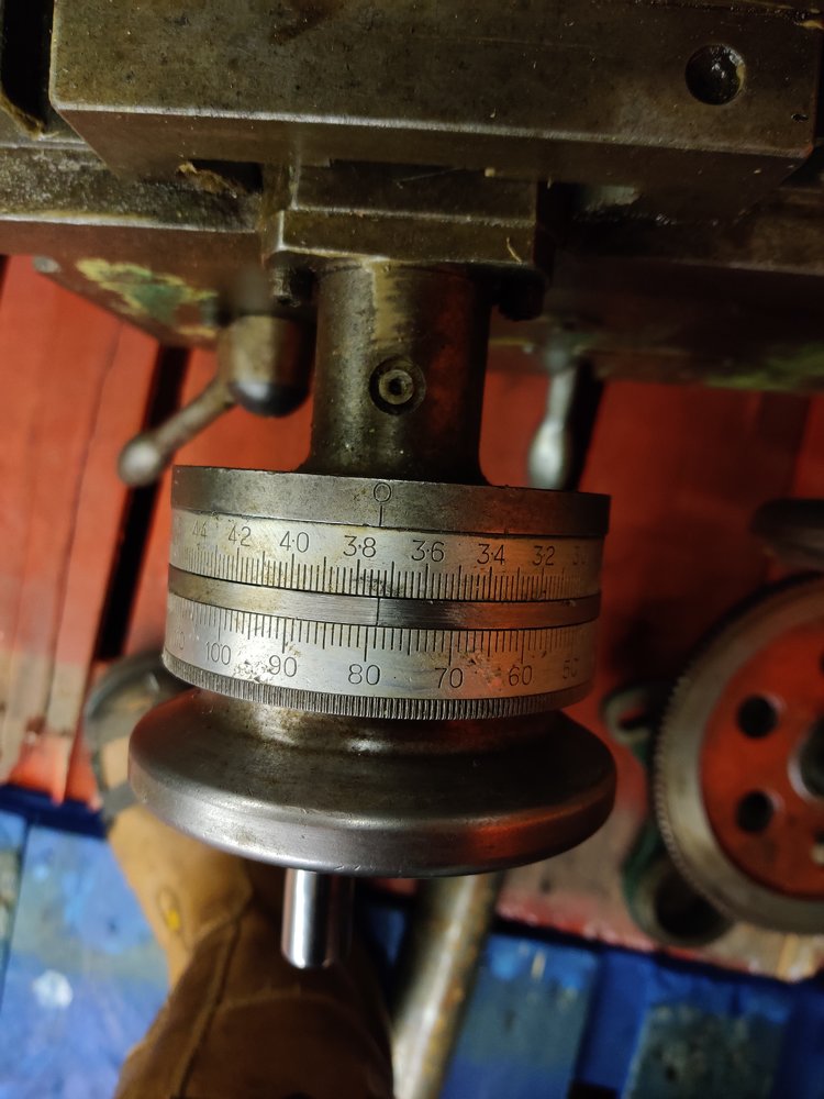

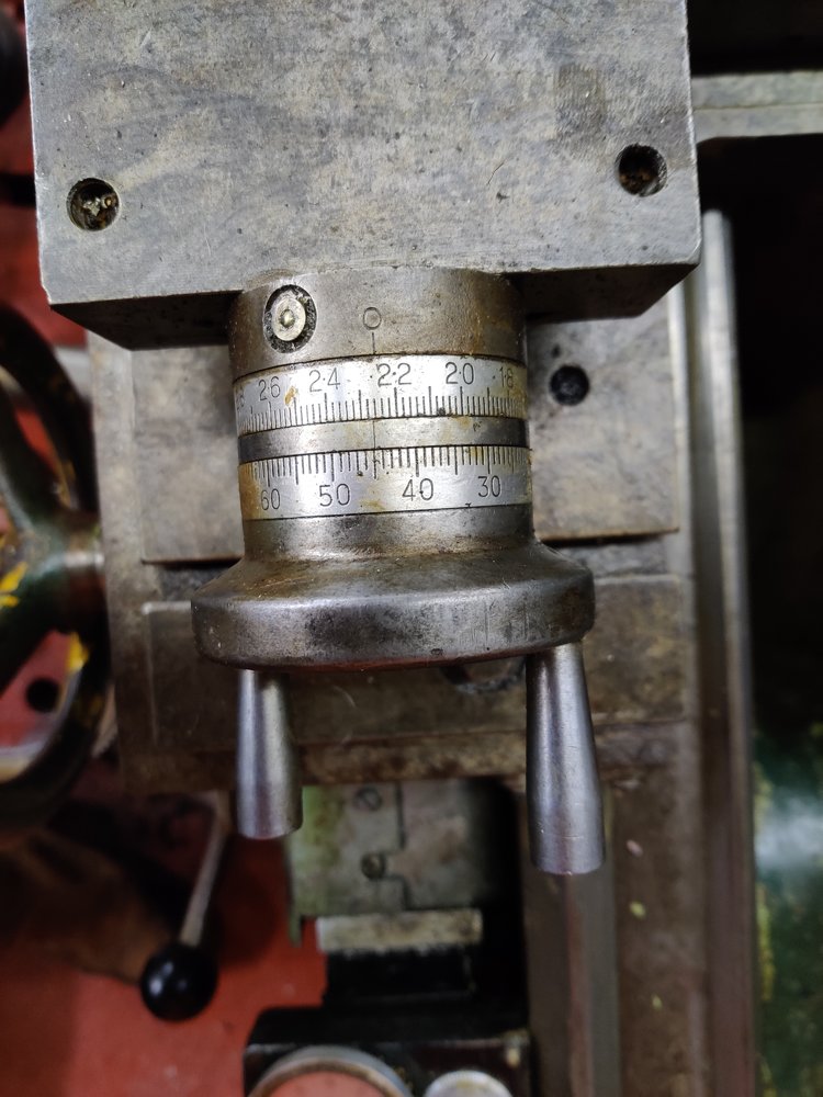

Must say that is a well specified machine. Dual dials, ainjest threading, trav-a-dial and you have the steadies. All the bits that are normally robbed off it and sold separately. Bit of a jackpot TBH

Best I have seen on the dual dials is this: https://www.circuitousroot.com/artifice/machine-shop/cr/colchester/repairs/dual-dials/index.html
You can search Espacenet and find the Gamet patent drawings as well.
For insight into how the faceplate jaws work, look on YT at Chris Maj and James Park Machining (turn screen sideways).
Thanks for the link on the dials I'll have a good read over later for when I will use them.
It's not necessary to know anything to be able to use them - it was more to assuage your curiosity if you wanted know how they work.
Mystic Meg prediction: once you ruin a couple of parts by following the wrong dial, you will be making a cover or shield to obscure whichever language you are not using (3D printed?).
Intresting to see they having the same screw pitch but metric and English threads
Seems like a good idea and thought it might have something like that I've seen online but might be for other dual dial lathes
