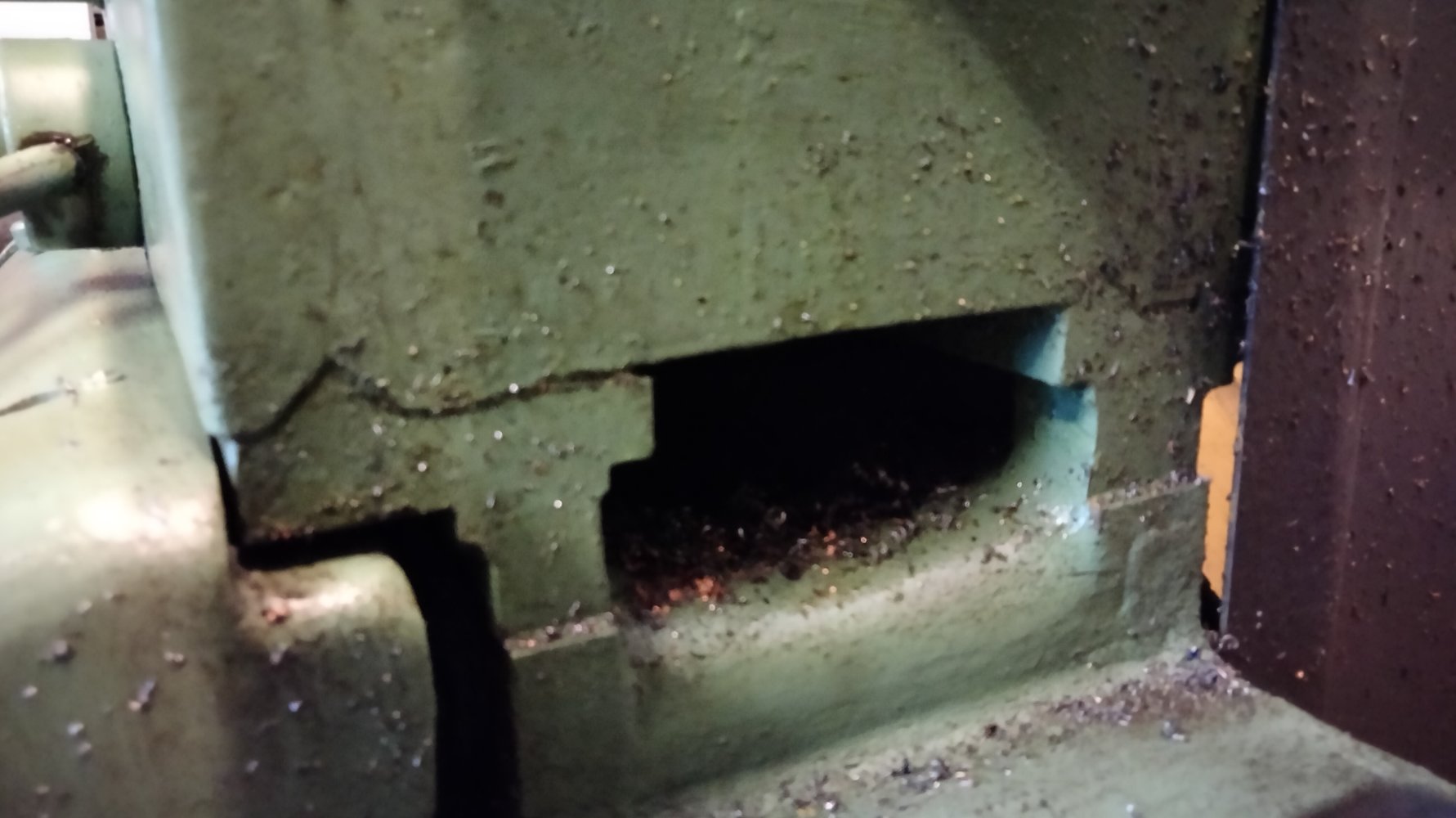

Interesting stuff there on the headstock adjustment, I could never work out how it was adjustable, given the inverted vways go under the head. My old mk1 is rough as can be, but the bearings have never given me cause to question them. One day, I will strip it and get it ground end to end, until then it gets used.
Where the vee way passes under the headstock the male vee is smaller than the female one, so there is adjustment room.
