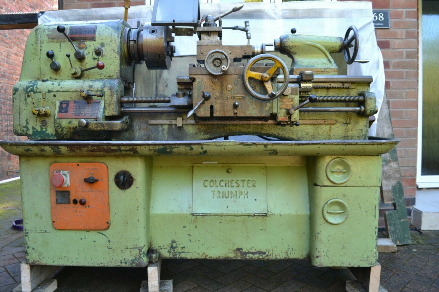

Ah yes I also had the two-speed motor one, It is wired in 16A 240v supply to a Single phase 240 to Three Phase 440v Chinese VFD. The two-way switching is done using the original Colchester switching gear which is wired in-between the VFD and the lathe motor to set either low or high speed.@Lewis_RX8 hi there iv recently purchased a Colchester triumph 2 speed motor 400 to 440v would a vfd 220inpit to 380v output 7.5kw run it with changing configuration on motor also did you wire your 2 way switch between the motor and vfd or to external controls on vfd thanks
