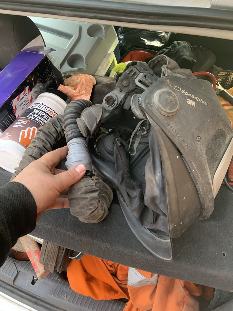

Hi Brad yes I've got a trusty fx had it for many many years I still use it but the lens is just the old X one so viewing area is small. Very good lid though and to be honest with you if it had the xxi filter it would be my go to lid and keep the g5 for more clean environments. Now you got me thinking budy I might keep my eyes open for a xxi for it.Gimmick, that's the word I was looking for. That's exactly what I think of the colours.
I don't know if you've had a FX but that's what I am comparing this helmet to.
I guess compared to an ESAB or other brand it's leagues ahead. But it's not as good as the tried and tested FX

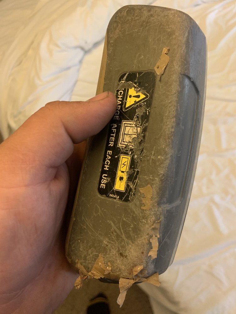

Thats a good tip....also great review.The duct tape stops battery falling out or adflo turning off when knocked, kneeling or sliding round on your ass
The FX was the best helmet 3m made. Hang onto it and your original face seal. New one is crap with the bit missing at the top.Thats a good tip....also great review.
Looks like I'll be keeping my fx a while...the 3m lens (xxi) is blooming great I have to say.
