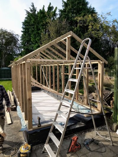

perfect thanks just staple it on do I?
Yes staples should be fine although i had stainless steel ones as it can take me ages to finish jobs so the normal staples can rust awayperfect thanks just staple it on do I?
ha ha i have what I have they are regular staples they will have to do ill have to get the cladding on quick!Yes staples should be fine although i had stainless steel ones as it can take me ages to finish jobs so the normal staples can rust away![]()

Looks like ~I got some work to do!
Moving the ballast is going to take the time, it is double the price to get 25kg bags I will have to get bulk bags dropped and carry it in buckets through the house
nah ill have to get 25kg bags delivered and walk them through the house then mix it next to the hole and pour it in
just got a load of bricks and blocks for free. so I may start this build next week. still undecided on whether to get the concrete pumped or mix it myself. all depends on cost. i think they charge £300 for a pump fee!
Would there be an advantage to build a block or 2 on the slab to keep the timbers off the slab?
what made u opt for 3 blocks?I done 3 concrete blocks then timber . We all do different ways but this was mine.
Enjoy your build.
Well had enough for 3 blocks so just used them up but am sure two is enough.what made u opt for 3 blocks?
fair enough, I have plenty of blocks but my mate says it will be stonger if i fix the timber frame straight to the slab. I was just worried about the timber getting damp/wet and rotting soonerWell had enough for 3 blocks so just used them up but am sure two is enough.
I raised an old freebie shed on blocks/bricks. Shouldn't have bothered. Ended up with a tiny shed for a lot of work. Should have chopped it up, sold it as firewood by the gate and put the money towards a shed 4 times the size:
Those with youngsters or planning to. Build a big, warm shed. Use for all sorts of projects in whatever the weather with them. You will literally make memories in there. Even, for the cost involved, consider putting 150mm of insulation under the slab and underfloor heating pipes for the future.
