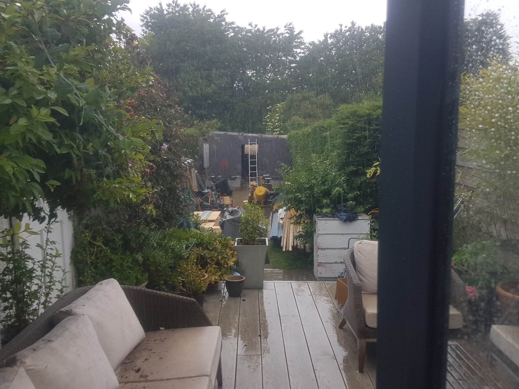

it aint a bad view be nice to have a roof garden up there
Careful youll be putting rails round that, and garden furniture up there.The Mrs took a few pics

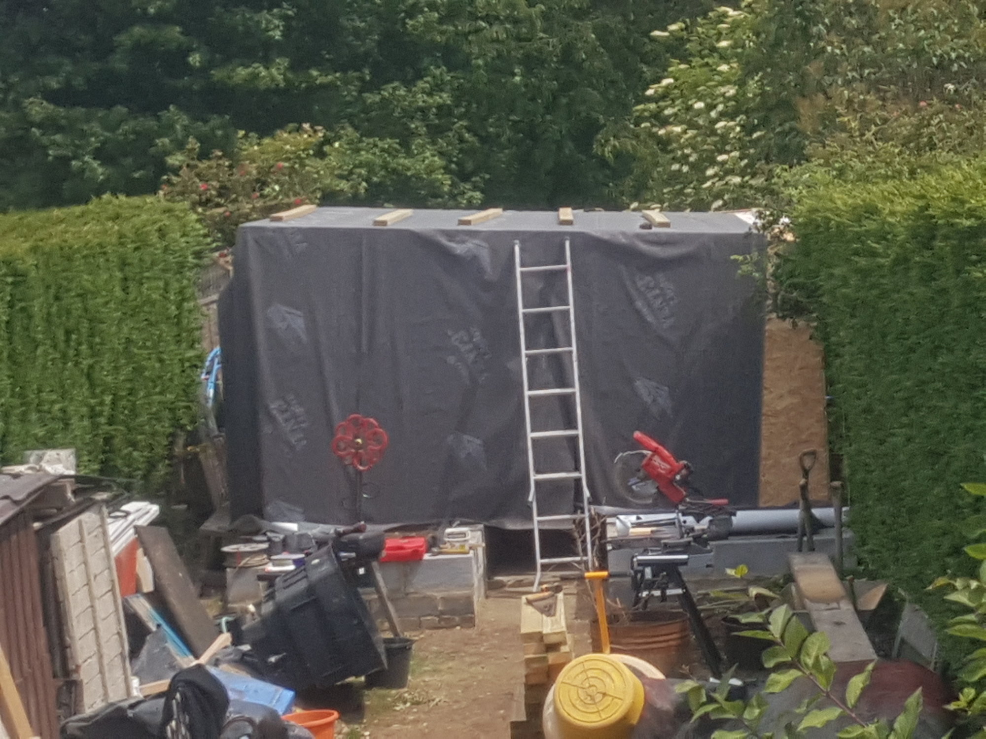

That's a lot of cutting. Can't I wrap over them and staple it on both sidesCut round the rafters which stick out. It's to stop moisture going in through the walls but let moisture out.
That's my thoughts too thanksI would personally put it on top of the insulation.
Getting there with the wrap.
Roll was not wide enough to do it that waywhatever made you do it that way for
you should have done it from the door around to other door and up to the top
the top pieces over lap the side pieces so you have a full wrap around of your structure in breathable felt
