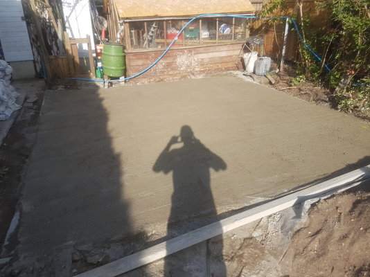

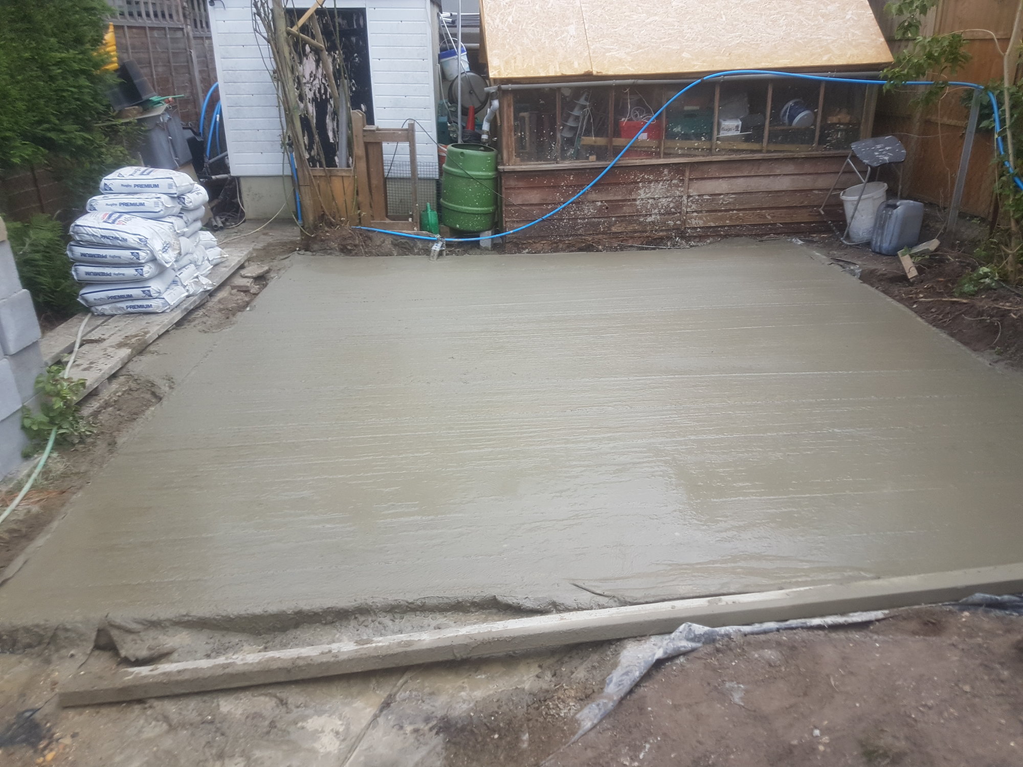

its touch dry nowopinions vary , but as it goes touch hard just a light spray , go out say half hour later and see if its dried of, if yes spray again , I use hessien sacks to slow the cure down , just damp them down. its basically so it dries at a steady rate and doesnt overheat causing shrinkage cracks ,
dont know whether dpm would be good or not , no doubt some one on here will know, ah try @8ob , he s genned up on slabs
Keep an eye on it. I layed a cubic meter of concrete today. We covered it with ply but even then we still had to wet it a bit.i will give it a good few sprays tomorrow too
