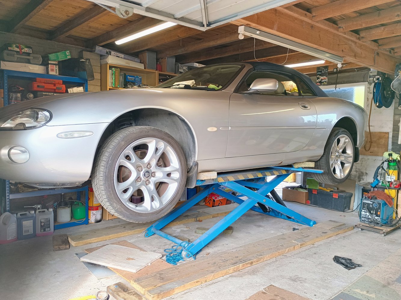

Up in the air.

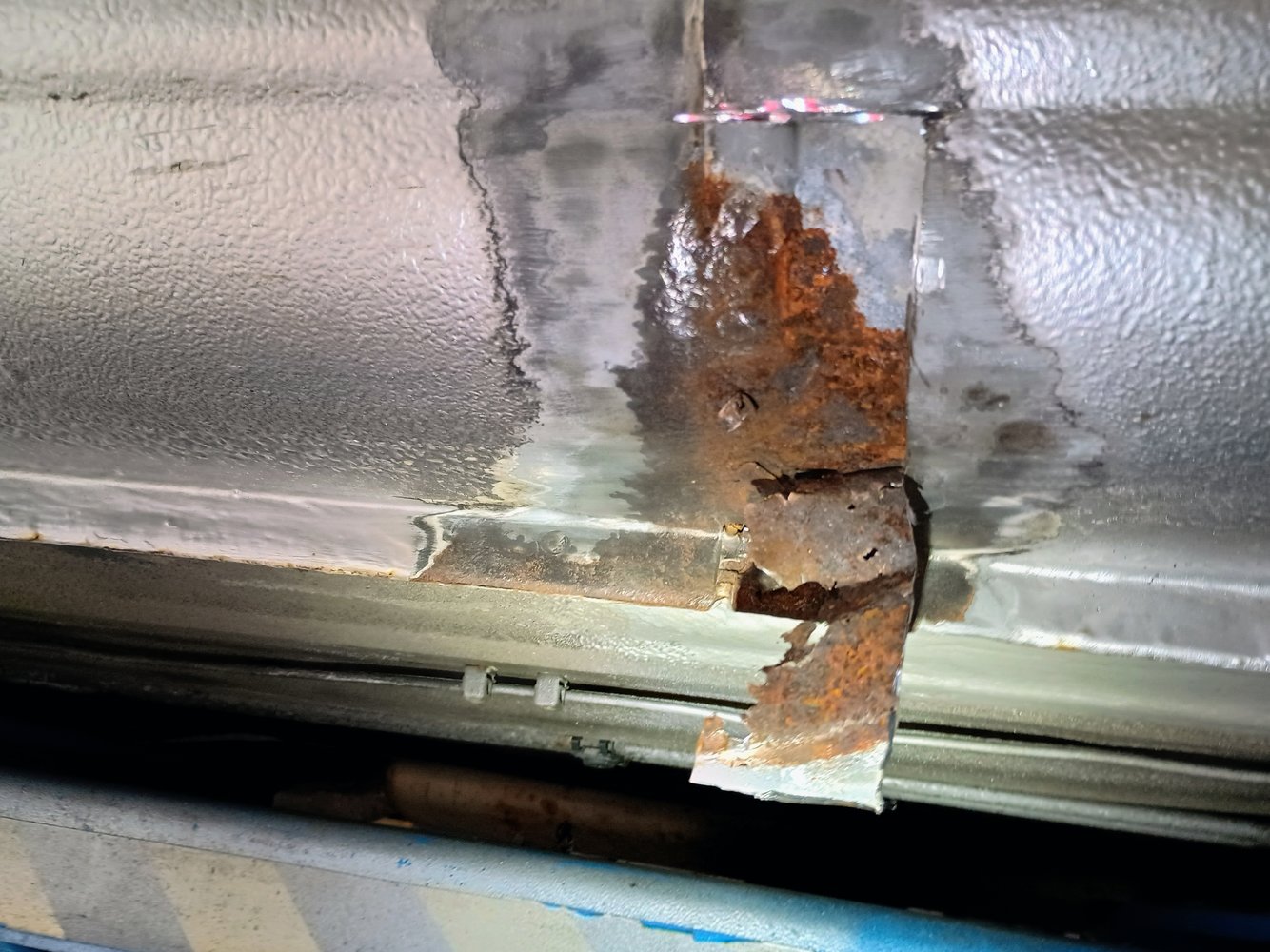

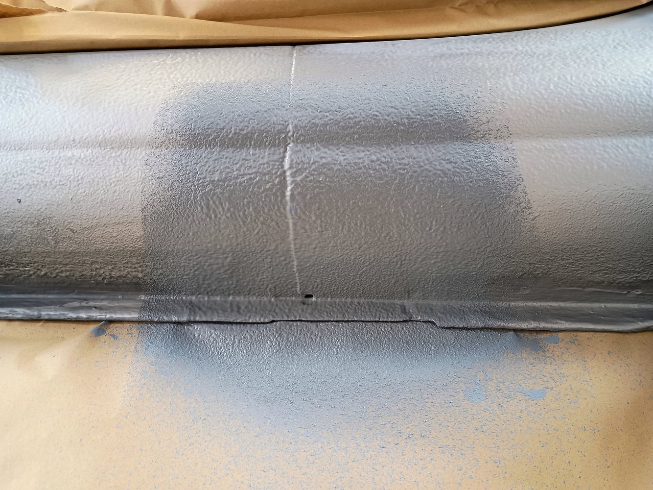

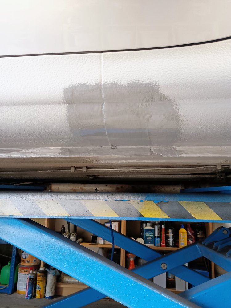

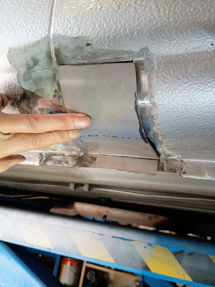

The paints been bubbling here for a few years, time to start picking it off.

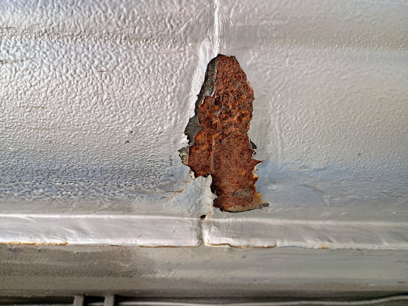

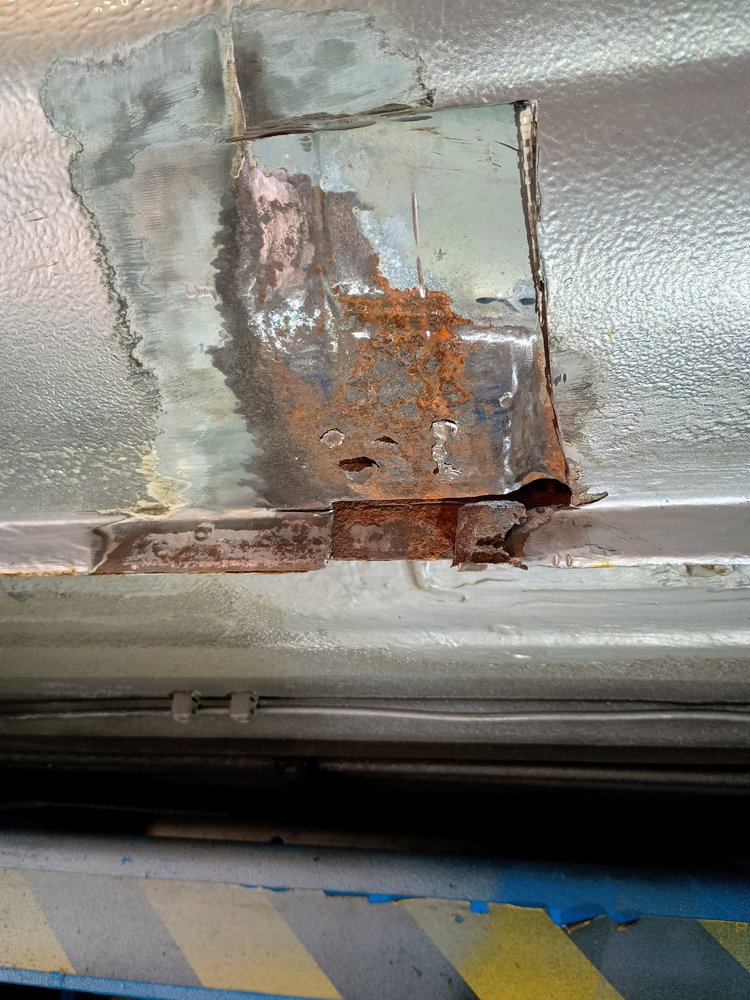

Started to cut....

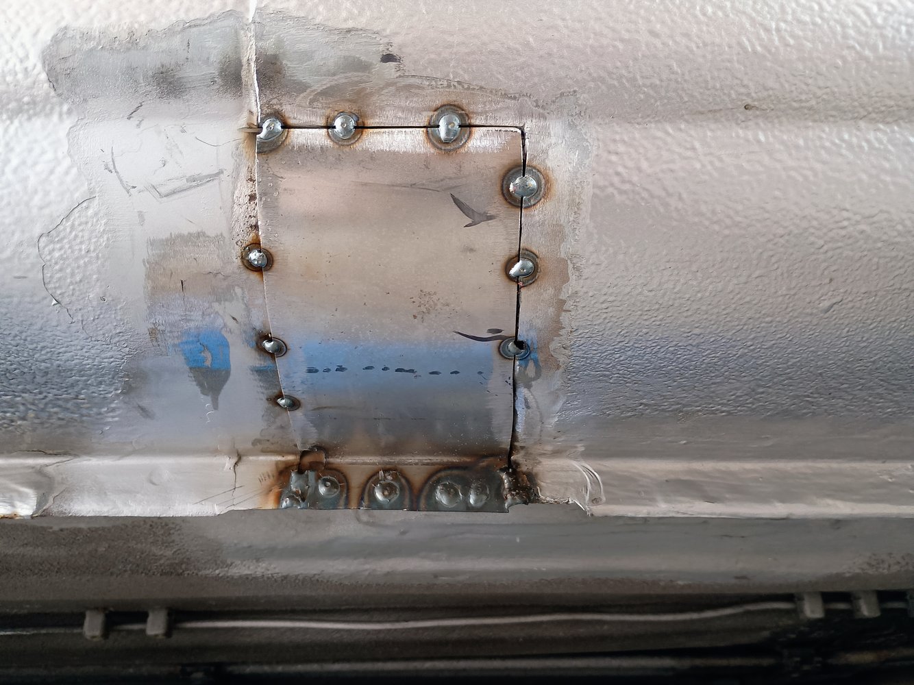

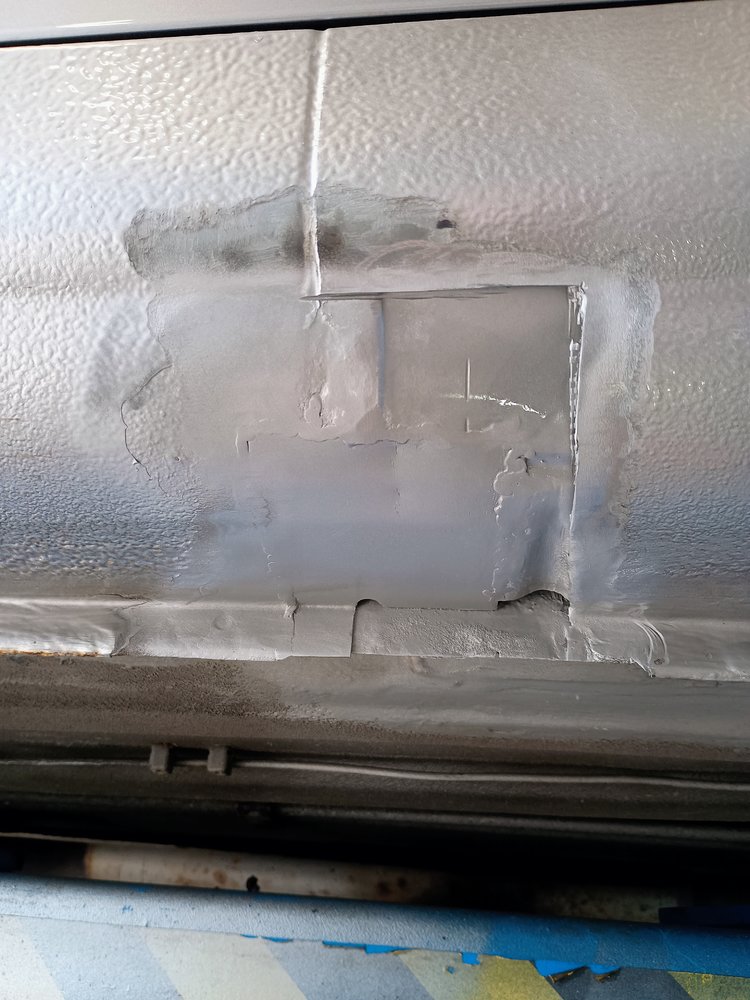

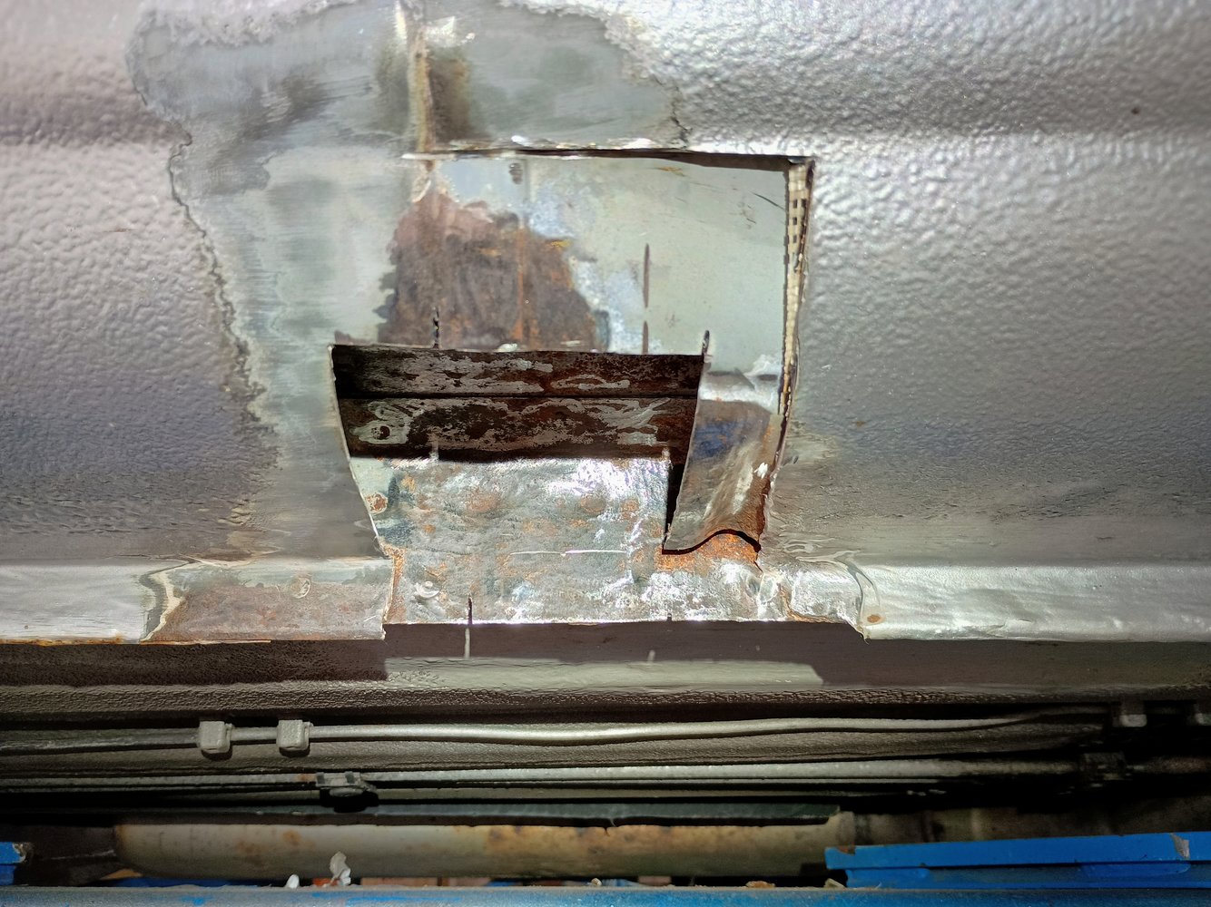

And a bit more......the sill is in two halfs with the rear section overlapping the front.
This car is full of poorly protected overlapping sections, really crap design.
Will do some more cutting tomorrow.

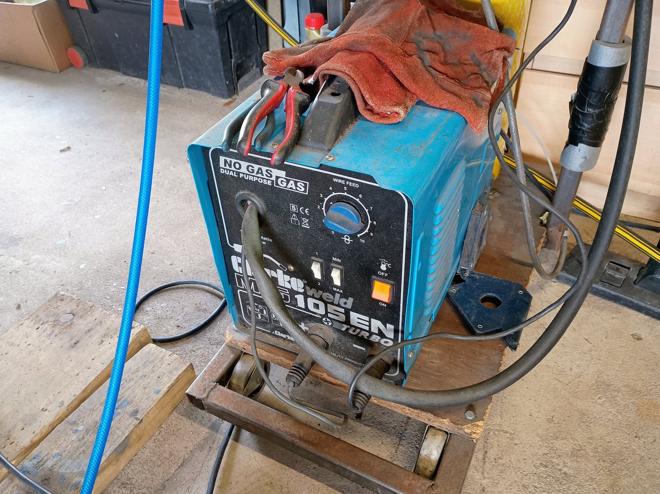

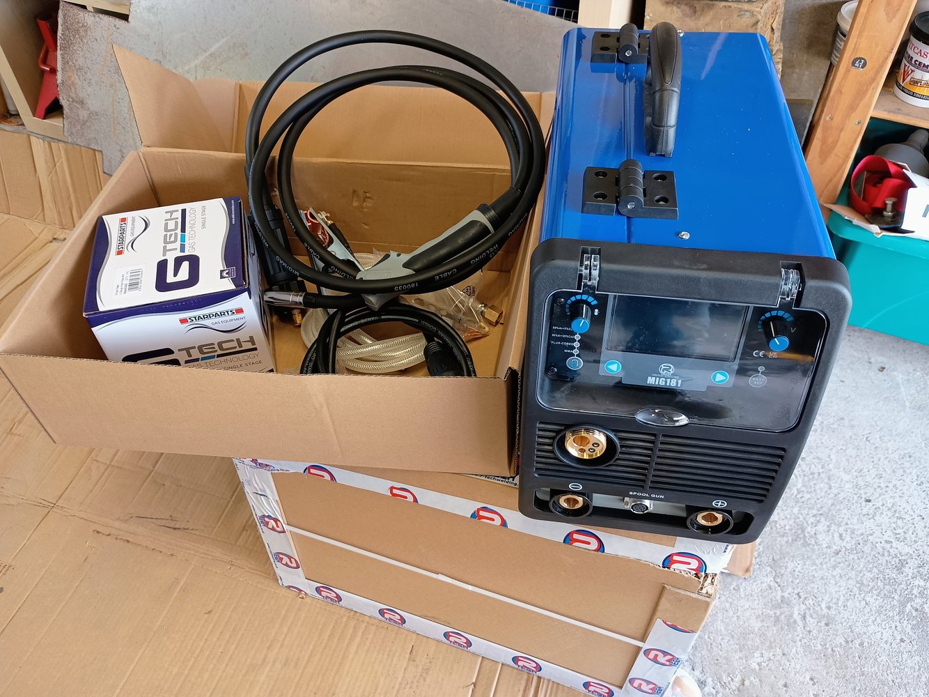

My new Rtech 181 is due here tomorrow, looking forward to the upgrade from my second hand Clarke 105en that I bought 12 years ago.

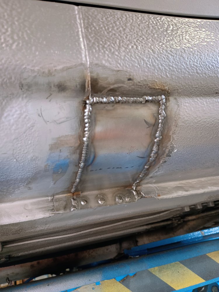

Started to cut....
