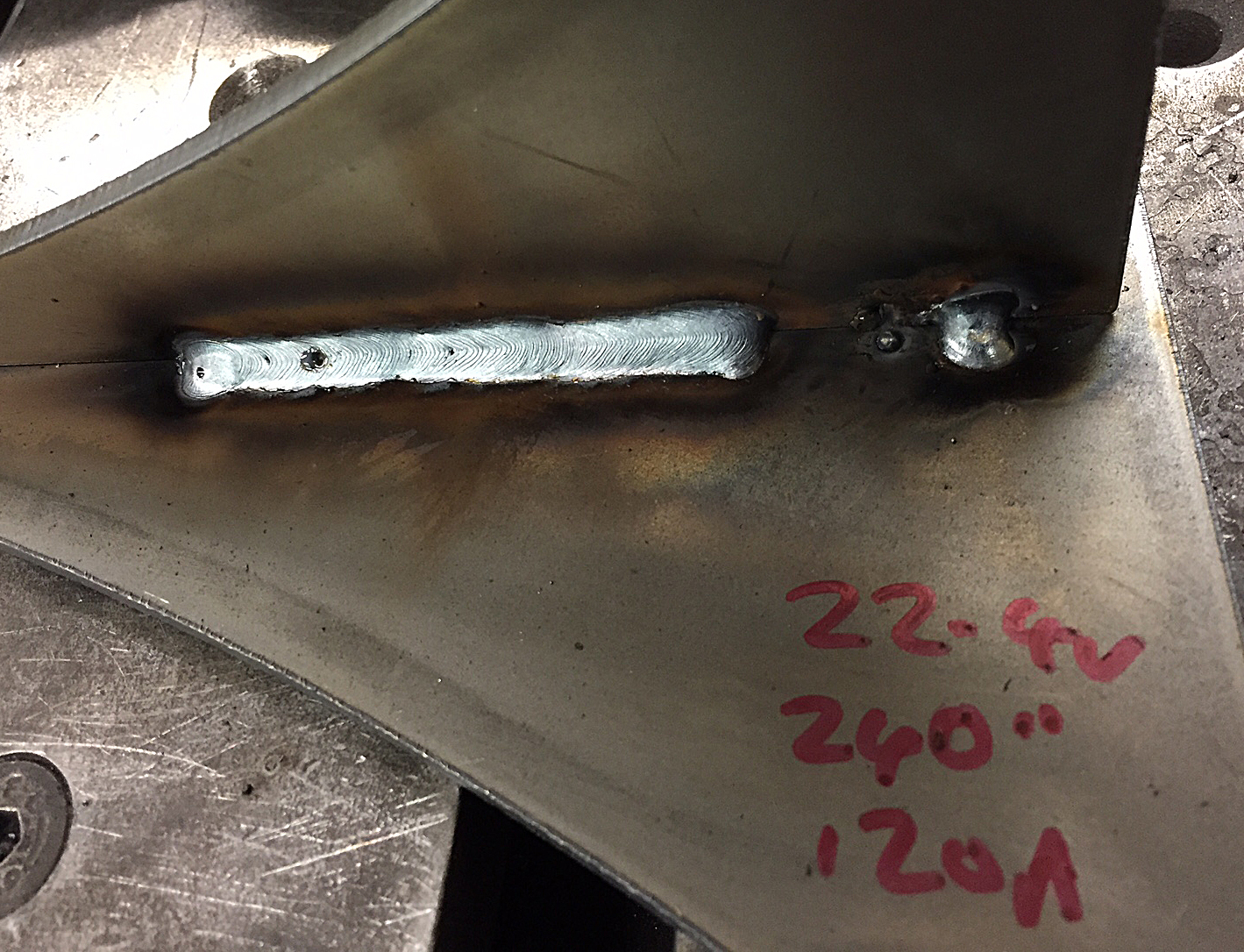

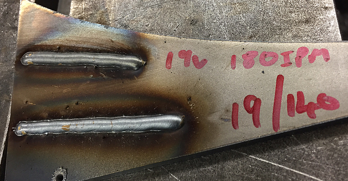

100% not the wire quality. Wire too slow, liner blocked, tip issues, roller issues even the wire feed motor running slower
But it's not the wire quality! You have a great long arc and that's impossible to create without too much power or the wire not feeding out fast enough
