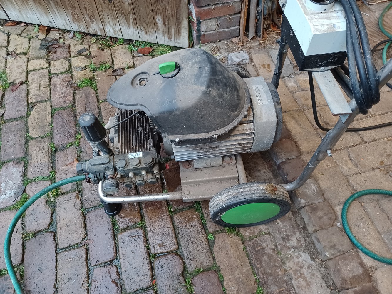

Parts are still available for that particular pump. Its ok for a short duration to recirculate the water, but doing so increases the water temperature inside the pump. Turning off the machine is better for the life of the pump internals.
Adding an external detergent injector after the unloader valve is an easy way to add detergent to the water, fitting this after the pump means no detergent should enter the pump and remote operation of adding detergent is possible from the end of the outlet hose.
