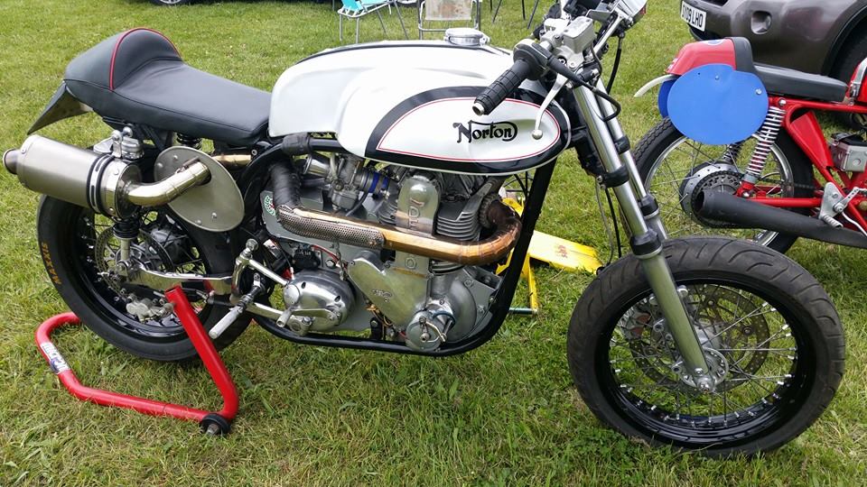

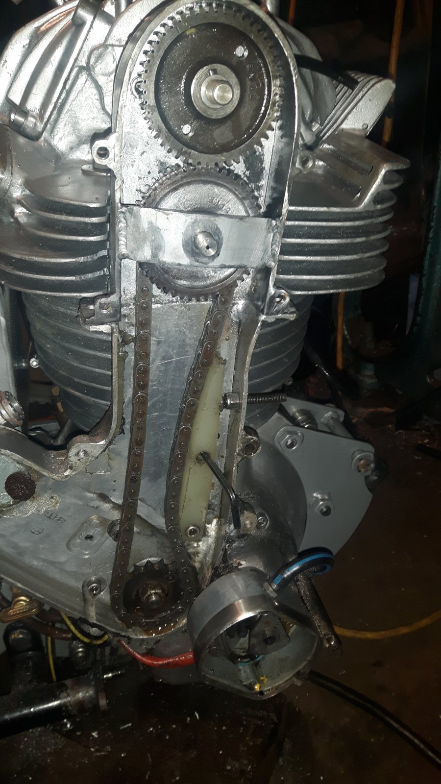

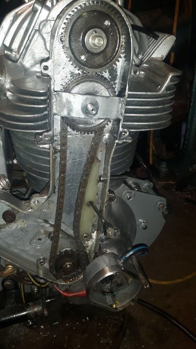

i started working on this about 10 years ago its a pushrod es2 welded up remachined with desmo valve operatiion its 660cc revs to 8k for this year its got a genuine ncr cam and dual plugs
