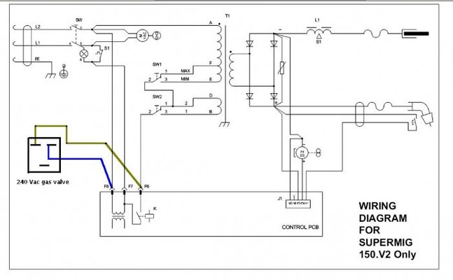

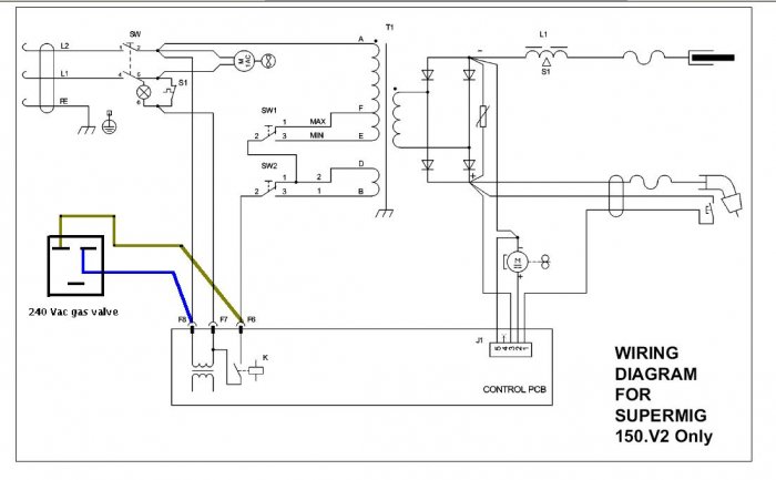

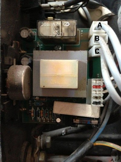

Jay 1st you will need a meter.
NOTE You are dealing with MAINS VOLTAGE do not try if you are not sure you are safe.
Then you will need to meter between A and the other two connectors B and C.
With your meter set on AC volts put one probe in A and then the other in B. You should NOT get a reading of any volts. Now press the trigger and see if you get a reading of 240V, if you do you have found the connections you need to add onto. If not try same but this time try C and not B. Once you have figured which is which you can then look to add piggyback spade connectors to these points and connect your gas valve to these. Just remember make wires secure and covered as this will be mains voltage.
The circuit diagram is of another Sealey but is much the same as yours.
