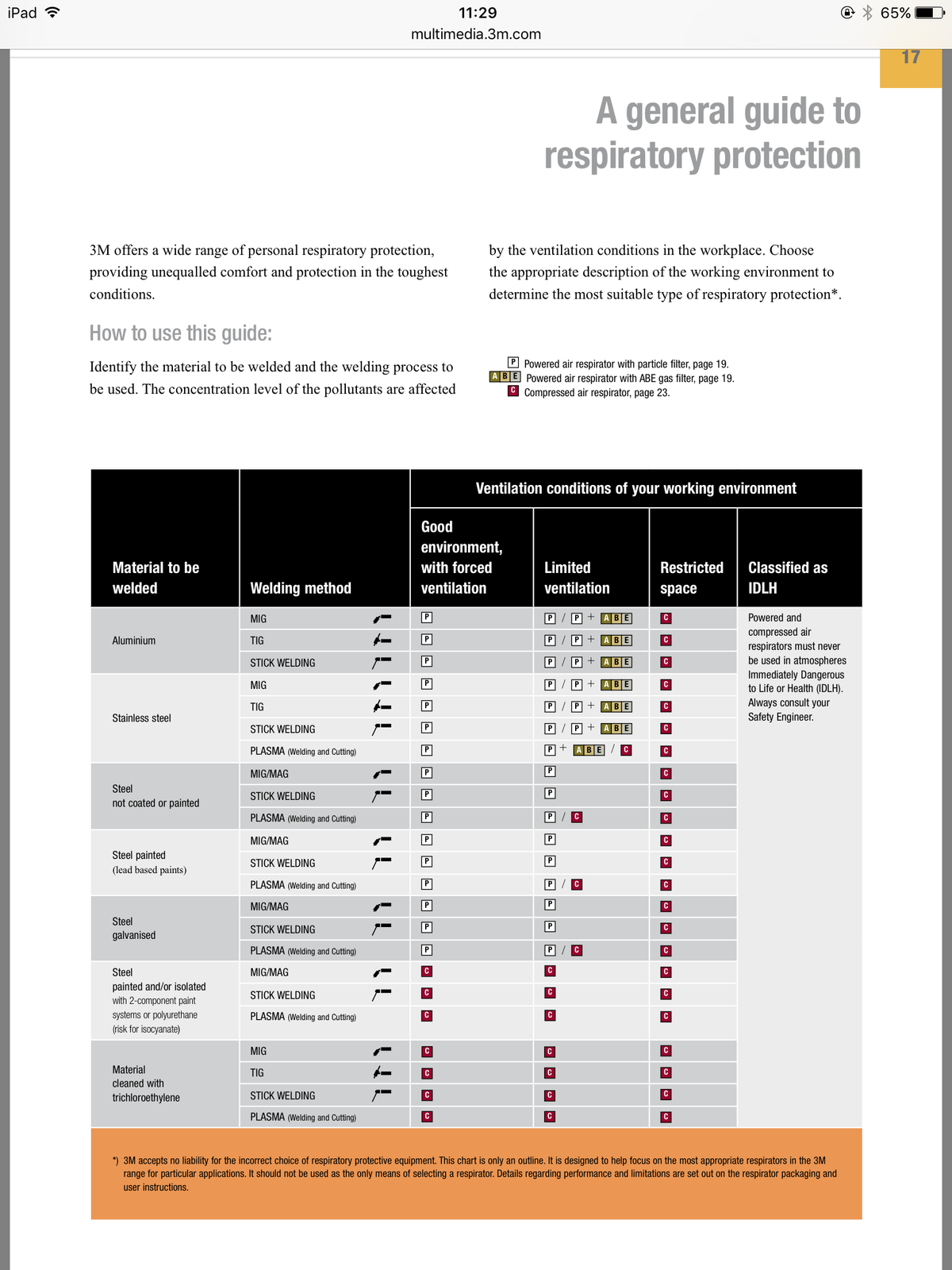

It's got the gas filters in it as well£95 for Adflo filters? Surely not - i think the outer white fluffy one and the inner finned one cost us about £15 a set.
I would definitely change them - you don't know how long they have been in.
A new helmet, adflo, charger and bag costs us about £600 so i'd say you got a good deal!
Do I need the gasses filter£95 for Adflo filters? Surely not - i think the outer white fluffy one and the inner finned one cost us about £15 a set.
So I don't need it because receding it you replace it every month and that seems expensiveWe just use the particle filters
It's ok for what we do, i'd be surprised if you need the gas filter - i think that would depend more on the atmosphere you are welding in rather than what is produced by the welding process itself.
Thanks for that it is very useful
