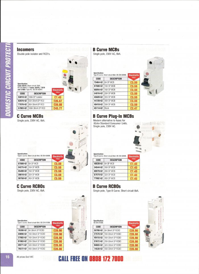

that is providing u havent allready got one at the source of the garage supply in house consumer unitrcd - residual current device
mcb - mini circuit breaker
rccb - residual current circuit breaker (same as crd as far as i can tell)
rcbo - a new one on me!
rccbo is a minature earth leakage breaker with a built in minature circuit breaker at various ratings eg 6 amp  16 amp and  30 amp  combined . they can be used to protect individual circuits without tripping the rest but cost £££££££££££££££££££££££££££

Just a quick one, it looks like you don't have any local isolation on the 16a Sockets, the MCB can't be used to switch the sockets on and off. I discovered this, and had to spend the best part of £100 on extra parts to make sure they could all (12) be switched individually
the plug is the isolator as said aboveWhy would you want local isolation on the sockets?, none of ours at work have it. To isolate the equipment, unplug it.
