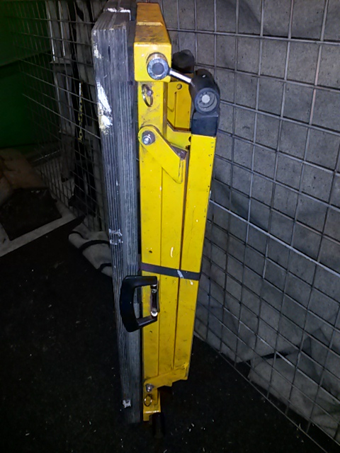

Here you go (pictures as promised)

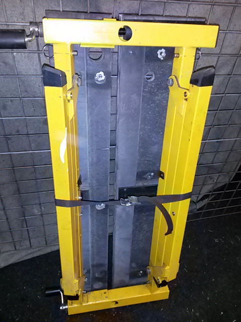

View of underside when folded:

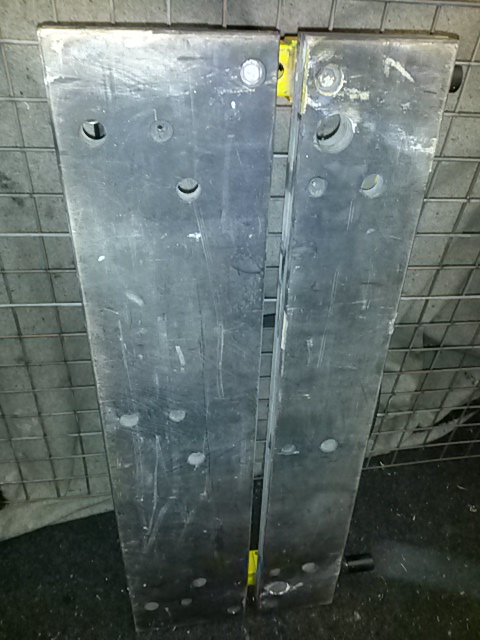

View of top - it has the usual clamping arrangement which is handy - also, there are some dogs which go in the holes in the top for additional clamping options:
Side view with legs folded:

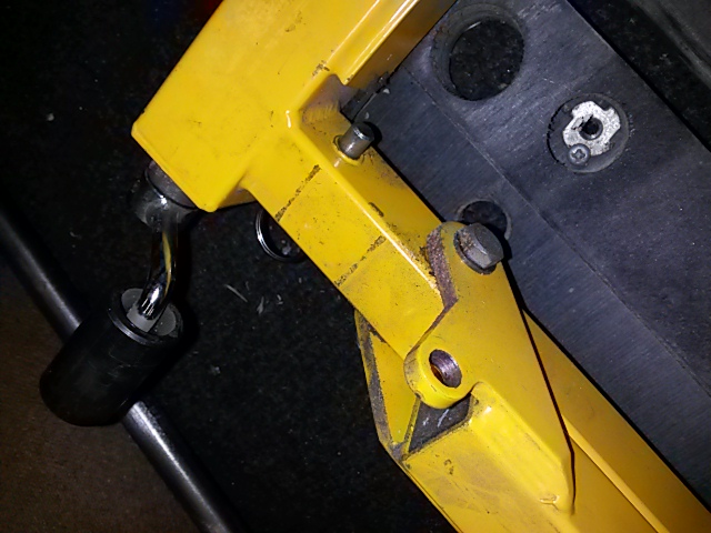

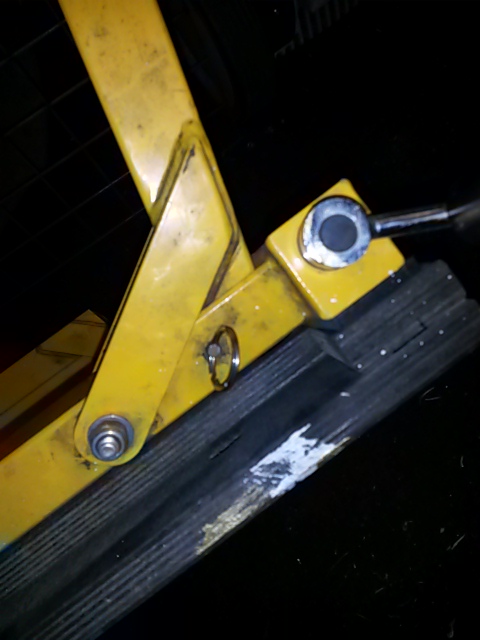

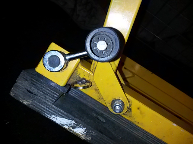

The leg hinges lock with spring loaded pins. Study the pictures and you will see that the leg hinges one end have a longer pivot to allow the legs to fold one over the other. This is the long end:
....and this is the short end:
This one shows the locking pin and the pin receiver:

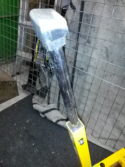

And this is the leg extended:
