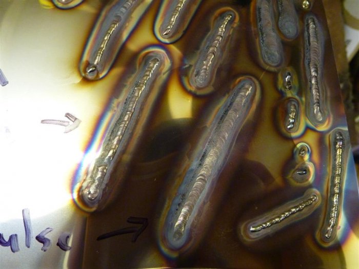

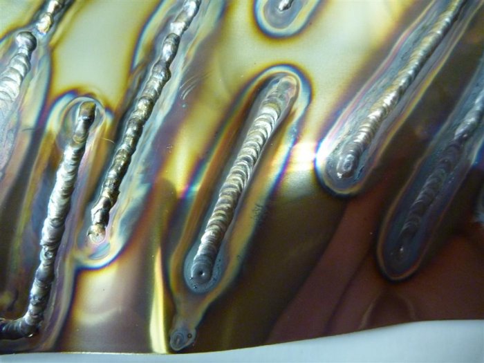

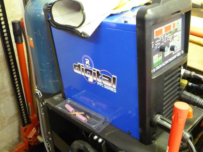

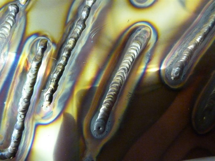

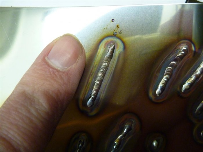

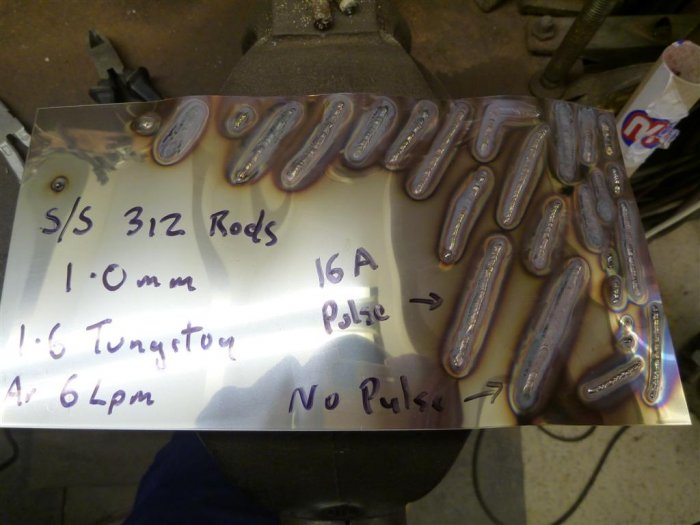

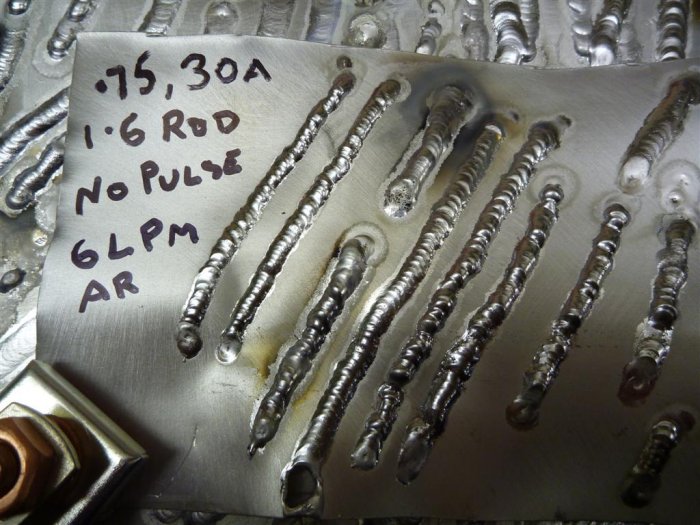

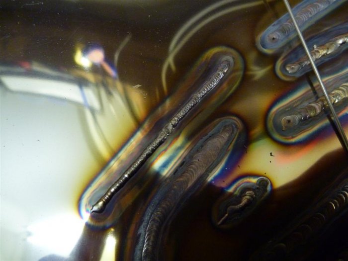

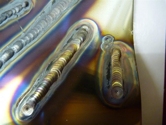

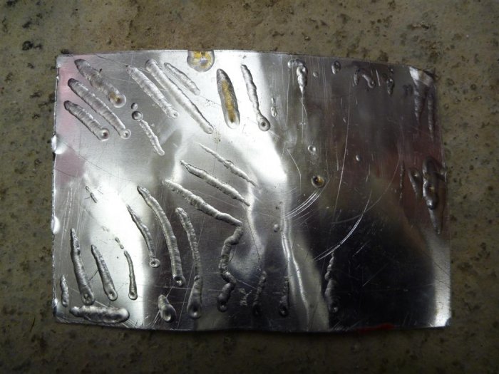

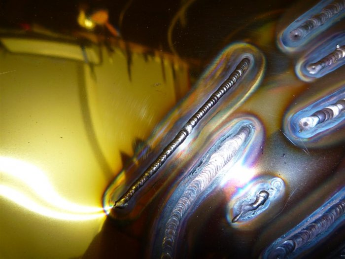

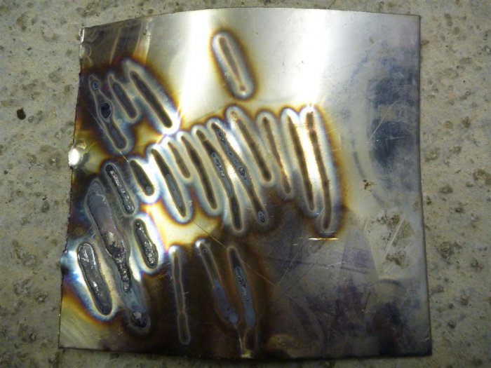

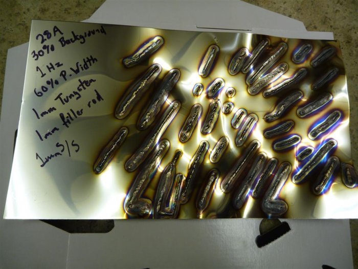

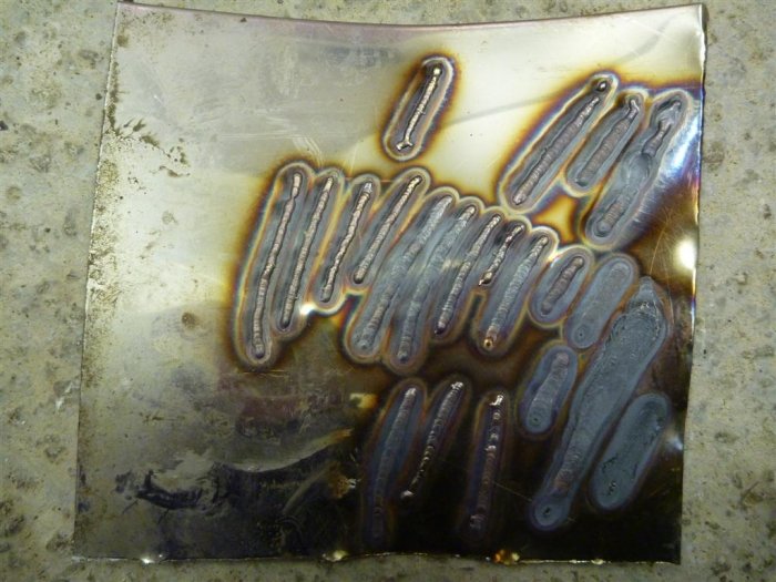

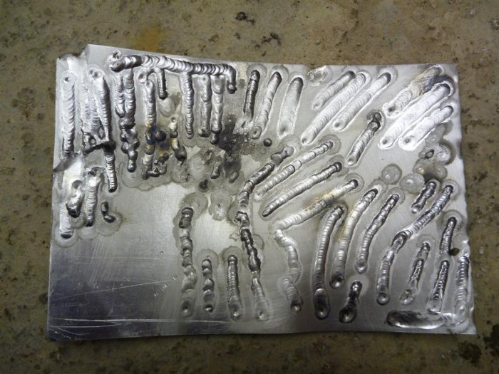

Hello all, have taken delivery of a new R Tech ac/dc tig welder with the digital panel and have been practising today
Now I have also been to the local friendly scap merchants this am and picked up some bits of aluminium and stainless plate.
Photos are the result, any criticism is welcomed as I have a long way to go
cheers Chris.
Rtech 210 ac/dc digital panel,
Argon gas
1.6 and 2.4 tungstons, red and white tip
Aluminium and stainless filler rods.
Bottom picture - the 3 welds on the top right were done with the foot pedal.
