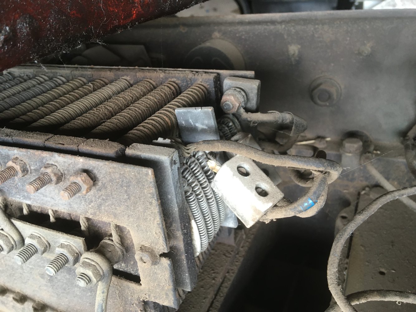

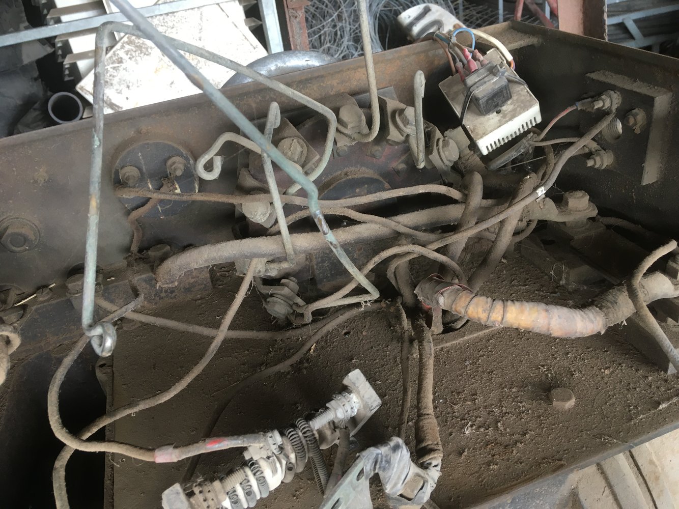

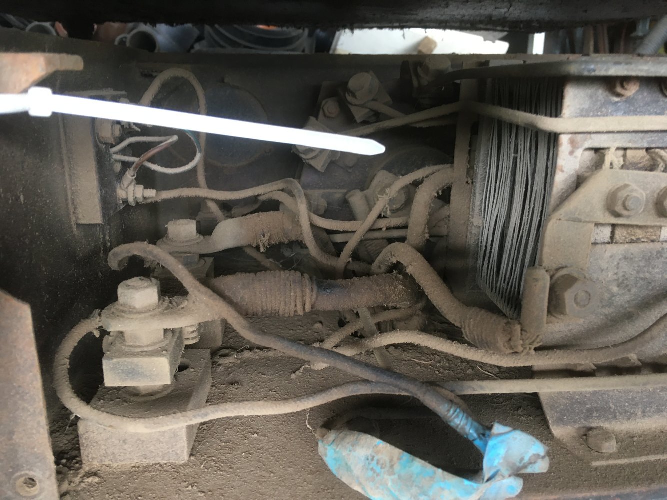

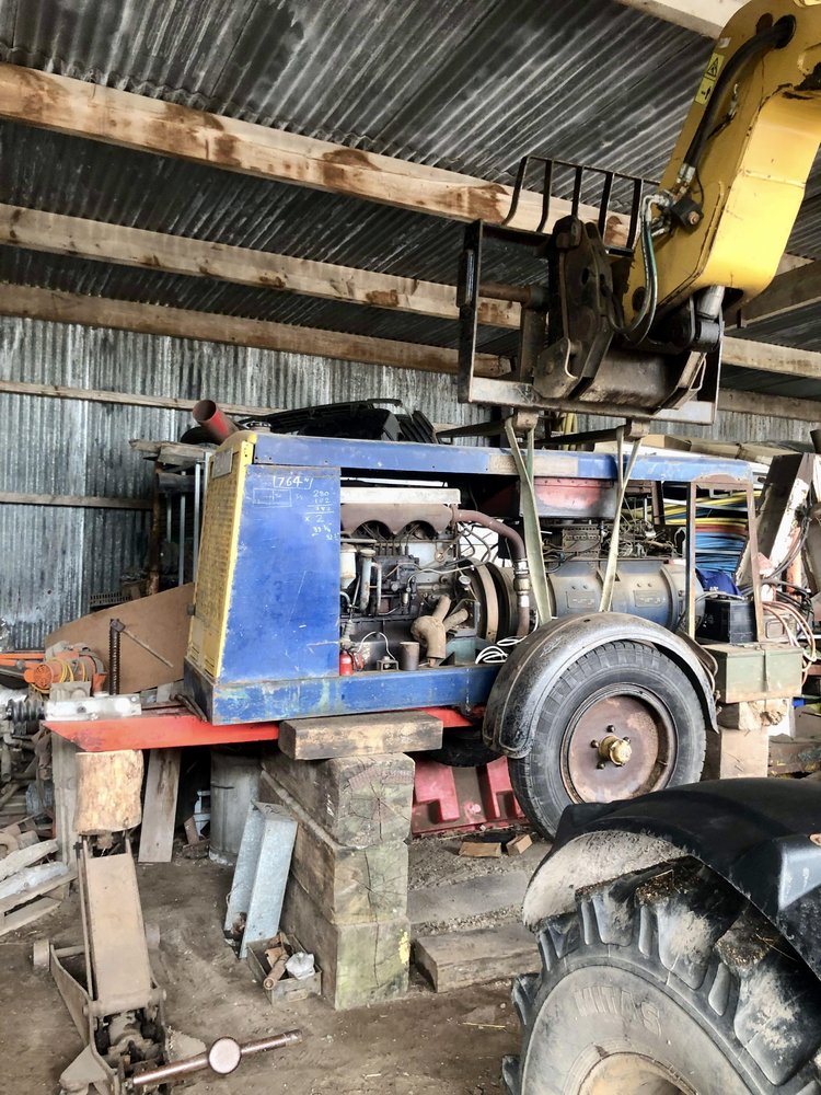

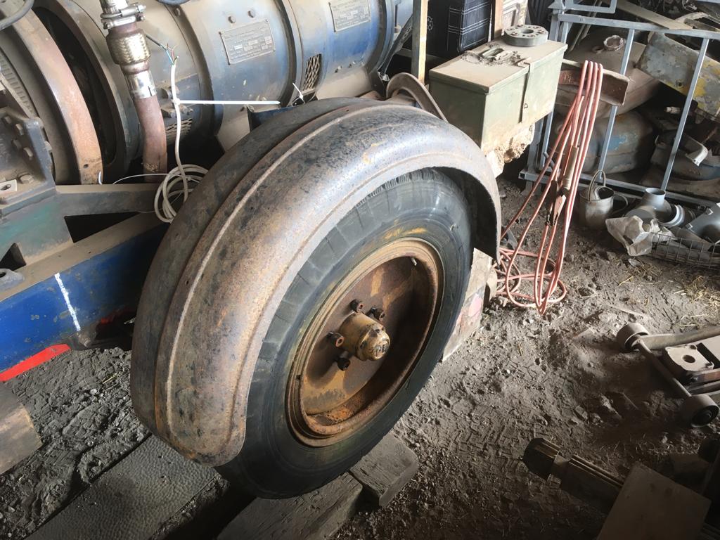

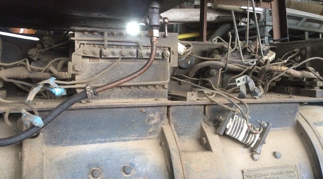

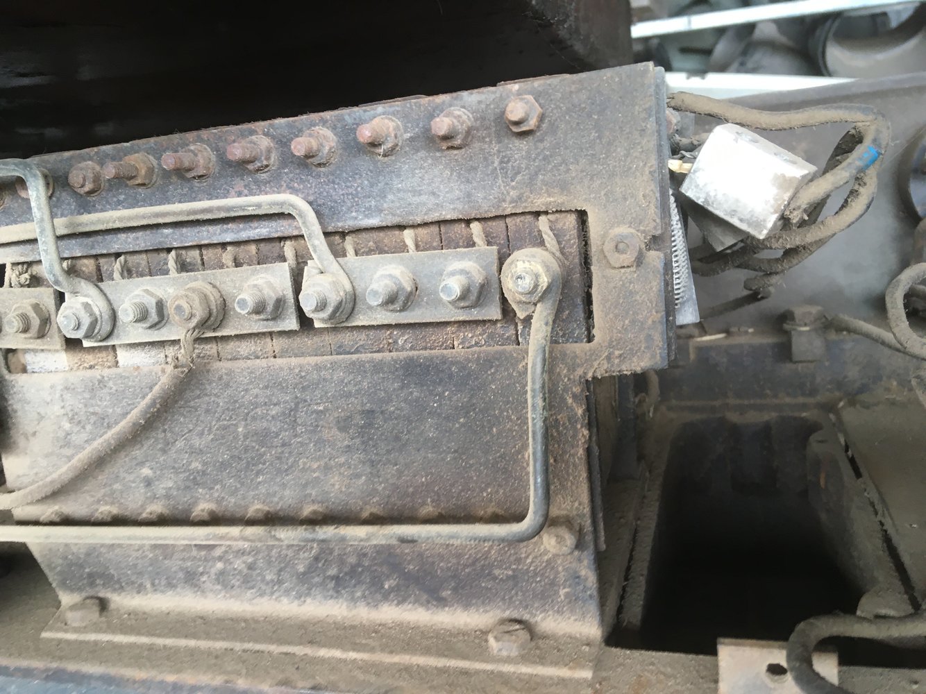

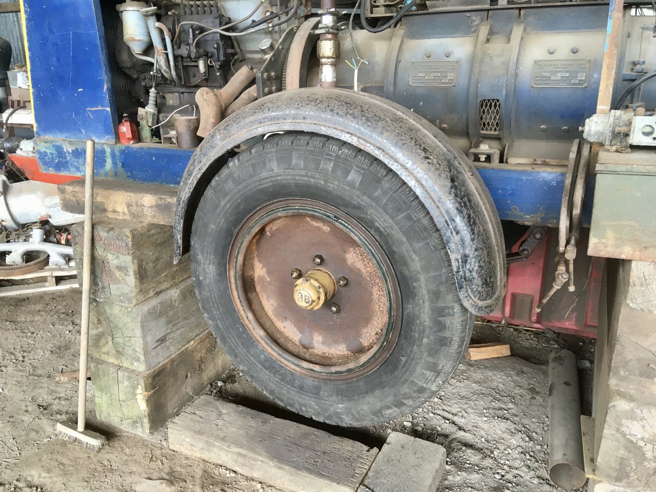

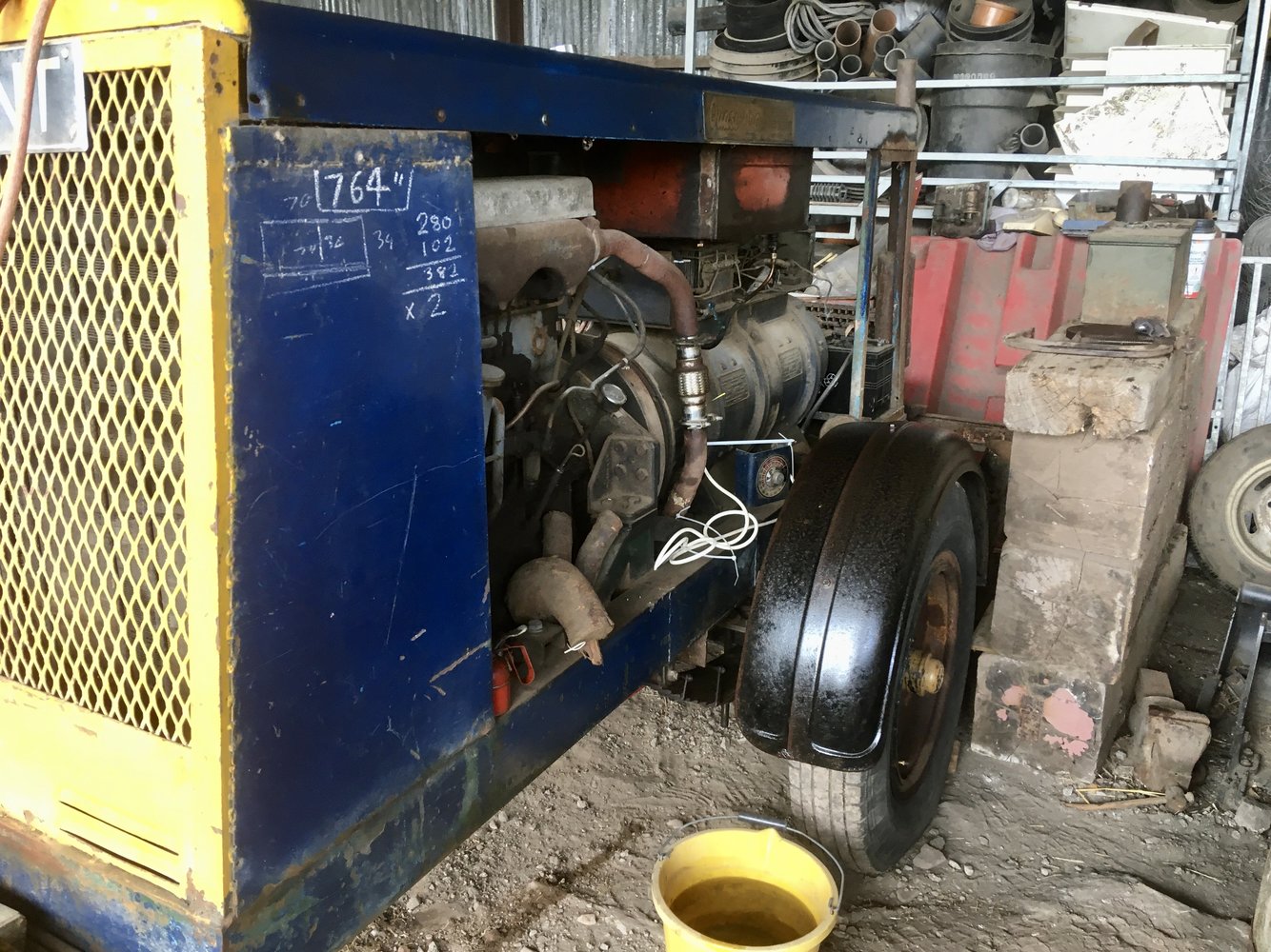

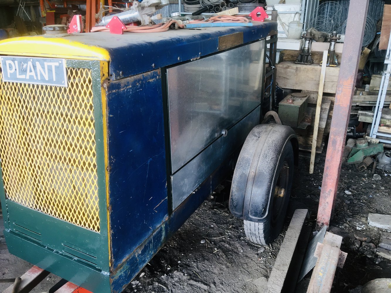

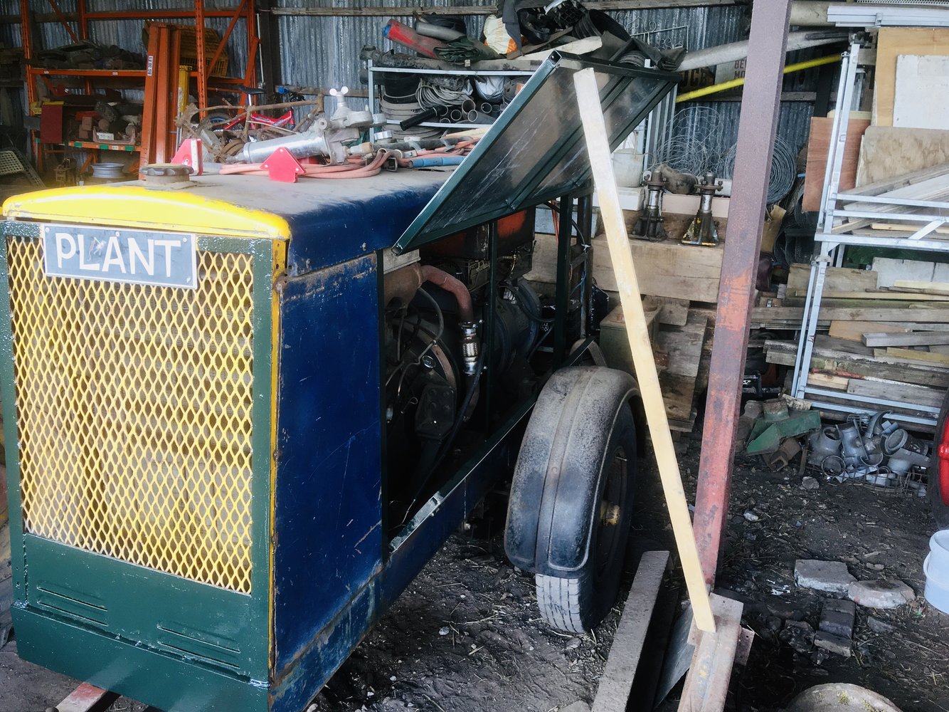

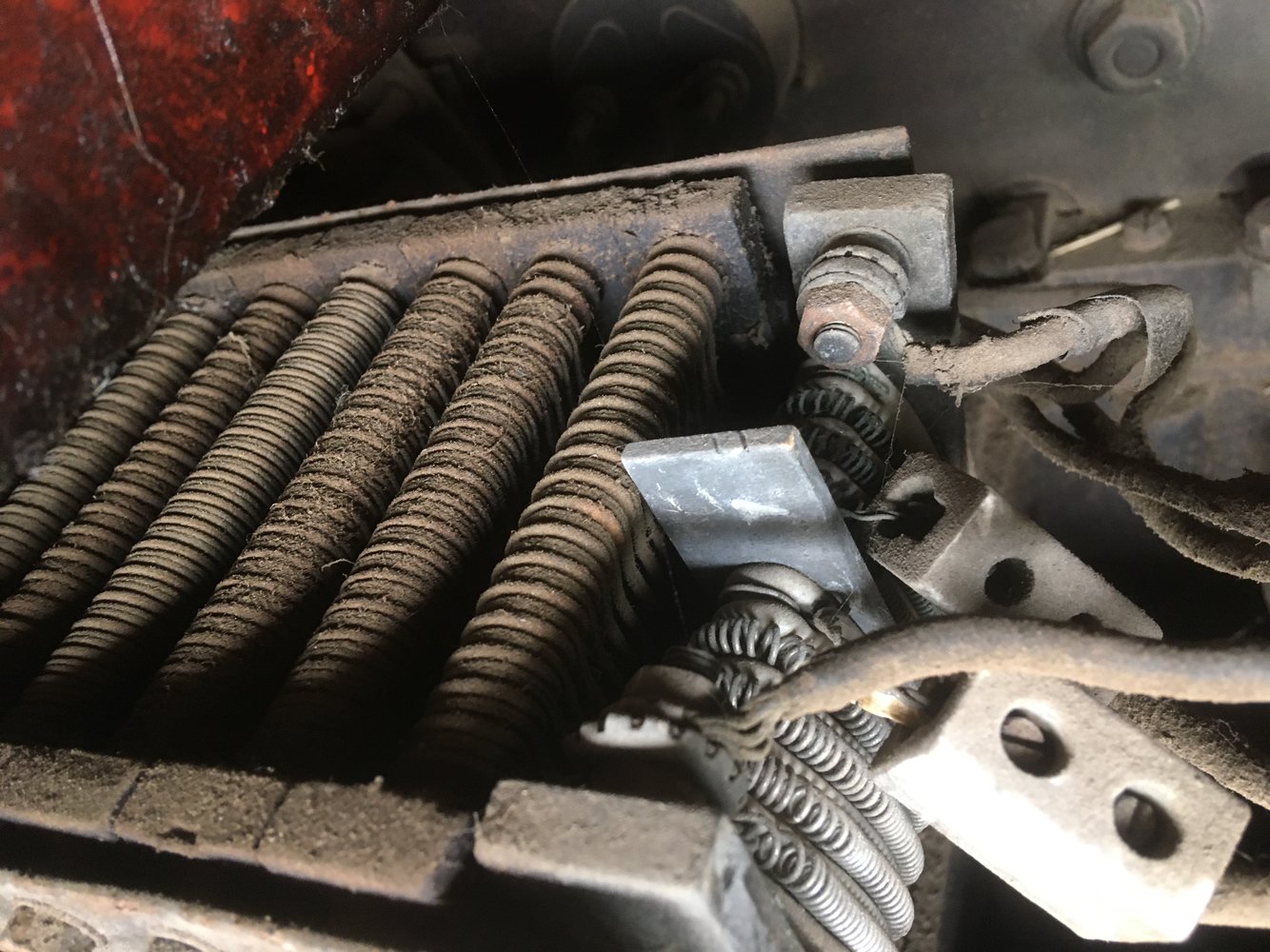

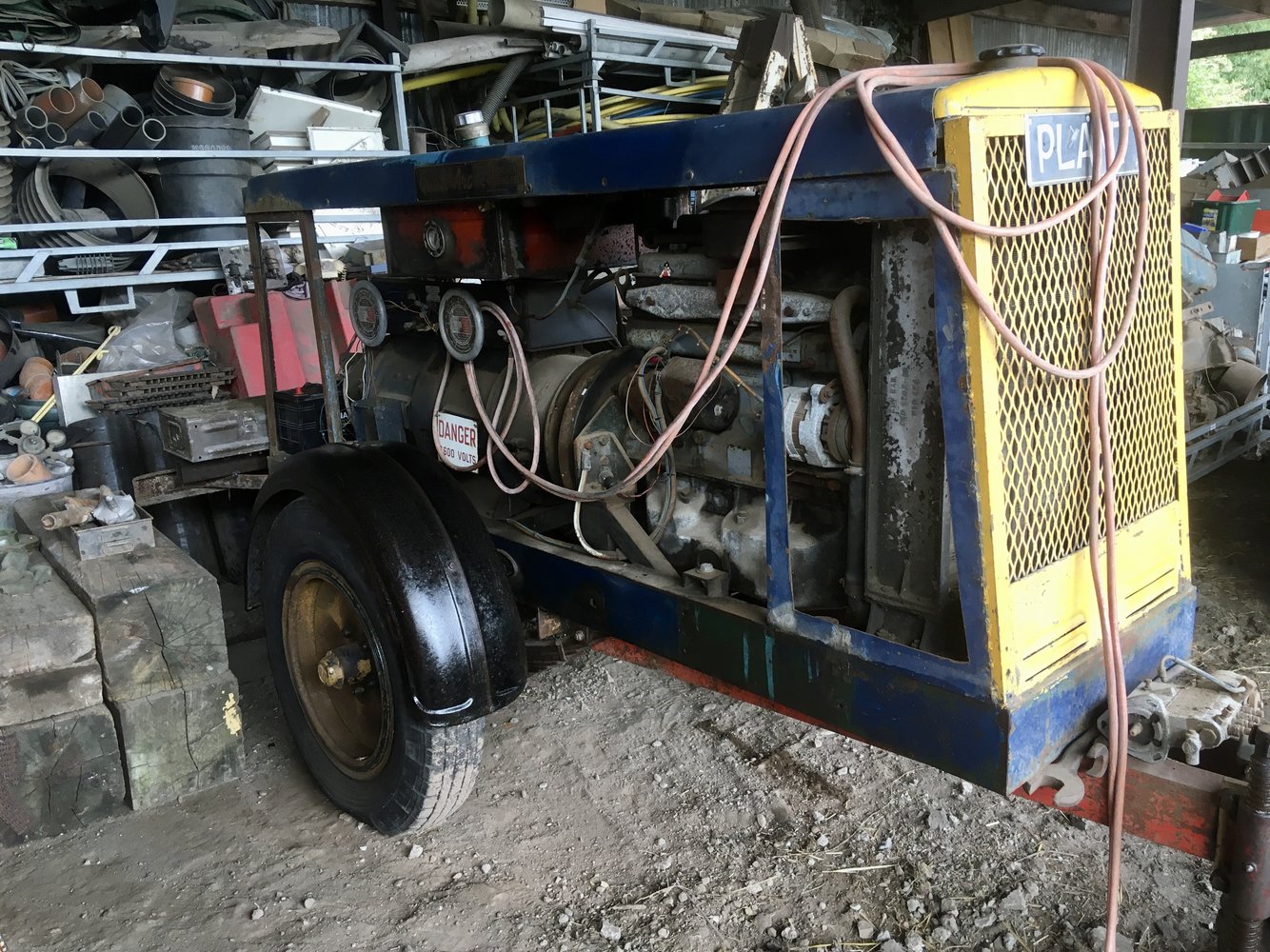

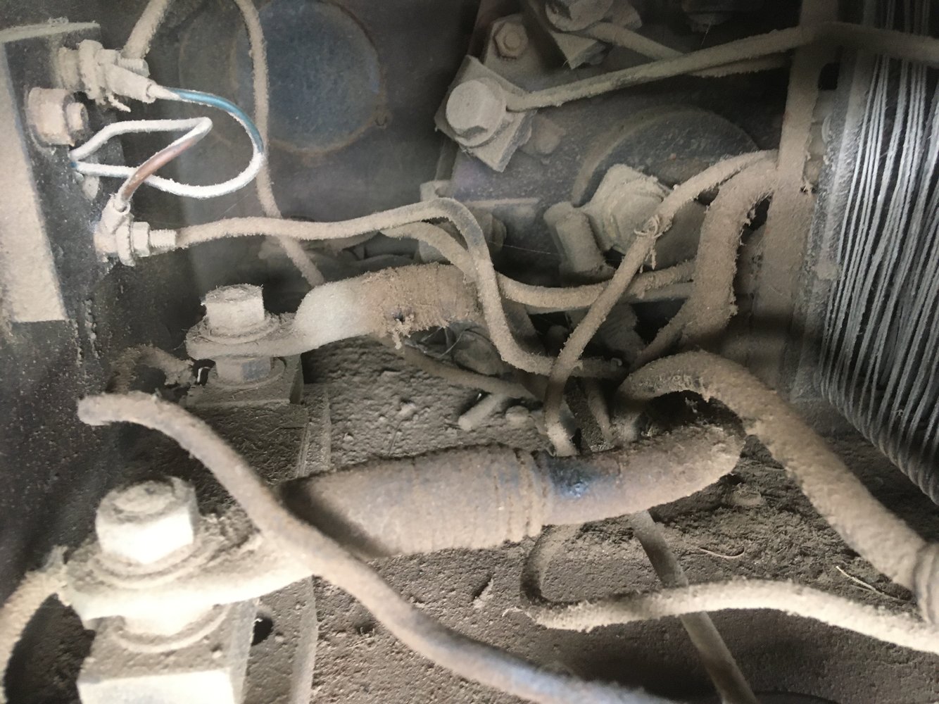

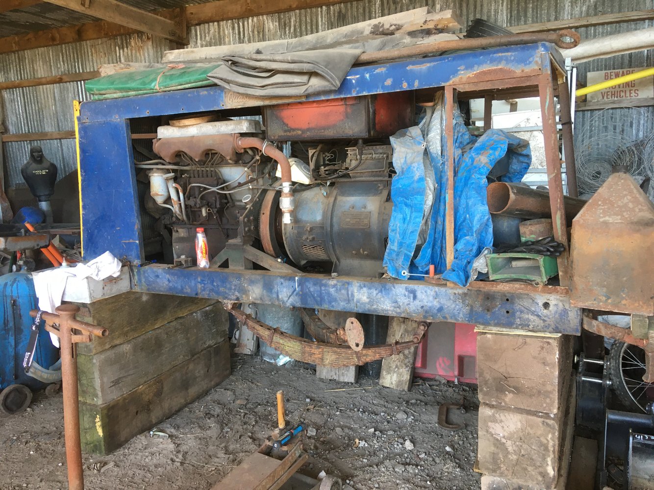

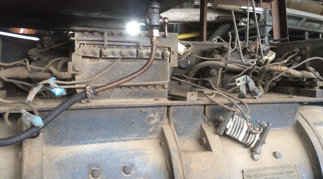

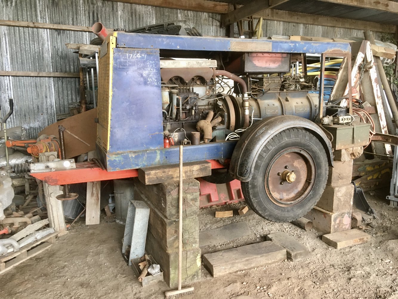

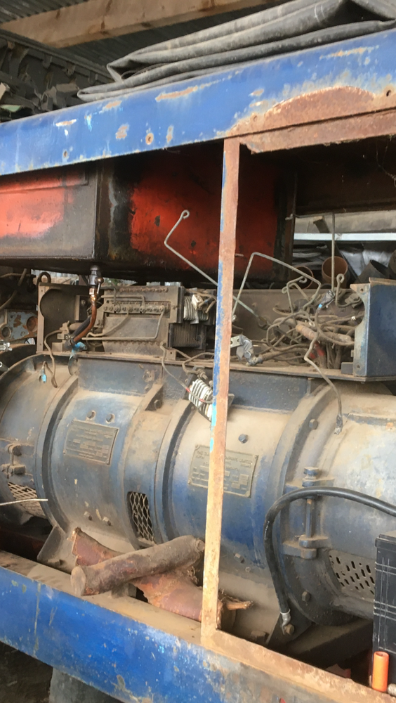

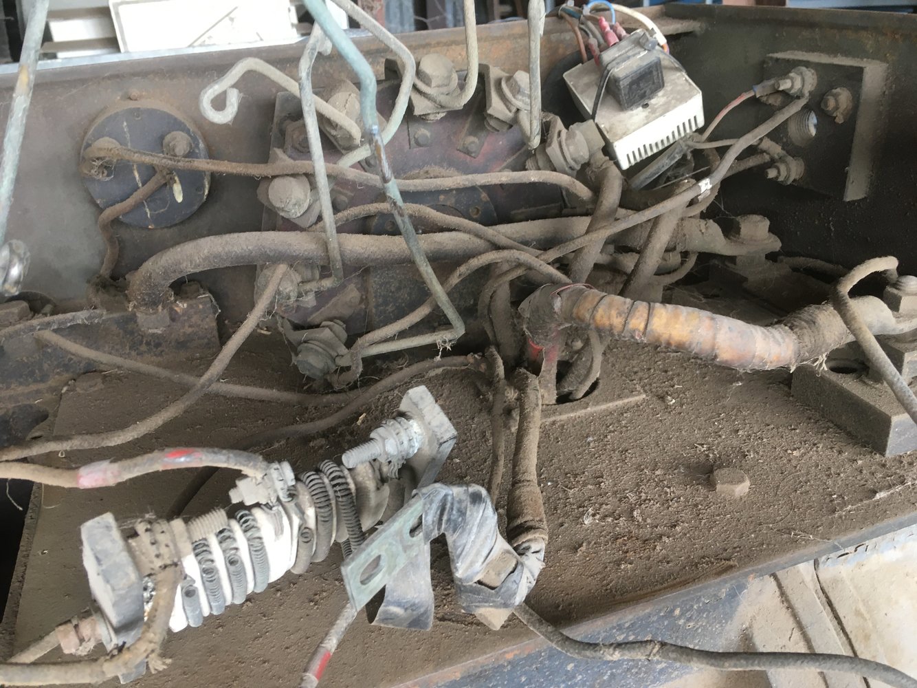

What regulator is on the 1st Welder, would it not be a duplicate of that? If so maybe you (or one of our experts on here) could build or remanufacture something.Can anyone advise on how to go about making a current regulator for the second welder ?
First one works fine but second one is missing as it gave up many years ago with a previous owner and was removed.
Output is 20 to 300 amps D.C.
I can get further pics if needed.
Any ideas welcome, even something modern that will fit in the box.
Cheers Chris.
View attachment 398912 View attachment 398913
Yes I would imagine it’s just a duplicate of the first, looks like a huge resistor pack, will get more pics later.What regulator is on the 1st Welder, would it not be a duplicate of that? If so maybe you (or one of our experts on here) could build or remanufacture something.
