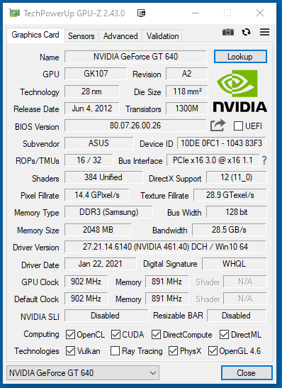

DVIIf your monitors don't support daisy chaining you need a "Multi-stream transport hub". It's only DP1.2 and higher which supports MST though, I can't tell if that's what your card has. For the price of a hub, I'd just get a new (Or second hand) GPU which already has multiple outputs.

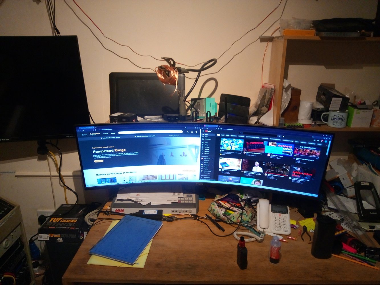

How are your current 24" displays connected?
