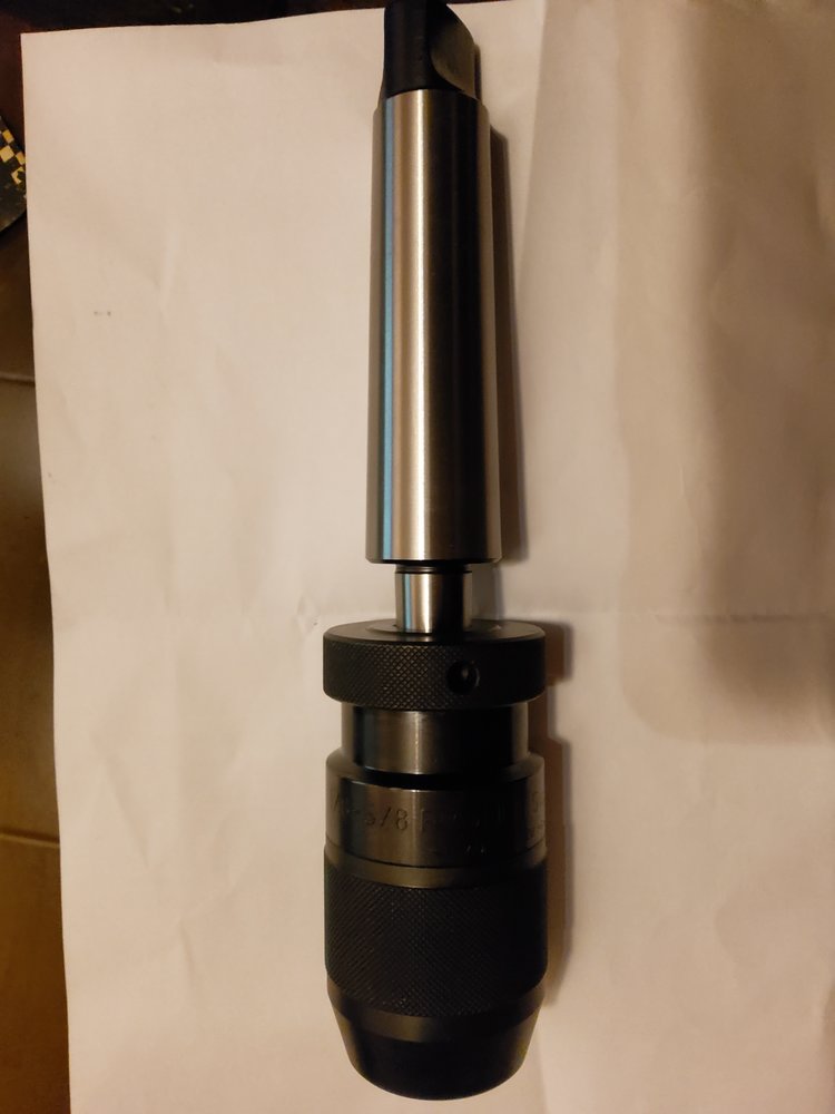

I ordered a new Röhm drill chuck and a new MT4/B18 arbor for my drill press.
Arrived today and I put the arbor in the chuck and it wouldn't go in far enough.
On closer examination I found that the chuck taper is B18VK (shortend taper). On the website it just stated B18 taper.
Can I use it like this or is that asking for trouble and do I really need a MT4/B18VK arbor?
