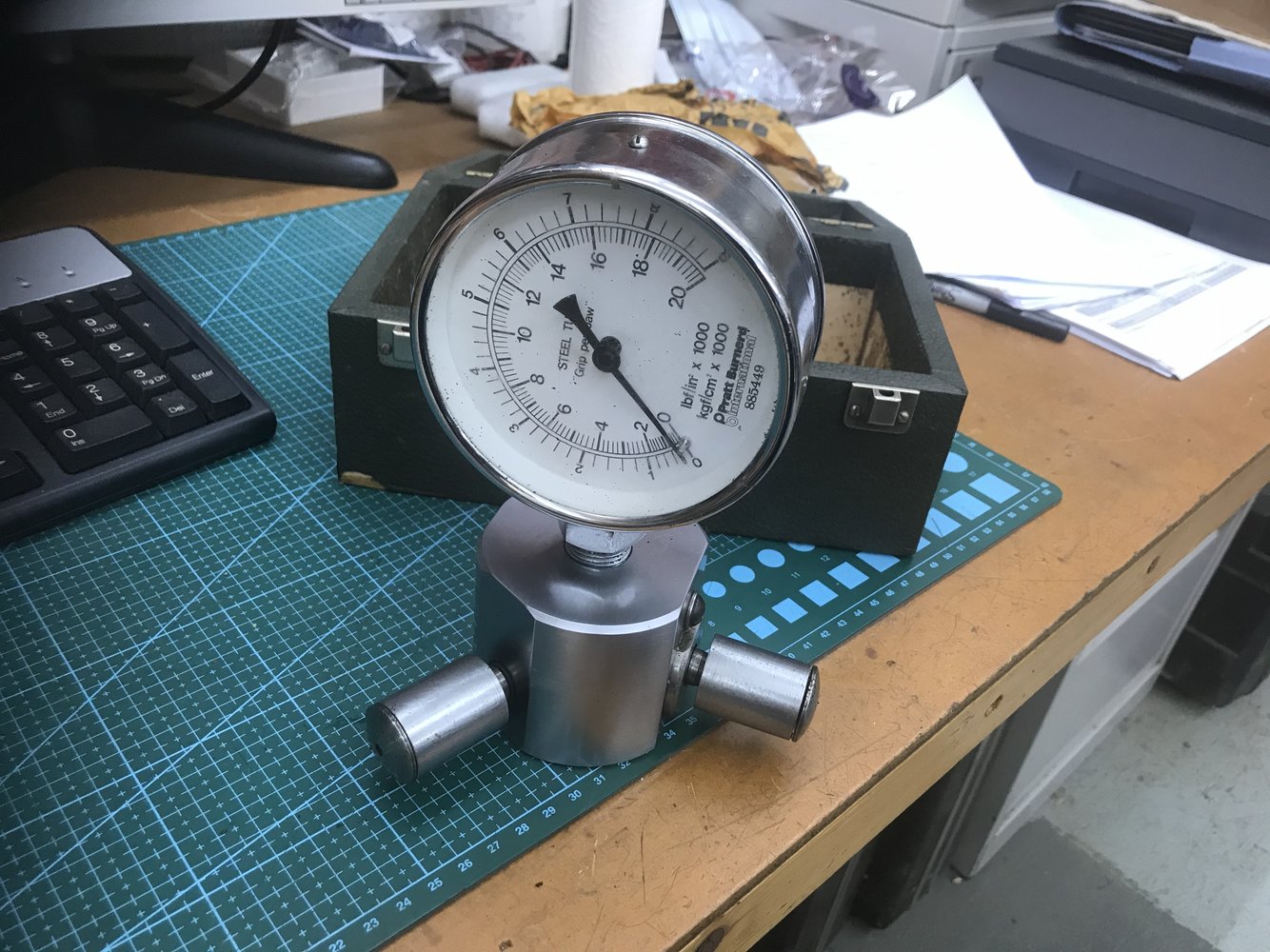

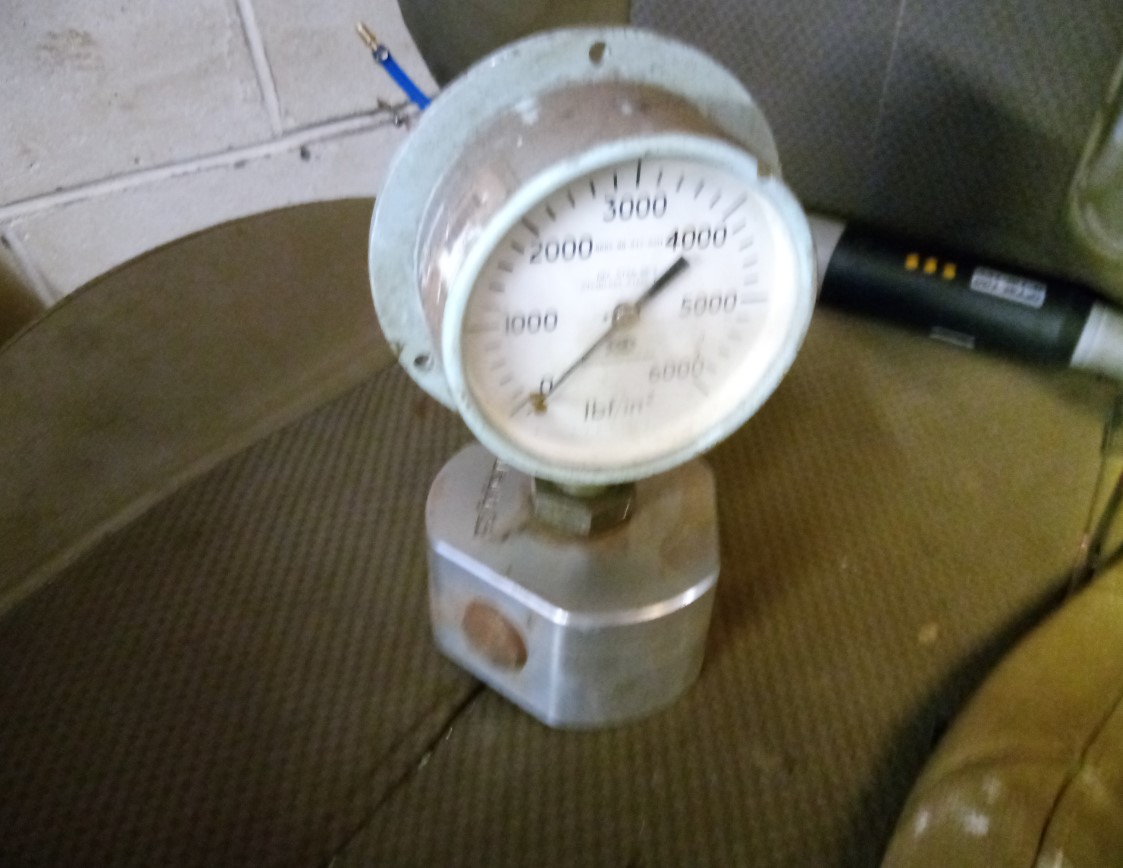

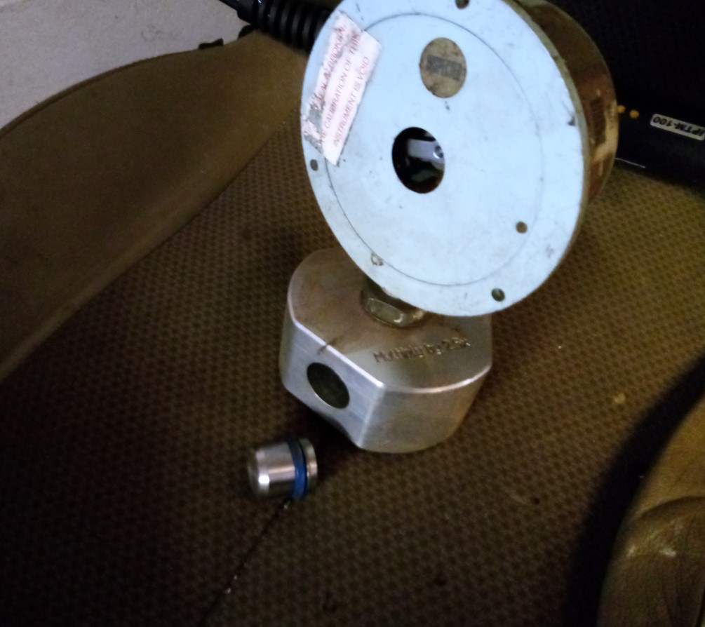

I suppose there are only a few ways it can be done. The downfall of mine is you have to be careful you don't compress two of the pistons as the other will pop out
Not sure I follow but maybe you are talking manual chuck? If so then these are used for setting or testing the clamping pressure of a hydraulic chuck.Why are there not torque settings for chucks Dia/fpm

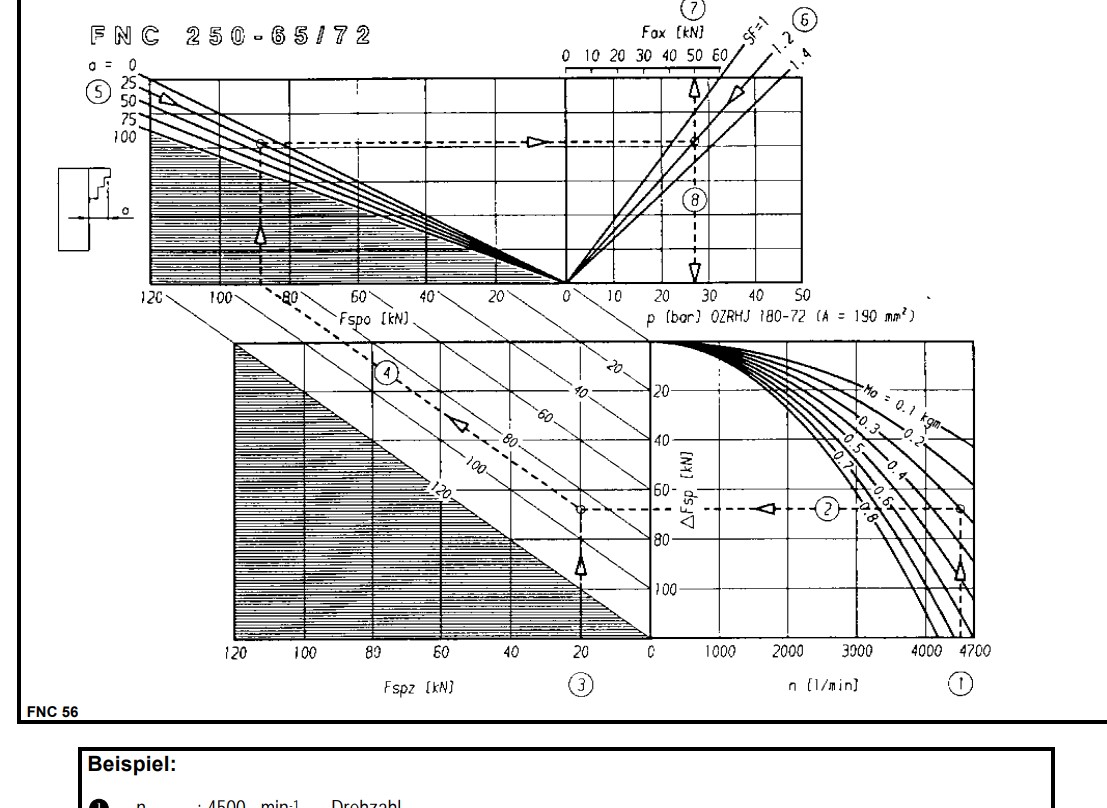

CF causes loose of grip. So..you would think there would be some calc to know what torque id required to stop the part from slipping. If you know the material, Diameter and spindle speedNot sure I follow but maybe you are talking manual chuck? If so then these are used for setting or testing the clamping pressure of a hydraulic chuck.
There are usually tables/graphs from the chuck makers that show that.CF causes loose of grip. So..you would think there would be some calc to know what torque id required to stop the part from slipping. If you know the material, Diameter and spindle speed
I can't of looked hard enough, the last time I bothered lookingThere are usually tables/graphs from the chuck makers that show that.
There were definitely tables in the Forkardt manual I had for the FNC chuck, can't recall how detailed they were, been a while.I can't of looked hard enough, the last time I bothered looking![]()
