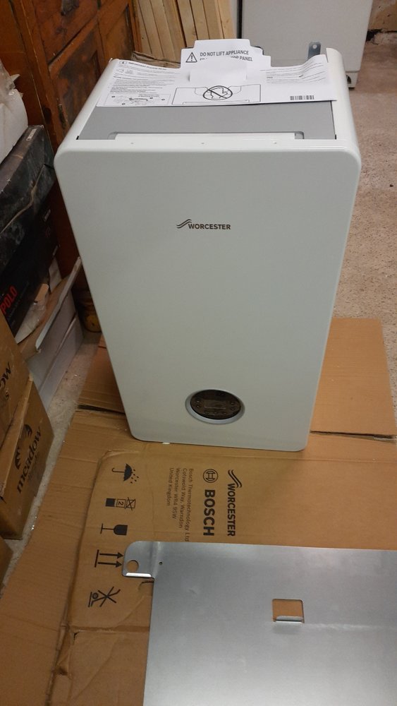

I have gone for the worcester bosch 8000 45kw as i know 3 of the local engineers and can call them direct and after 20 years of no boiler at all i want something with lots of hot water.
Yh its getting 28mm right up to the boilerThats gonna need one mahoosive gas pipe
It is about 6m from the meter but i have a commercial free standing cooker to go in at some.point so i can see an issue on the horizon.Depends on the length, 28mm might be overkill but it might not.
Last 50kw (2 x 25kw boilers) job had 6m of 35mm, 18m of 28mm and lastly 100mm of 22mm for packaging reasons. With both on full chat I had 0.9mb drop from the meter to the test point so could have done with another metre of 35mm, would have given us 0.5mb difference but was unable to fit it
