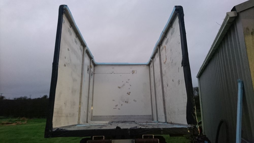

The sabre saw eats through these panels, it is superb. However its not very accurate, please see the pic below.
So now im worried - If i use the sabre saw im going to have some very large panels with no real straight edges.
Once the panels are off, is it possible to find a true 90 degrees within the panel, and if so, how?

snap a chalk line first: measure , recheck and measure again...snap your line, mark it with duct tape or similar then rough cut your panels...once on a flat surface, you cat cut to the tape/chalk line true.

A sabre saw wouldn't be my first choice for that job, they are very hard to keep in a straight line as you discovered plus the blade can wander off square through the panel.
A skil saw & a straight edge would get you a initial straight line then use a builders square to mark off that. Check the square before you use it, they are not always square when you buy them. On a large panel like that you can double check your right angle by marking a 3-4-5 triangle.

Personally I would dismantle rather than cut what is there....you can then simply measure off the preserved factory edge and use it to set your cut line (with suitable guide in place etc). I think once you lose the factory edge it gets quite difficult on a panel that large to get something spot on....a small error in the angle would throw you right out....you would be better off measuring the diagonals and making sure they are equal and set the angle perfectly that way.
guys thanks, exactly what i needed, different options, thanks. My dad has a laser level, im going to ask him would that be suitable for this application. @jpmillermatic I bought a clalk line during the week, ill mark it all with that before cutting. @Turbo good to hear about how actual professionals do it, thanks ) @Pigeon_Droppings2 dismantling will take too long, would be nice but if i put some work in after cutting hopefully I can get them pretty good. Will prob go at this today, off to get a decent breakfast into me and then launch into it.

The sabre saw is the fastest way to take the box apart. Will get good cuts later.
