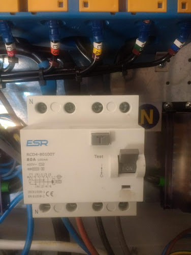

everything fed through rcd no freezers are allowed on a non rcd circuit as before marked dedicatedall luminaires fitted to be rcd protected . radial socket circuits have to have a 1,.5mm earth wire return at the end of line back to source double sockets have to have 2 earth connections and ring earth connected one each side not both together a bity more bumph coming along but not much on domestic
That's going to make pulling the cables in for a radial a lot more work
be a pig to sort out
just done a computer room out in a school 2 radial circuits wired in 2.5mm on 20 amp rcbo and put the return earth in I don't make it up I just follow it
