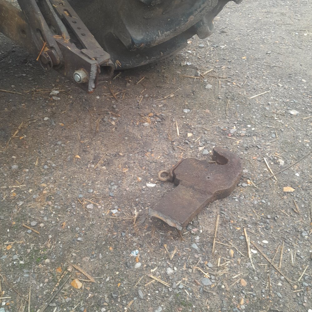

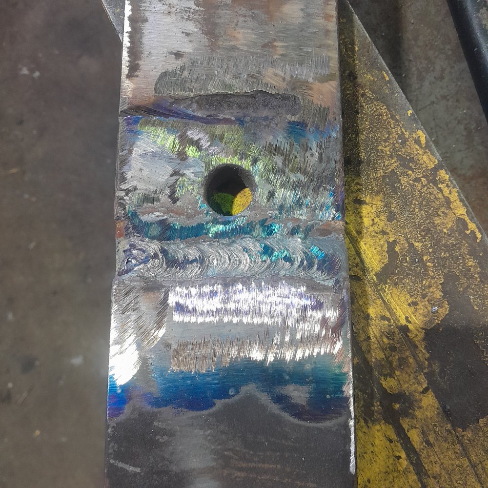

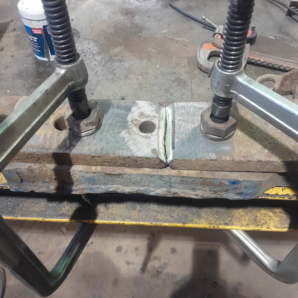

Couple of tacks itll be fine!Seen them bend but never snap.View attachment 517408
KubotaWhat tractor have seen it once before, an import from the far east
Bent sideways perhaps reversing against something. The stabiliser would stop the attached bit moving.I've seen it a couple times before.
Usually as the result of a combination of some implement that jams on the arms and stabilisers not set to prevent it swinging sideways.
They'll often hold up for a while afterwards before finally separating.
Typical farm usage/abuse.The other side was distorted badly as well they had a mower on at the time top link broke
They had arm fully out when it broke, mower was to big for machine as well as driving into tree
No it's a good 6" down from the welded on hook.You used to be able to buy just the end like that as a replacement to weld on if the ‘hook’ was worn. Maybe it broke at a previous weld?
with out acloser look but is it crystaline ? as in bad casting , either way you can buy new ends complete to weld on.
