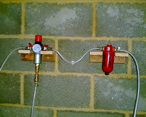

Look for a combined filter / regulator and a seperate oiler then you can have a dry air supply outlet between them and lubricated air after the oiler.
, the filter /reg the bottom connection should be the drain , the water collects in the bowl .
