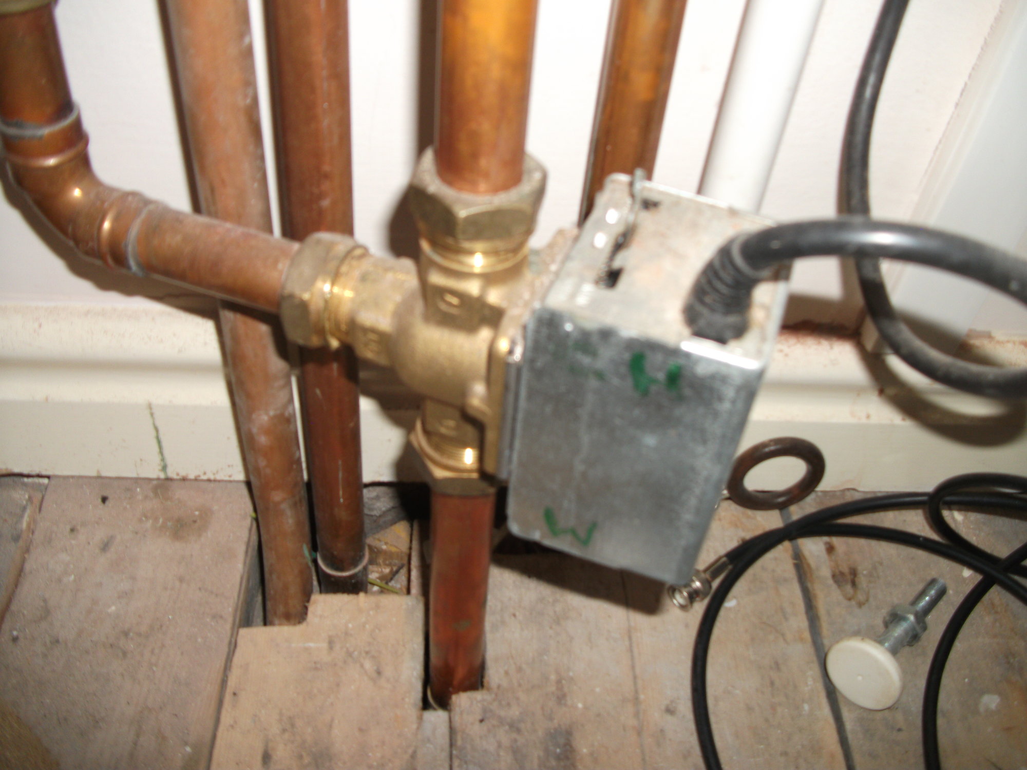

What's up with the valve. usually with those Myson valves the head goes faulty before the valve itself. the head is available as a spare part and if you don't want to go into the wiring centre you can use a Regin plug connector to join the new valve wiring to the old valve wiring (isolate first of course). undo the two screws that hold the head to the valve and just pull it off. if the valve is stuck, sometimes a wiggle with a pair of piers frees it off.
I have just fitted 2 for a punter on an s plan
today so he said dont worry i temp put a bowl under neath it to catch the water for a few days untill he better with luck
