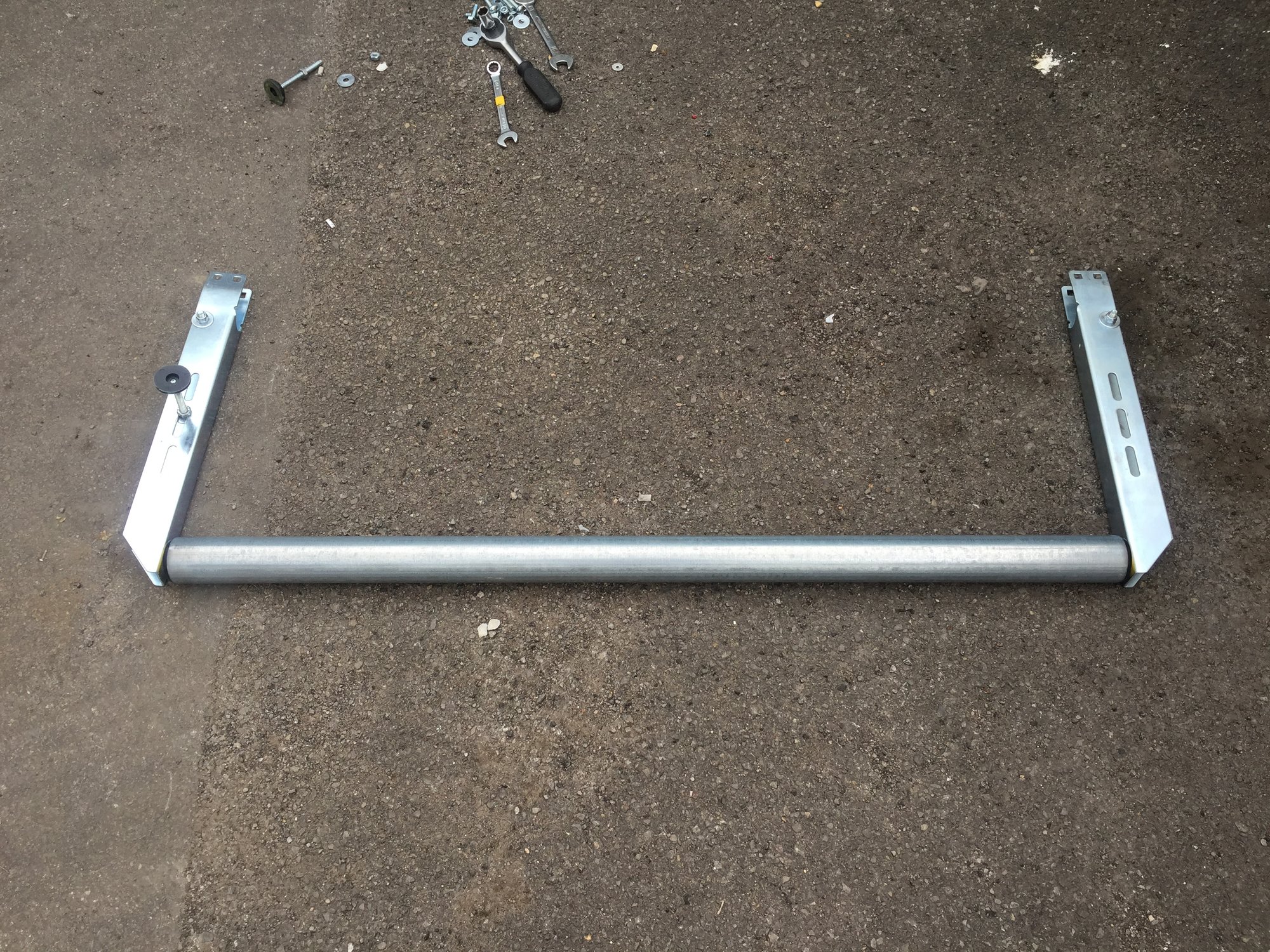

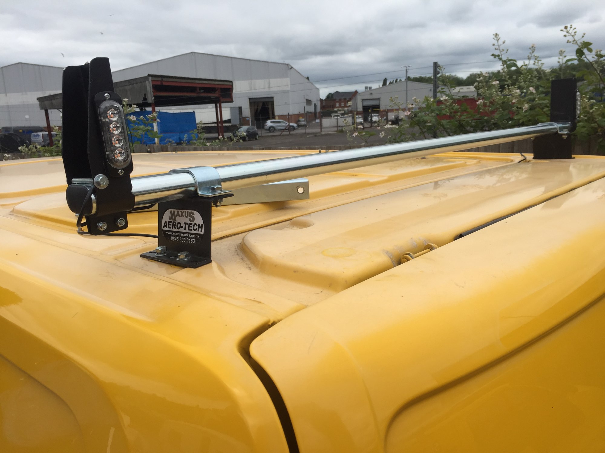

  1. We are trying to organise the ladder racks on the new Transit Custom. The rear rack has (and needs) a roller to allow the ladders to be held clear of the paintwork. Standard fit puts the roller at the top of the tailgate door and obstructs it. I have considered a number of ideas including a hinged roller, but the final solution is a sliding roller.
    Cutting it down was another option but then the ladder would hit the bodywork.
    I now need a couple of lengths of square section metal that another smaller section can slide inside of, something like an engine crane boom, with the same pin and R clip idea for setting in or out.
    Can someone suggest a couple of square section sizes that would do that nicely please? I anticipate the inner being something like a 1" square or maybe slightly larger. The roller is an 8mm bolt in each end, so that is the only critical dimension.

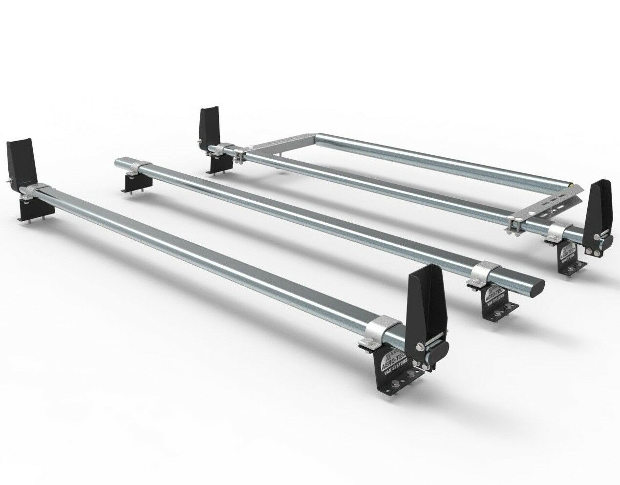

  2. This is the standard configuation of the roof bars, ideal for a barn door Transit but not the tailgate model.

    Put the roller on the front bar

    Would it be possible to mount the roller to the top of the rear door and not need to worry about someone not sliding the roller out of the way

    That would be my thought too. I bet someone doesn't put a ladder far enough forward at least once too :)

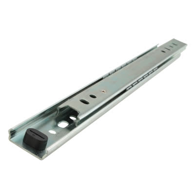

    How about some drawer runners bolted to vertical faces of current brackets that roller then bolts to? Need some way to lock them in position (R clip?)
    This sort of thing....

    Hi, What about seat runners as fitted to driver and passenger seats. They will take a fair weight and come with a locking mechanism?

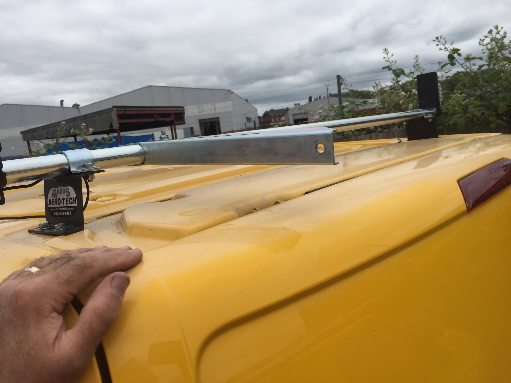

    Could you load from the side? Maybe a drop down/hinged slider, hook the ladders in, and push onto the roof?

    hook under the original roofrack but you need a lock for it to stay in place
    roller on end and roof support when loading
    remove and put it inside van
    otherwise you will need a bar under roofrack and above to support roller end
