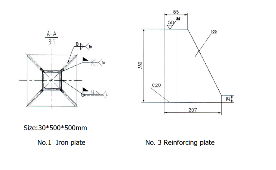

Z zaideh New Member Messages 1 Location belgium Jun 16, 2021 #1 Hi all , i am very new to the welding industry , and would like some help to read some welding illustrations that were handed over by a chinese manufacturer . would appreciate if someone can help
A Agroshield Member Messages 4,732 Jun 16, 2021 #2 I think the right hand drawing (No. 3) shows machining and surface finish symbols, not welding symbols. Put 'surface finish symbols' into Google and look at images. Similarly, for the weld symbols on the left side drawing (No. 1), put 'weld symbols' into Google and look at images. E.g. https://sites.google.com/site/stand...c-welding-symbols-their-location-significance Google Sites: Sign-in Access Google Sites with a personal Google account or Google Workspace account (for business use). sites.google.com
