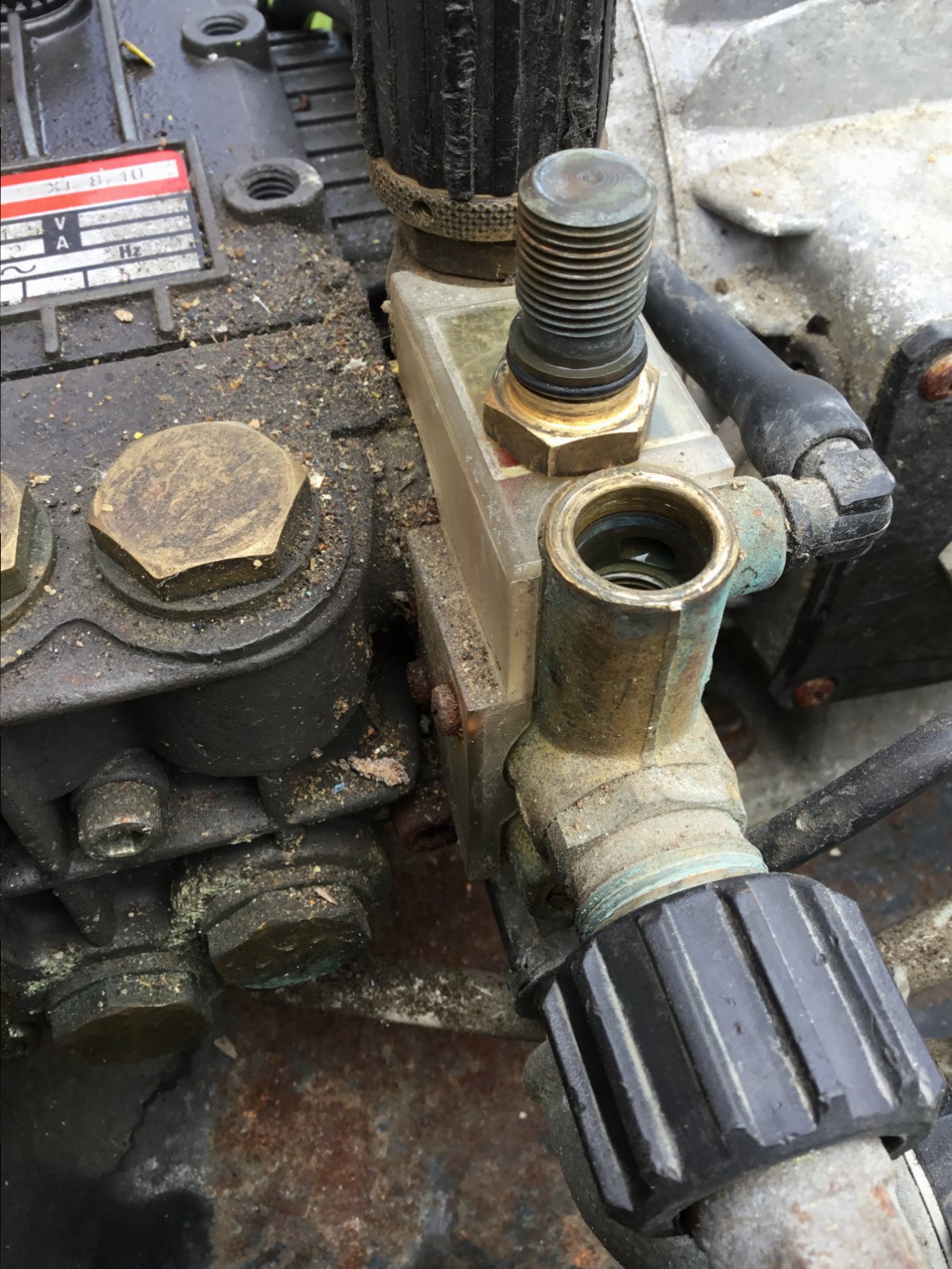

carbon Member Messages 3,035 Location S. Glos. U.K Apr 25, 2017 #41 Not seen that valve before so may not be detergent pick up. Could be a safety valve. What is under the nut on the top

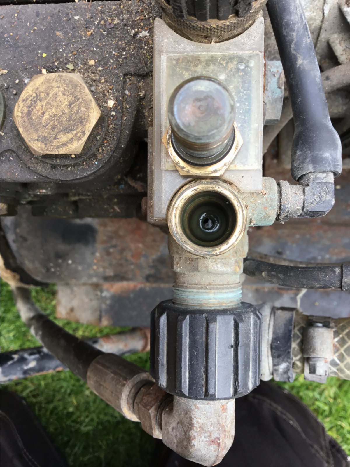

Shox Dr Chief Engineer to Carlos Fandango Messages 17,986 Location East Yorkshire Apr 28, 2017 #42 Cant see it been a blow off valve as it's currently blocked off with the brass 'bolt'. Not clear in pic, but you can just see the orifice at the bottom, with a small hole slightly offset
carbon Member Messages 3,035 Location S. Glos. U.K Apr 28, 2017 #43 Ok never seen a valve like that before. Looking at that not detergent pick up either
carbon Member Messages 3,035 Location S. Glos. U.K Apr 28, 2017 #44 Just had a quick look on phone and have found this could be detergent pickup, but some parts are missing from the one you have. Unloader valve
carbon Member Messages 3,035 Location S. Glos. U.K Apr 28, 2017 #45 It may have been replaced at some point and possibly the valve with detergent pickup was not available so just fitted the standard one. But just guessing on that part
Shox Dr Chief Engineer to Carlos Fandango Messages 17,986 Location East Yorkshire Apr 28, 2017 #46 carbon said: Just had a quick look on phone and have found this could be detergent pickup, but some parts are missing from the one you have. Unloader valve Click to expand... Thanks for that, looks like the adjustment assembly (#21 Detergent check valve ass) has either never been fitted or taken off
carbon Member Messages 3,035 Location S. Glos. U.K Apr 28, 2017 #47 U.K. Importer may not import that valve with the detergent control if it's not a popular item
Shox Dr Chief Engineer to Carlos Fandango Messages 17,986 Location East Yorkshire Apr 28, 2017 #48 carbon said: U.K. Importer may not import that valve with the detergent control if it's not a popular item Click to expand... Do you know who it is
