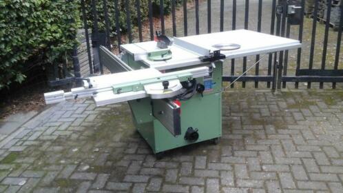

I have the same requirements and limitations as you do, and bougth this Elektra Beckum PK250Apologies if it comes across that way. I specifically asked about buying a table saw, and people are asking *what seems to me* silly questions; such as 'what do you mean by chopping wood'. Forgive my ignorance, but why else would I want a table saw? I really thought this would be a simple subject which didn't require minute detail.
The only requirements are that it does a good job of being a table saw, and that it's portable. It's going in my shed and has to battle for space with everything else. I'll be moving it out of the shed when I want to use it.
I'm not looking to build Noah's ark. It will be for occasional use where I need accuracy and repeatability across a range of sizes and shapes of wood. I may decide to build some furniture one day, but that's not currently within my skill level. At the moment I have some planks and battens which need to be cut to size at an angle and my circular saw isn't the right tool for the job. Hence I need a table saw.

Any machine - beyond the horrible cheapies with a folded sheet metal table will probably be okay for what you have listed above, tbh
The "crosscutting" issue is to determine if you need a sliding table, or whether a miter sledge would be enough (and thus if you'd need a miter slot).
It's basically cutting the short distance across a longer piece of timber - which can be dangerous on the wrong machine, but is also incredibly common especially when working with sheet materials.
"Dados" per-se aren't "illegal" - but adjustable width saw blades are much more expensive than "dado stacks" - which can't be used with braked motors.
A cheap machine can be made accurate - but not as easily as an expensive machine.
If I had £500 that I had to spend on a "portable" table saw, then I'd look for a second hand Milwaukee M18, simply because I already have batteries/chargers.
For a corded one: DeWalt, or an older Elu (who were bought by DeWalt) are my "go-to" brands.
I have a Whitehead junior which is "almost/just" portable - it has a tilting table, rather than a tilting blade, but is very accurate and powerful (it's belt driven, and i changed the motor for a 2.2kW/3HP)
If you can live with "not portable", then you can sometimes stumble on a wadkin within your budget - or double your budget, and buy a Lumberjack for around £1100.
Me personally, I'd recommend spending _30-50 on a 2nd hand Sip/Clarke/draper 10" / 250mm saw. Make a better fence for it.
Use it for a year or two until you get a better idea of what features you and the uses you'll put it to.
I do think the big name stuff in you budget are necessarily going to be much better, to be honest.

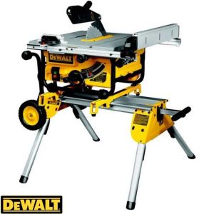

I'll be using it for DIY. Portable in the sense that it's not too large or heavy, and can be carried out of the shed and set up in the garden.
I've just bought this setup:
Dewalt DW745 Portable Table Saw + Stand DE7400 240V
Dewalt DW745RS Heavy Duty Lightweight Table Saw, complete with 24 tooth saw blade, mitre fence, 2 blade spanners, parallel fence, dust port reducer, push stick and DE7400 Leg Stand Features DW745 Table Saw 22 kg unit weight and optimised footprint make this the most portable saw in its class...www.ukplanettools.co.uk
I'd rather not be left wanting or wishing I'd bought something better to begin with. Do it once, do it properly.
