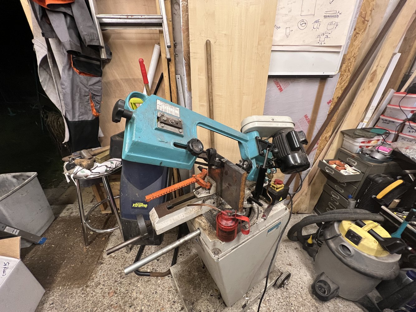

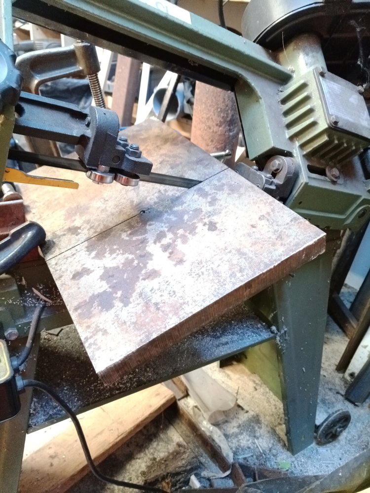

9" grinder would be quickerLump of 1" thick plate 9" wide needed cutting. Am I overdoing it on my 6" bandsaw. Oh well, love a lashup, so went for it.View attachment 379036

not a problem if they have steel wheels some of the cheap ones may suffer and not suitableIf you lubricate the blade of a bandsaw how do you prevent the driving wheel slipping?
I tried a few drops of cutting oil on my newly acquired Lidl one and had to disassemble and clean it to get it to cut again!
I can understand using lubrication on a hacksaw or 'donkey' saw but a bandsaw??
)"My little Lidl one has 'rubber' tyres on the wheels so that may explain it.not a problem if they have steel wheels some of the cheap ones may suffer and not suitable![]()

I’m thinking about a small compressor and nozzle on the cut - to blow the swarf away and cool the blade?I bought a 6 inch bandsaw years ago.
It wouldn't cut straight and kept throwing blades.
After getting advice on here I stopped using any oil and cleaned up the rubber on the wheels and it hasn't missed a beat since.
Last blades I bought were M42s from "Mr Bandsaw" and they have lasted far longer that the M42s I used to buy from "Tuff Saw"
The difference is in the quality of the joint, the Tuff Saw ones always strip teeth from the joint, the Mr Band Saw ones wear out.
Both are able to cut rail track with ease.
I'm sure both flavours would last longer with oil, but since I can't use oil, I can live with the reduction in performance.
When I tried a tiny bit of paste cutting compound or a drop of oil it will eventually throw a blade and stuff it, so it's a false economy for me.
My Startrite has one - called a chip blower I think. More for clearing the debris away than cooling.I’m thinking about a small compressor and nozzle on the cut - to blow the swarf away and cool the blade?
