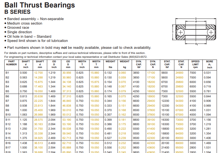

Seadog Save the planet. It's the only one with rum! Messages 13,065 Location NE London - UK Jun 23, 2020 #21 How about the INA B12?
Brad93 Member Messages 19,430 Location Essex, United Kingdom Jun 23, 2020 #22 Seadog said: How about the INA B12? View attachment 237578 Click to expand... All a bit too wide. I’ve only got 7/16” to play with. I’ll just about get away with 12mm.
pressbrake1 Member Messages 5,776 Location Essex Jun 23, 2020 #23 You can reduce race thickness on a surface grinder
