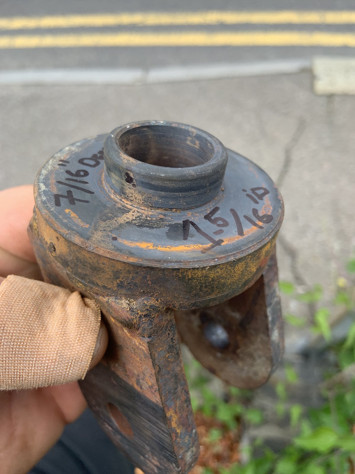

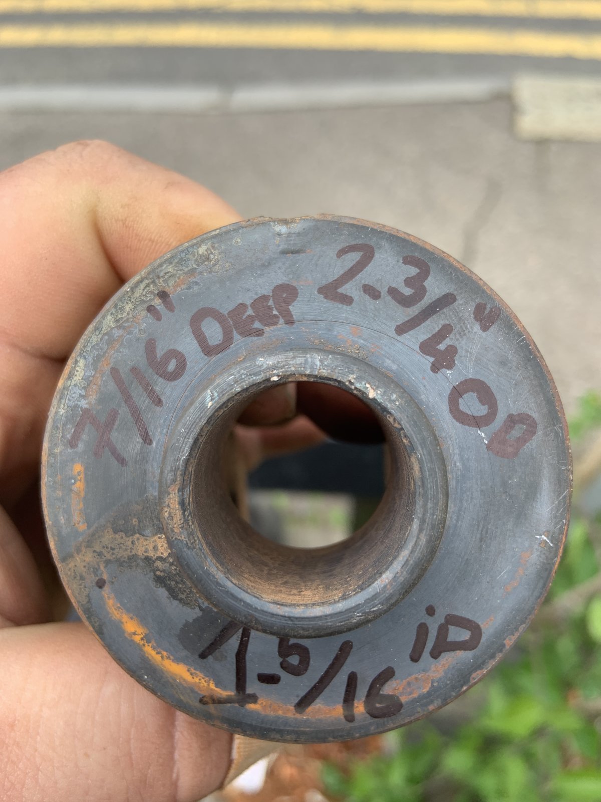

Stupidly I didn’t take pictures of what I took off because it was greasy and rusty as hell, and I had to burn off the studs holding the castors.
These castors are to an EPCO 5T trolley jack.
they had like a pressed plate forming a groove, then loose balls of around 8mm diameter, then another pressed plate with a groove.
I’ve tried J&M Belts and bearings with no joy.

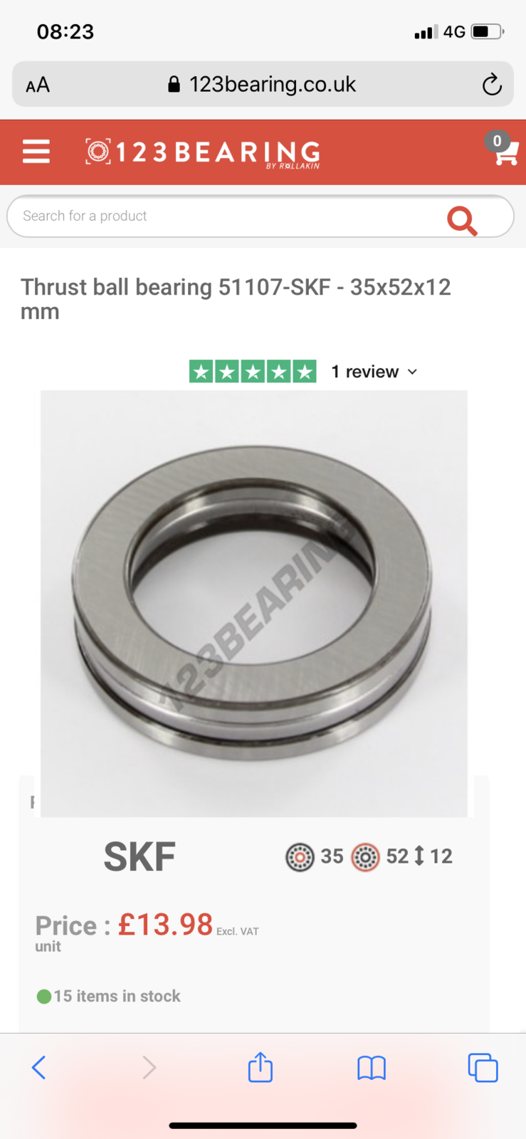

Needs to be a thrust bearing and obviously I can turn any adaptor or bush to suit.
any help?
