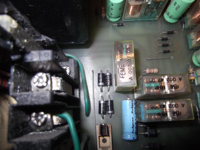

In "diode" test mode it should not show as dead short if meter is anything like my diode test function (fluke meter) you should see (as some of the diodes have) 0.60 to 0.50.... ish. 0 is a dead short diode which is duff. Asthe four diodes look to be same types you should get same readings from each. Note readings will as you realise be different depending which way round your test leads are.
