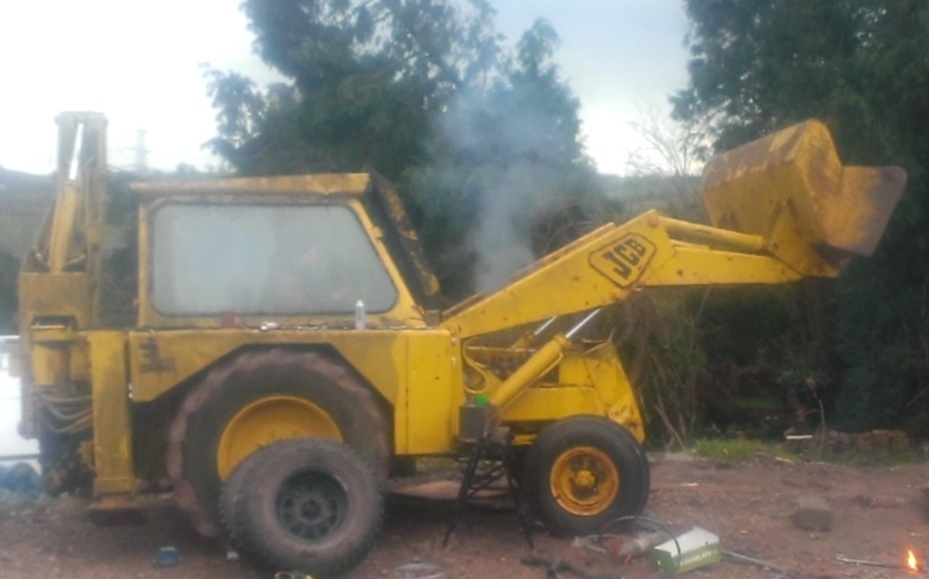

I start mine with a sniff of easystart out a aerosol, but thats because I already know its knackered and why. Otherwise it will start dead cold but it takes a age and chuffs white smoke for a bit building up enough heat to diesel properly and catch so a quick whiff is kinder on the starter and stuff.

Sounds similar to how mine looked inside when I lifted the head.piccy is of same model / diffrent machene it's one a mate had couple of yrs ago ( nd its tidyer ) but with all same symptoms but is about how knackerd this one is, that engine clatterd about 2 clock hours later we later re engined that one
