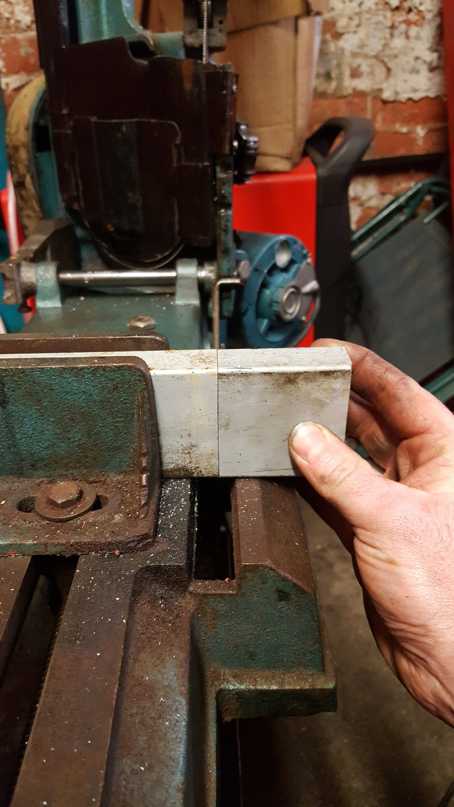

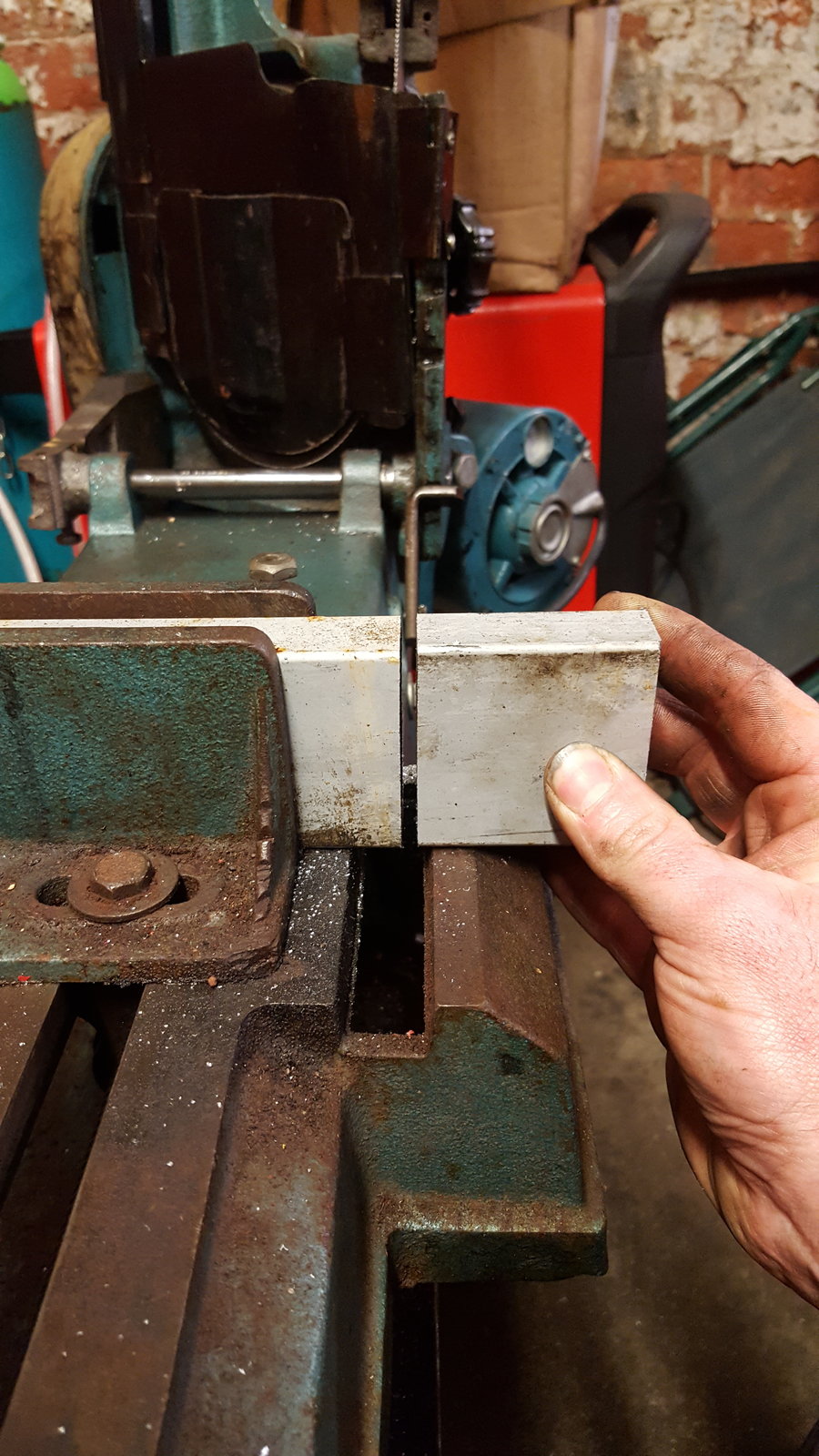

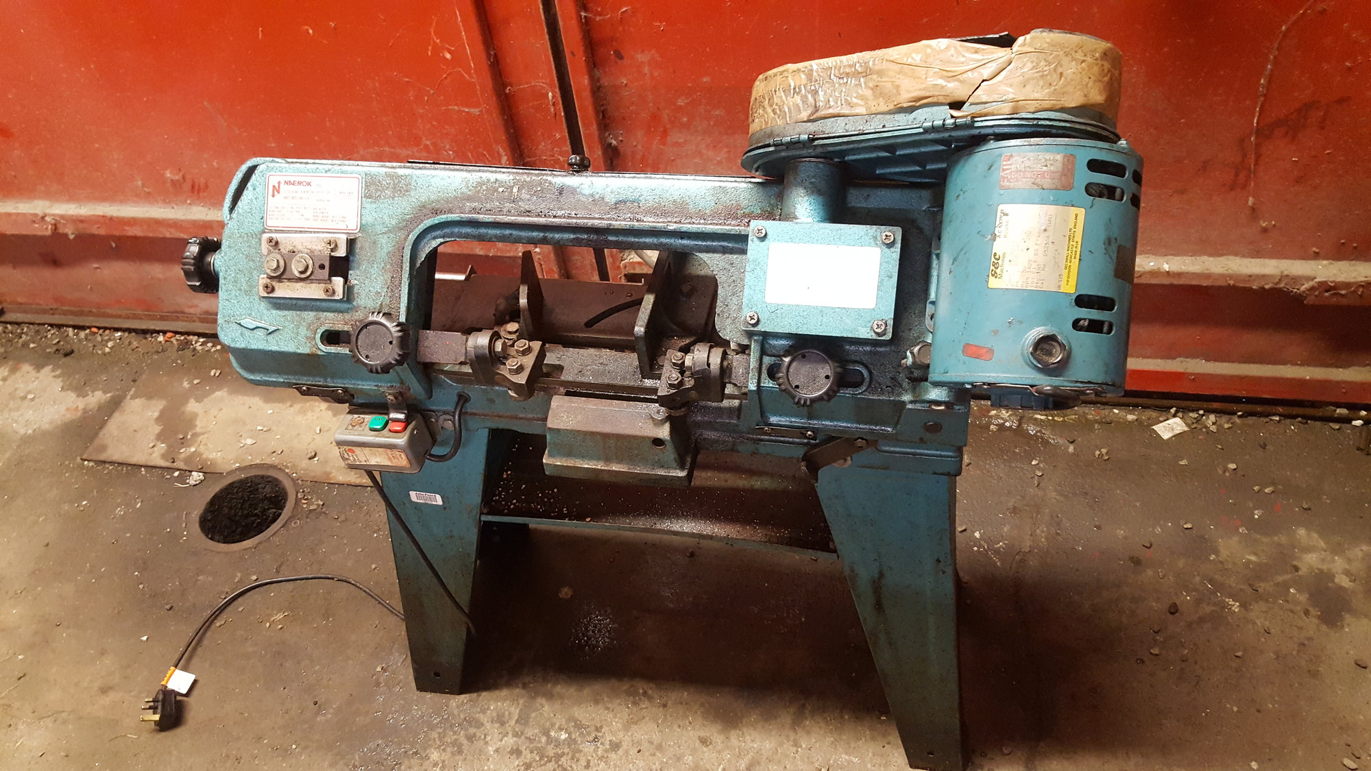

I have bought this bandsaw and it works as it should
I have changed the belt as it was slipping, put on a fresh saw blade and changed the blade guide bearings as the previous ower had the adjuster arm pulled right out so it was resting on the body of the saw and were very worn. Fetled with it so i now get a straight cut.
Now all it is missing is the tension spring which will be the same as the clarke bandsaw. Does anyone know where i can get one? Simply speak to machine mart? Or i do have an old spring of my kids old trampoline will that work?
