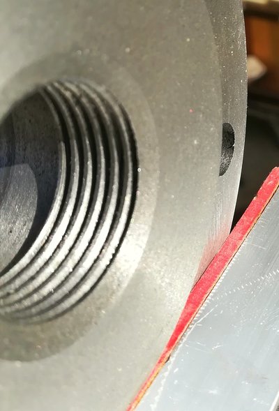

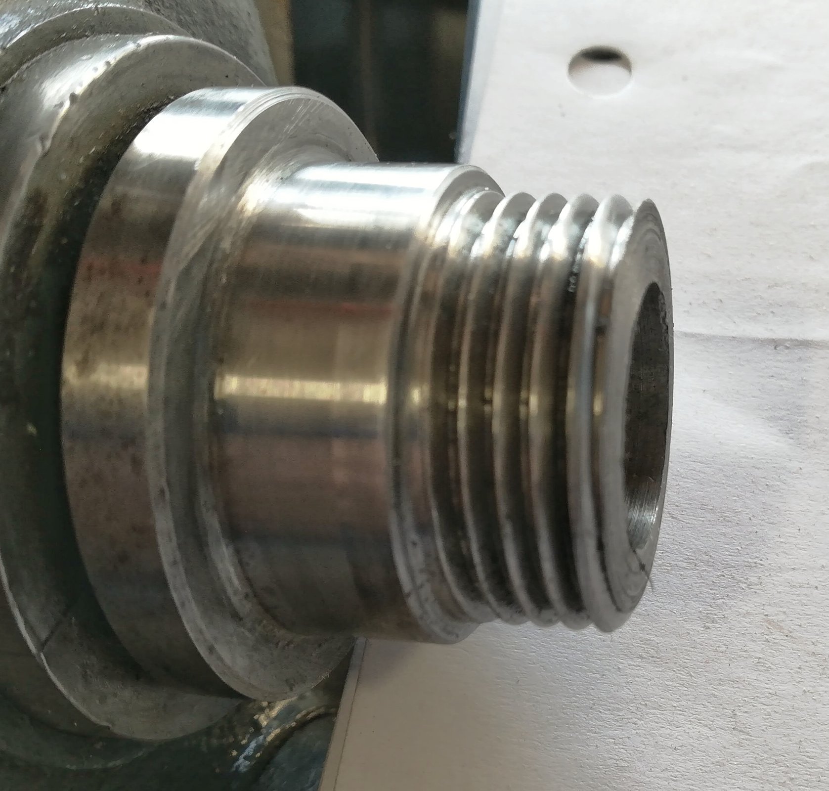

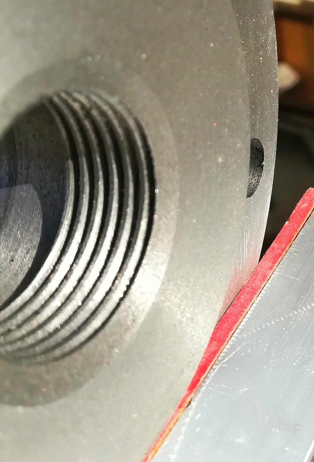

It's a 2 hr drive but I canoe down there so no real issue. Just not aloud to do non essential trips currently with COVID 19. My thread is 1 1/8x12tpi.
Thanks, I've got it sorted, see my post.You're welcome to call & check the new backplate on my lathe (once the restrictions are lifted). But I can't see that being any help as your lathe will have the same spindle nose thread as mine, all ML7's were the same. I think the problem is that the supplied backplate has either been incorrectly machined or they sent the wrong one.
As others have said, get shirty with RDG or get your credit card company involved, you were supplied incorrect or defective goods.
