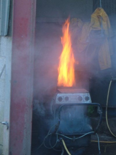

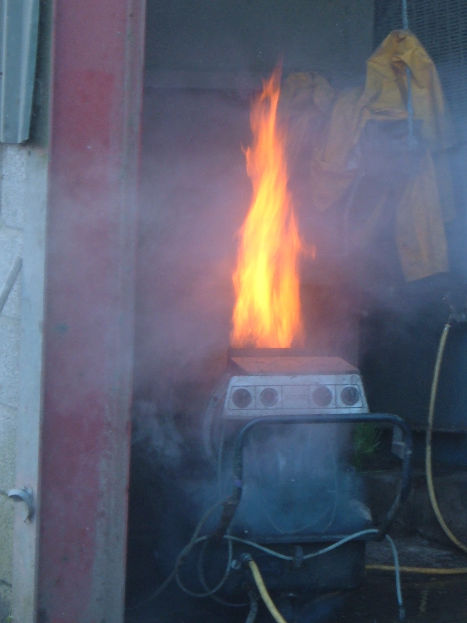

also worth checking the flow switch as it will be that, that starts the timer offCheck for mains voltage between terminal 14 on the main contactor and neutral. If that's ok check for voltage across the primary of the ign coil. if theres no voltage there then the filter z3 may have failed.
