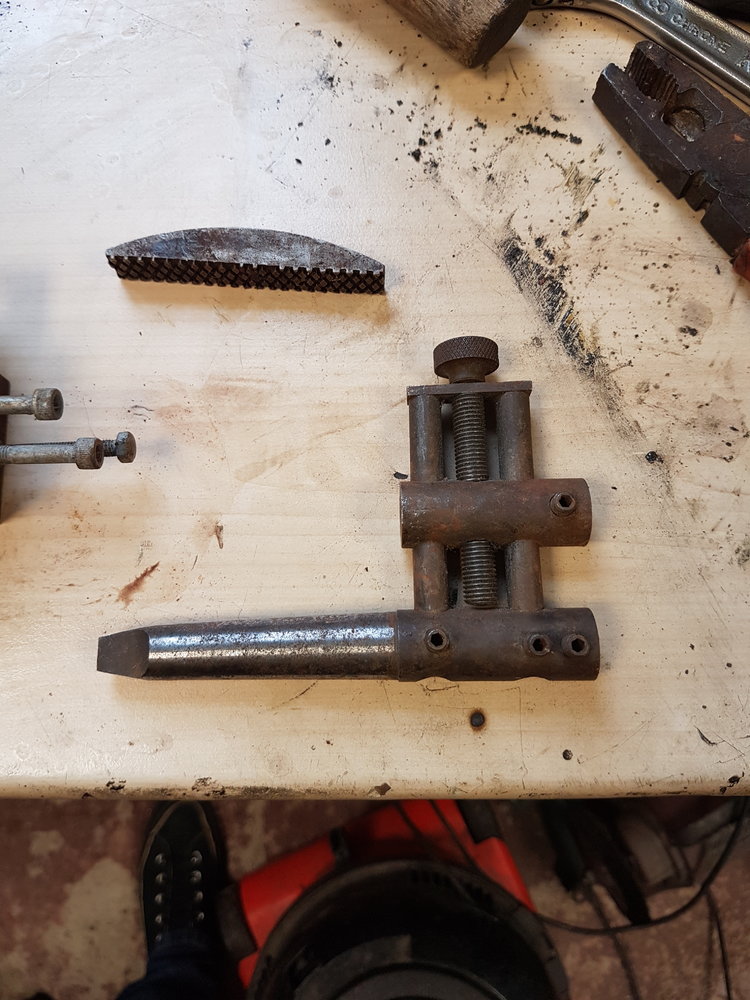

Yep, that could work.I'd guess as the MT2 thing being a fly cutter, possibly for use in a pillar drill rather than a lathe.
I'm good at them!A pilot bit then a guide in the centre hole and the cutter in the other. Round holes are easier to make at home than square ones. Oversized trilobular are even easier, especially in thin sheet metal.
I think your right. And you can get them for tailstocks. This looks a little light duty though.I'd say the more taper one is a trepanning tool (circular hole cutter), rather than a flycutter, as you'd need a threaded shaft for a flycutter.
Ah, I have a lantern tool post in this job lot.The first thing is from a lantern toolpost. The tool sits atop it within the post.
Second probably is a stop, as you guess.
It will rotate, once it's been in the citric a while!Yes, the semi circular one looks like a boat from a tool holder.
Other one at the top does look like a stop especially if the knurled part allow you to rotate the bolts round.

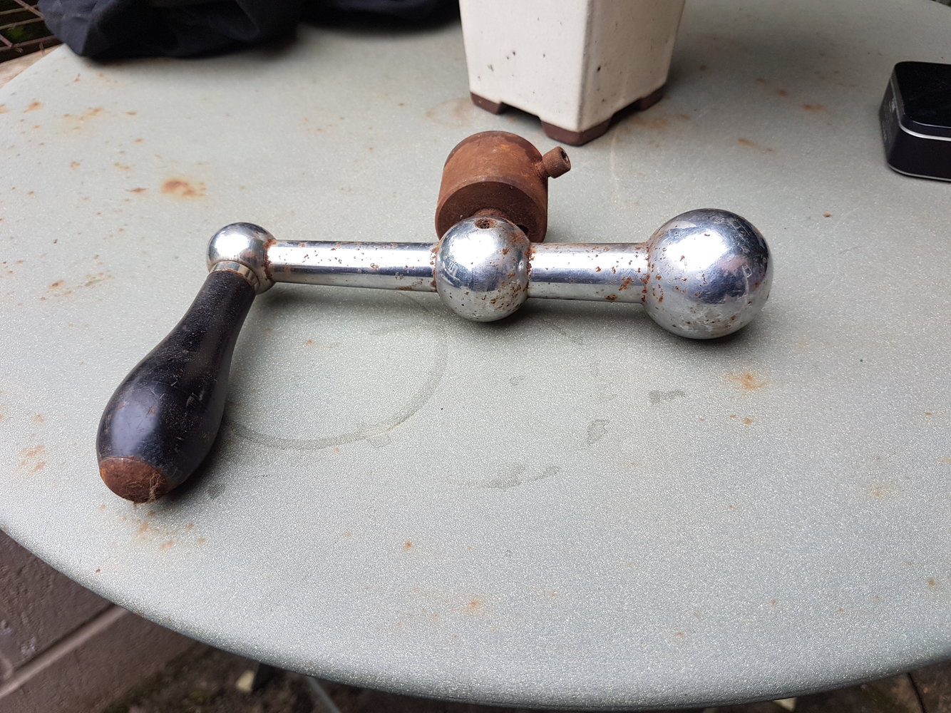

The handle looks original. Has a chrome base, it's plastic, not wood, and doesn't seem to be removable.Handle looks like the style that mills usually have, the wooden handle may not be original as normally they were chromed steel similar to the rest of it.
It looks very much like the lantern tool post clamp bridge that I have for my ancient circa 1942 Sphere lathe . I've kept the lamp post and bridge , but put a type two QCTP on it as it is much more stable as well as change over and start cutting again in a few seconds with no alignment needed . Once the tool holders are set they are good to go till the cutter gets re sharpened then it's a recheck for alignment and if needed , a micro adjustment for optimum cutting again .Ah, I have a lantern tool post in this job lot.

Yes, I wondered what for, but I think its home made.
It doesn't feel bakelite. Feels softer.It looks very much like the lantern tool post clamp bridge that I have for my ancient circa 1942 Sphere lathe . I've kept the lamp post and bridge , but put a type two QCTP on it as it is much more stable as well as change over and start cutting again in a few seconds with no alignment needed . Once the tool holders are set they are good to go till the cutter gets re sharpened then it's a recheck for alignment and if needed , a micro adjustment for optimum cutting again .
The plastic handle could well be Bakelite plastic
I do like dodgy!This is a trepan. The pilot goes in the end of the tapered shaft held by the grub screw and the cutter goes in the flying shaft also held by a grub screw. A very handy (but potentially very dodgy) tool in equal measure.
