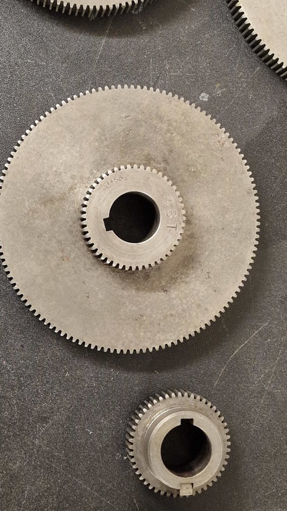

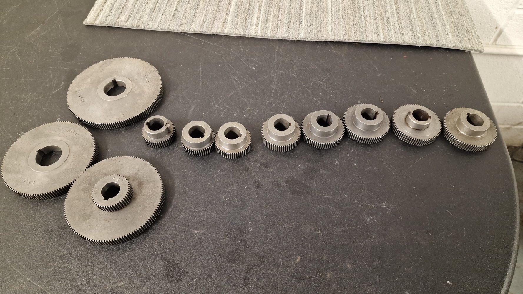

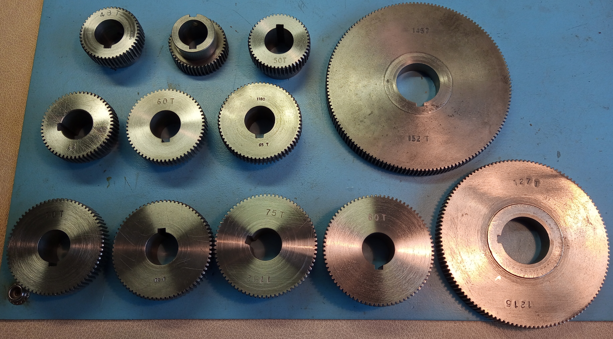

Well that's an interesting assortment. Unfortunately not quite the full standard metric set, but with some duplicates and some extras.3/4" bore:
48-127t
85t
85t
80t
75t
70t
70t
65t
60t
55t
48t
48t
43t
1.12" bore:
152t
152t
127t

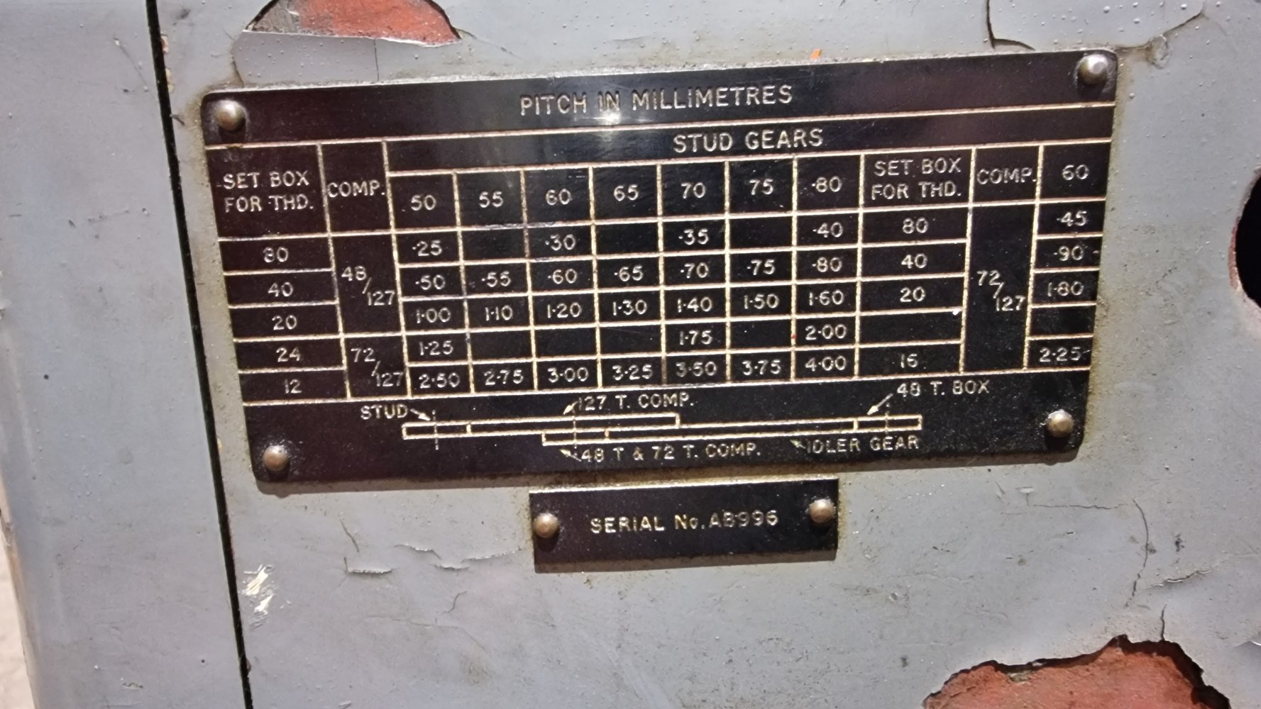

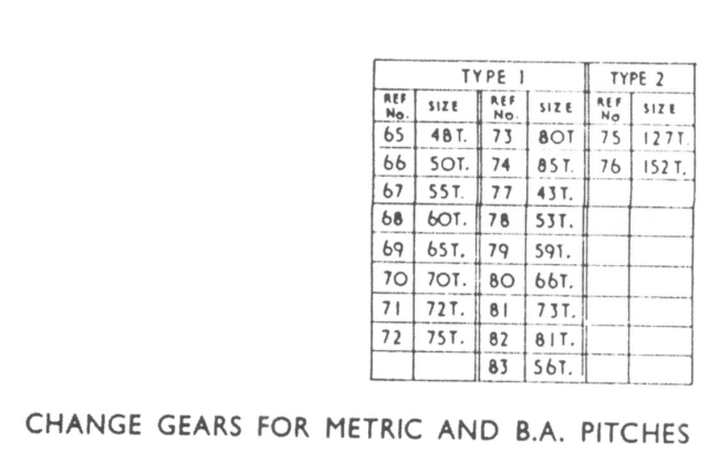

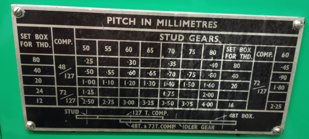

For the metric threads on the plate you're missing: 50T and the 72T with external keyway.
Extras you have: 85 x 2, 43, 152 and the 48+127
The extras: one of the 85T and 43T I'd be interested in.
