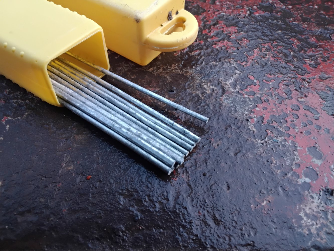

sardine Member Messages 3,749 Location Buckinghamshire Feb 27, 2026 #1 Are these aluminium brazing rods ? Came in SIF box with no label 3mm diameter x 450 long with one flat side

Kram Member Messages 8,925 Location Sussex Feb 27, 2026 #2 See what temp they melt at - a temp controlled furnace would be best slowely inch up until it melts. The good silver rods melt below 650-700c. Or take to a scrappy, who has an xray gun. Or someone with a SEM.. They look a bit corroded to be silver types, also 450mm is short - brazing rods are normally 600mm lengths.

H hotponyshoes Member Messages 8,041 Location Somerset. Uk Feb 27, 2026 #3 The flat side and the 450mm length would suggest aluminium to me. Easy way to check that is to weigh them..

zzr1200 Working at 650 ft on open steel work. Messages 6,831 Location Glapwell, Chesterfield, Derbyshire, UK Feb 28, 2026 #4 Is there not a number etched/stamped in them??? Maybe a gentle with a pad......
