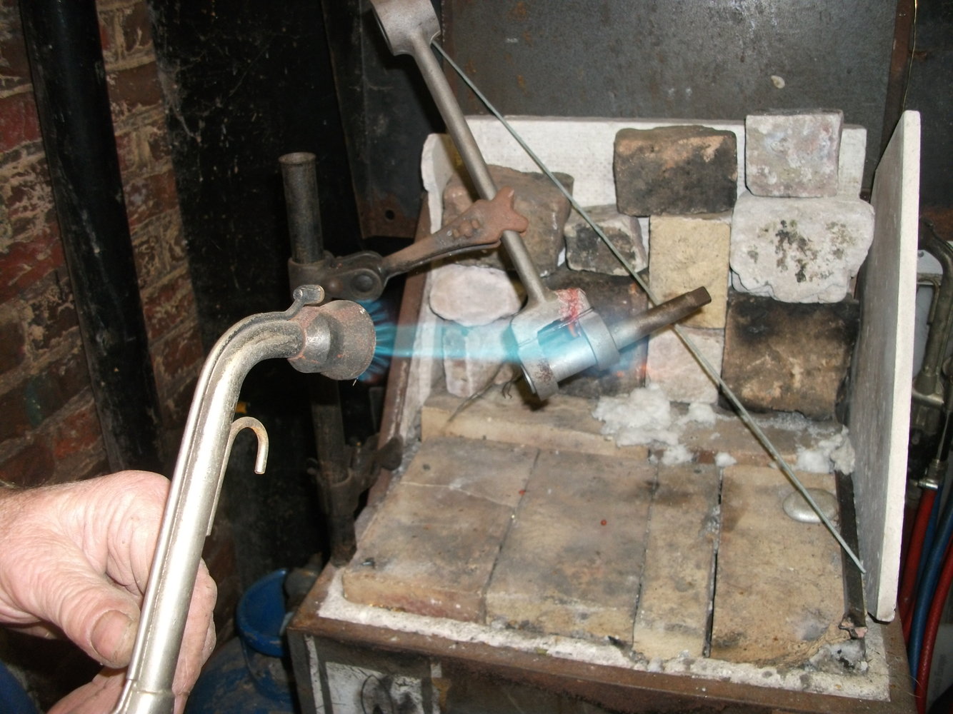

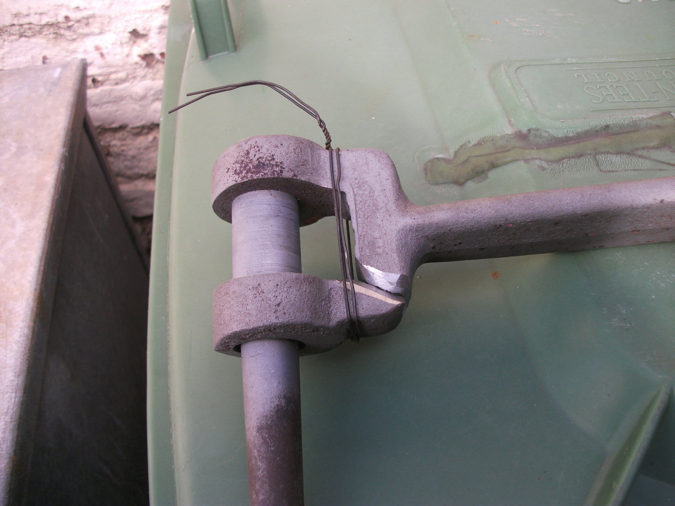

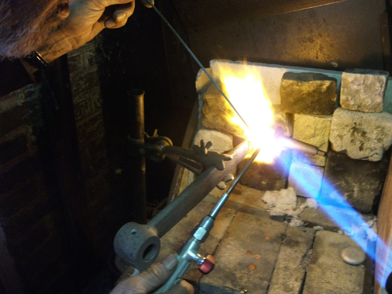

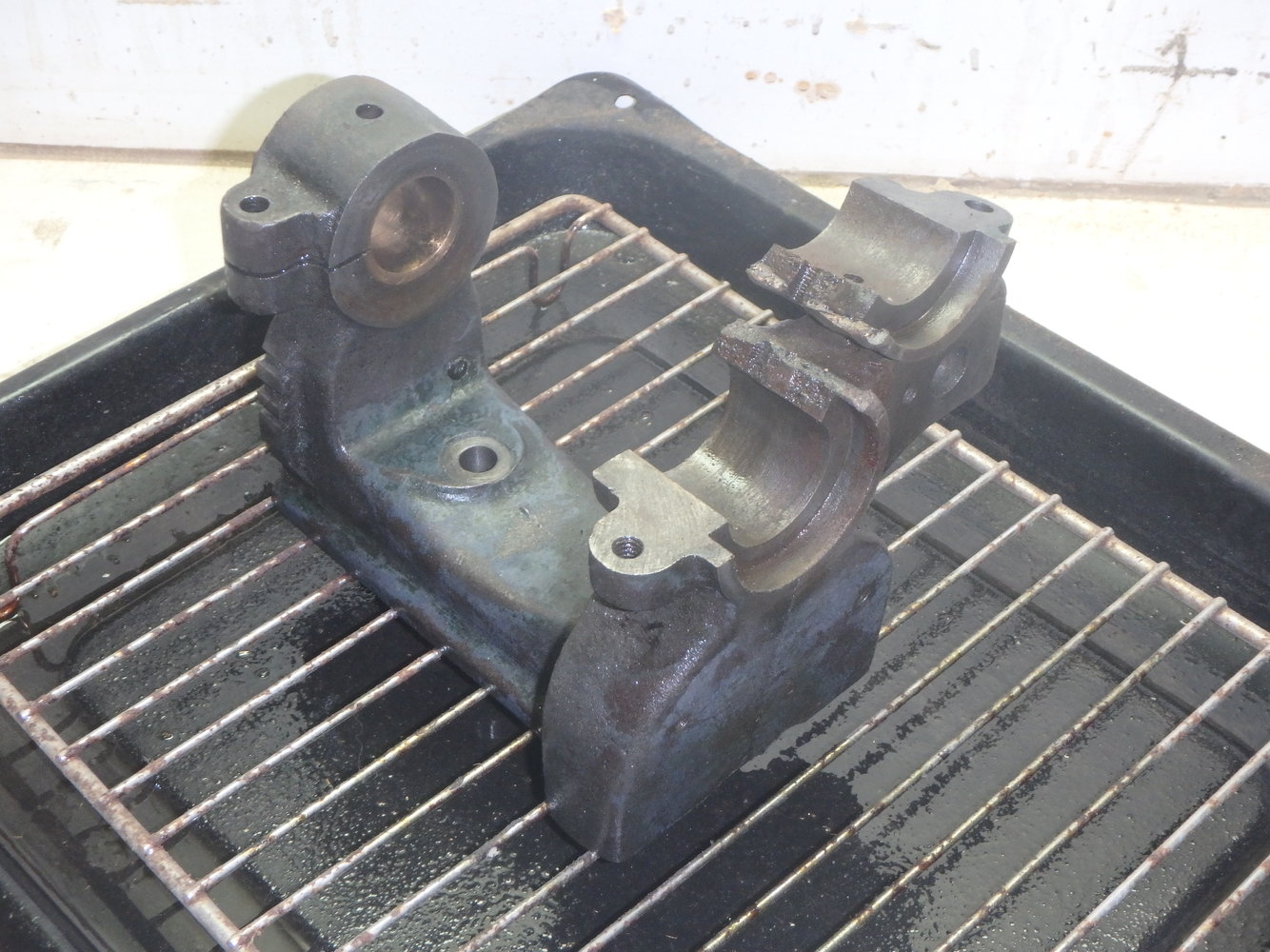

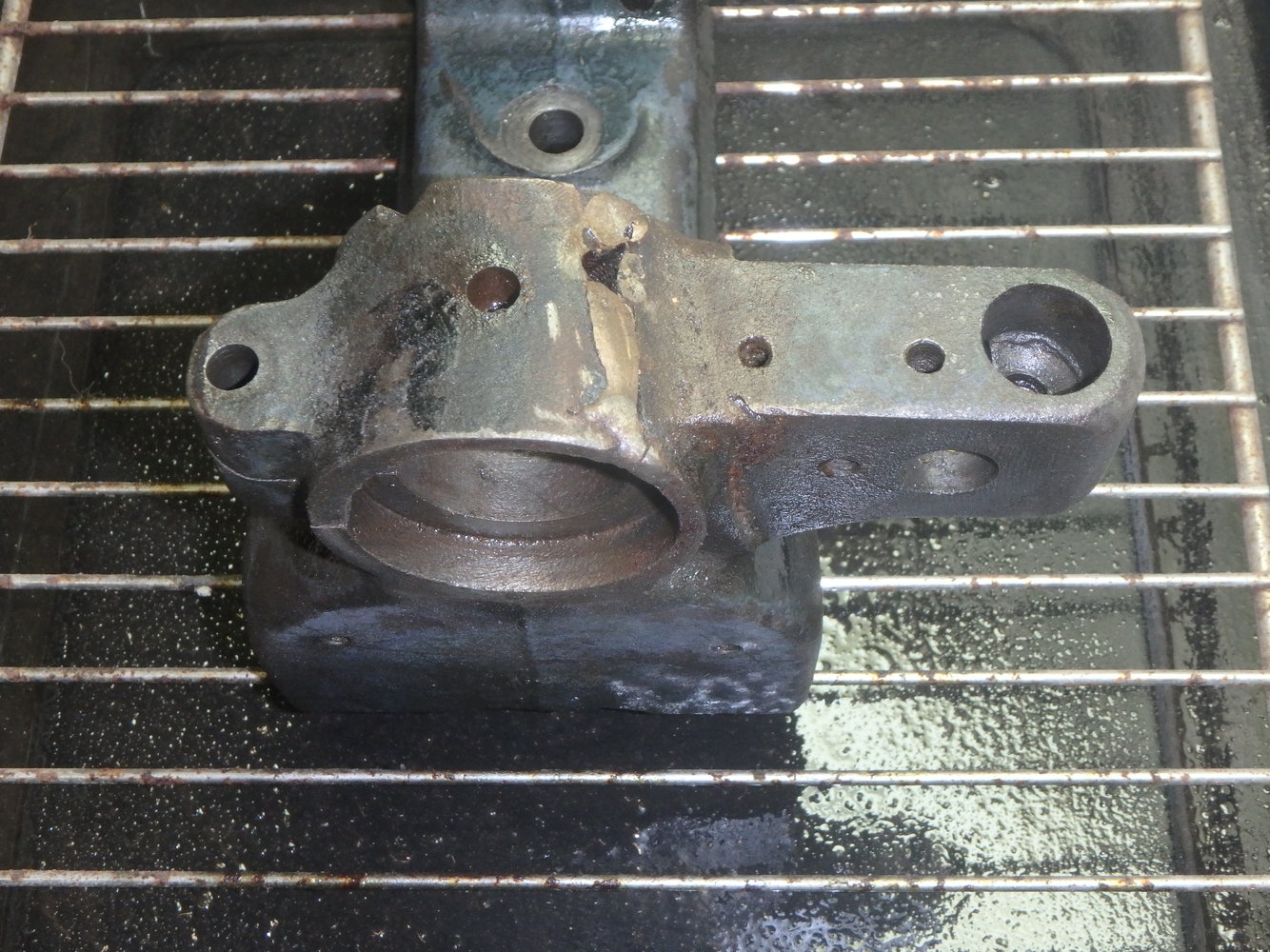

How best to do this? My thoughts are to mill away the top part level with the machined clamp face at the front back to the dimple seen on the second photo and replace it with a suitably machined piece of steel drilled and tapped into the casting. It's been brazed, unsuccessfully, already. Possibly mill it into a mortice shape, the new piece having outside prongs or a U shape fitting over the corresponding milled casting.
Whether it's worth the effort is moot, but I'll learn something while I'm doing it.
